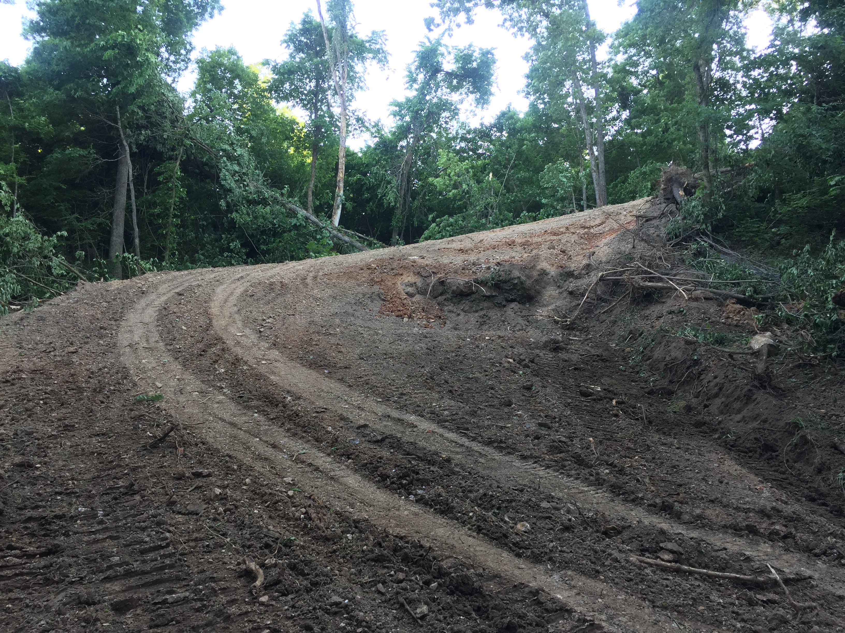

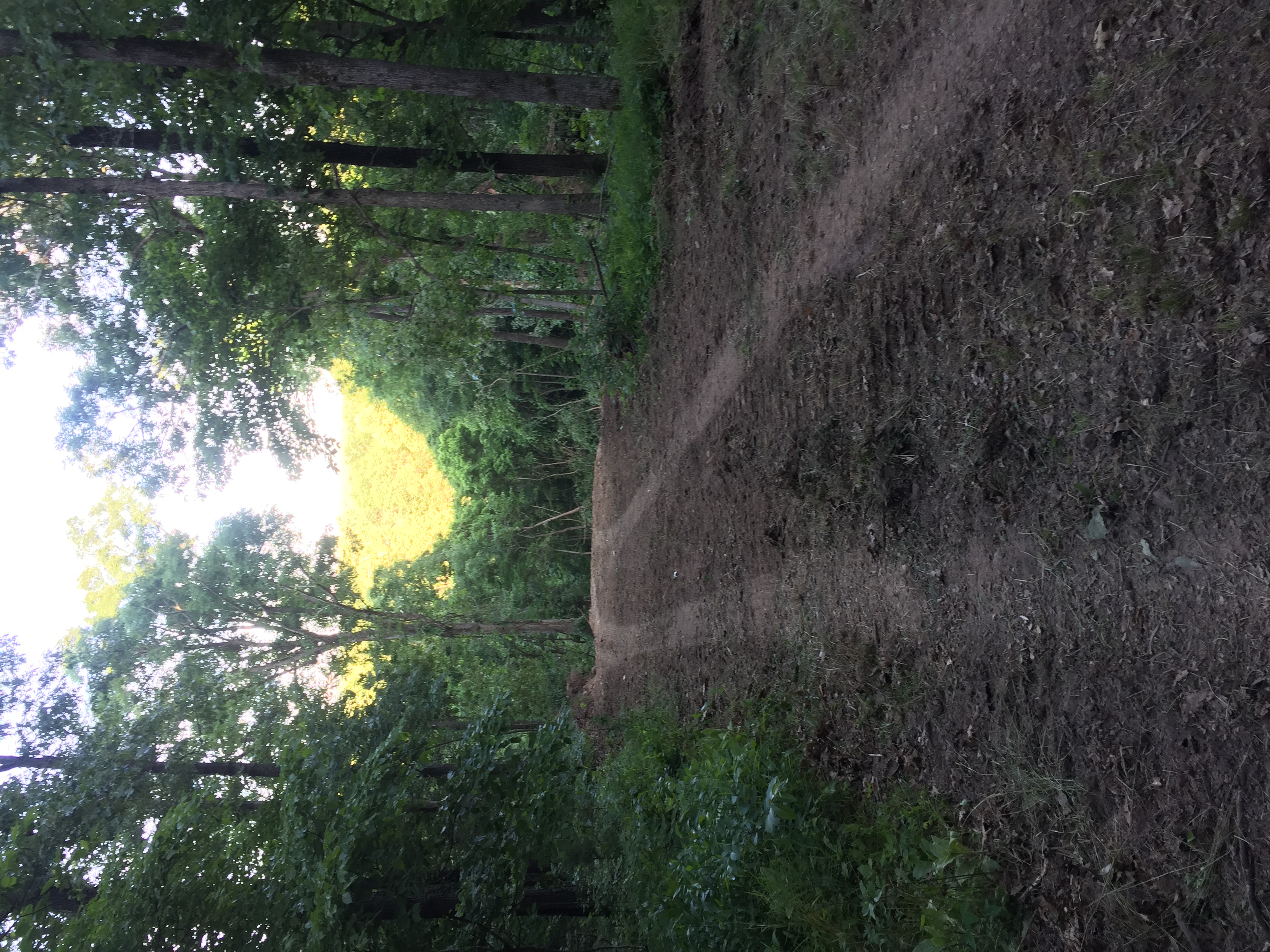

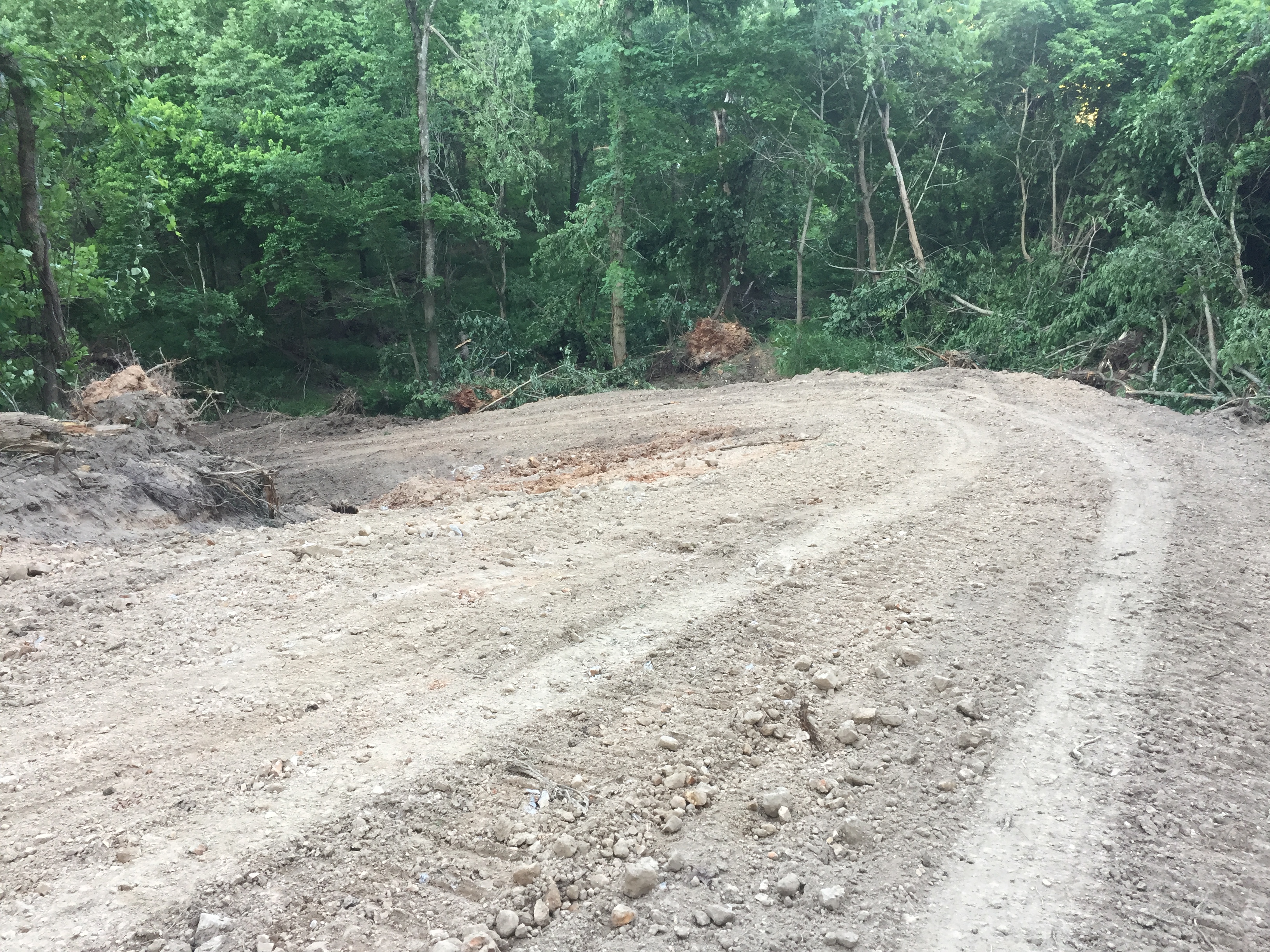

Road is in! I gave up pretty quick on doing it myself. Too steep, and trees in the way. I知 glad I had the loader come down and do it. You can do in a few minutes what I wouldve never been able to do. He wanted to cut the road out of the side of the bank but there was a rock out cropping in the way. I think he did a great job! He did all that in one day! Money well spent.
   / Building a road down to the river #73
Congratulations! Same here, 100+ ft drop to the creek and no way down. Huge dozer/excavator got the road done professionally in one day. Now get the road covered quick before it rains heavy, either gravel or grass. I chose grass as it's way less maintenance, esp on a steep slope.
   / Building a road down to the river #74
Congrats for getting it done, and thanks for the update.
   / Building a road down to the river #76
Looks great. Thanks for the pics!!!
#77
Thanks guys! Luckily the ground was a lot of rock that crushed up nicely and he did a great job of using that topping it off. Its solid and looks like its already graveled. Nice big runoff areas and its crowned so we’re gonna see what happens when it rains to see what it needs.
