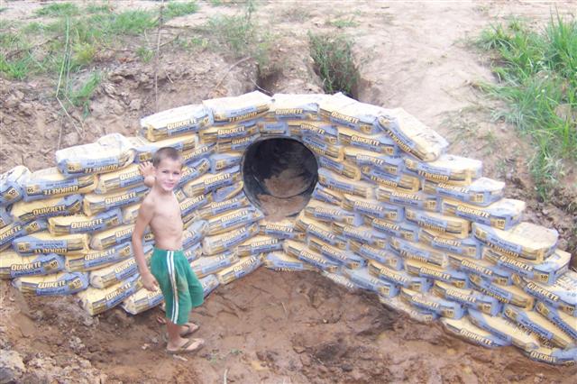

Here's a picture of my 18 inch culvert with the 40 pound concrete sacks of concrete stacked up in front of them. This has handled some very intense, heavy rains, without any sign of erosion.
Eddie

I have an upcoming project where I am planning to build up an existing embankment with the concrete sack method and 1/2" rebar. Question I have is "how well does the concrete adhere to itself with the paper left in place?
Steve
   / BUilding a new road, culvert suggestions? #35
I've never tried to tear one apart, so I couldn't say how well it holds together. I use 3/8 or #3 rebar on the ones I've done. My theory is that when you push the rebar through the sacks, it tears the paper and mixes the concrete from the two sacks together to some degree. I like to drive the rebar through all the sacks, and at odd angles to interlock it together as much as possible. Then when the concrete sets, the rebar is locked in there solid and there's no way that it can go anywhere. The paper and plastic lining in the paper disapears after a few years where exposed, but between the sacks, it might be there forever. Another part of my theory is that the sacks form a bond to each other when they dry due to the shape they create when stacked on each other.
I like the 40 pounds sacks because they are easy to handle. The larger sacks are wider, which isn't needed. The length and thickness of the sack is all that matters, not so much how wide they are. So my thought is to buy the easy to handle sacks that are just at thick as the heavier sacks without spending the extra money. One time, for whatever reason, Lowes had a sale on 50 pound sacks that were less mone thn the 40 pound sacks. I went with the cheaper, larger sacks then, but that's the only time I've used larger sacks of concrete to do this.
The rebar goes through the sacks really easy. You barely need to tap them with a hammer. The hard part is cutting the rebar. I make them about a foot longer then the section that I'm going through. I don't know if this is a good idea or not, but it seems to work.
Eddie

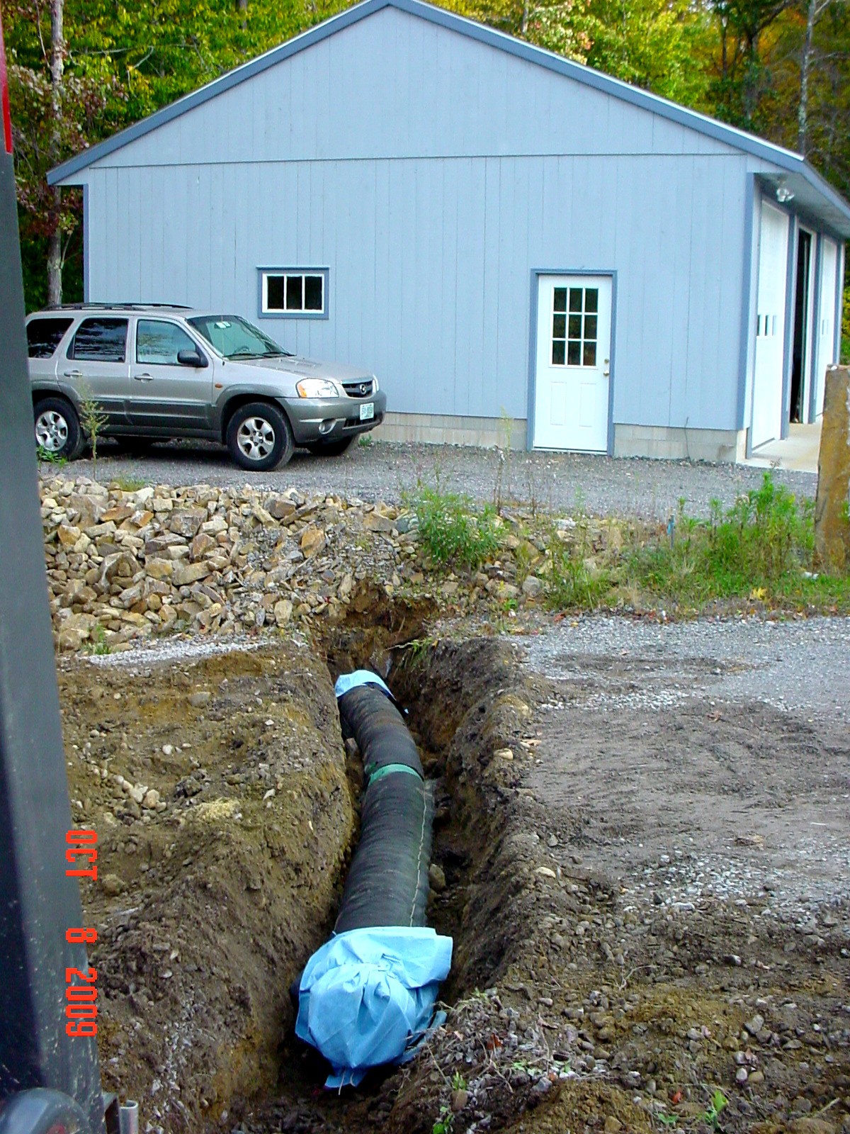

Left over Septic Pipe
   / BUilding a new road, culvert suggestions? #38
That looks like what we call SB2 for leech lines. It might work for a driveway for cars or light vehicles but it is not very thick and is only single layer. Regular plastic culvert has thicker outer ribs and also a smooth inner liner to help water flow and has a lot more strength to prevent crushing. If you put it deep enough and backfilled with some good crush/run so it would pack evenly around it and get a good cover it might hold up but I'd be worried about having anything heavy run over it. Anything heaver than my skidloader with tracks or grading tractor will crush it easily when I grade in the yard when done.
Just my 2 cents on using that but I hope it works for ya.
