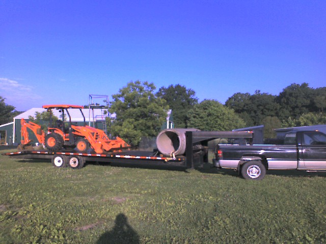

Try your local precast plant, they have lots of pipe that don't meet state spec's but they work fine for use on private property and are very cheap. I got this one for $200, but they are very heavy this one was like 4,600 lbs. And you should compact the soil under the pipe(remove sand and replace with clay if you can) and around the pipe as you are back filling when you do this it will be a real pain but will keep you from having to do it twice.

If you are in remote bush without really heavy equipment, spend the money on plastic culverts and be done with it. Concrete,metal and "frugal fixes" will result in a "do-over" in short order (like first spring thaw). Don't ask me how I know this to be true:eek:
