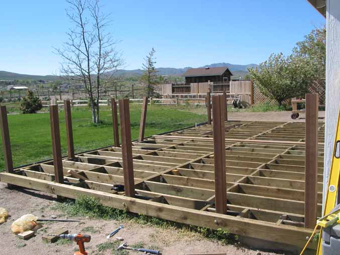

So this post has been a long time coming. Too many computer & work issues to discuss. NoTresspassing - it is a border collie, but not a pure bread. He is a great dog none the less. As far as the decking material goes we are using Trex Accents. It has a faux wood grain stamped into it and is saddle in color.
After getting all of the framing done it was time to temporarily set the posts. I had to add a little more framing for stability and used 2 7" carriage bolts to secure each of the posts.
