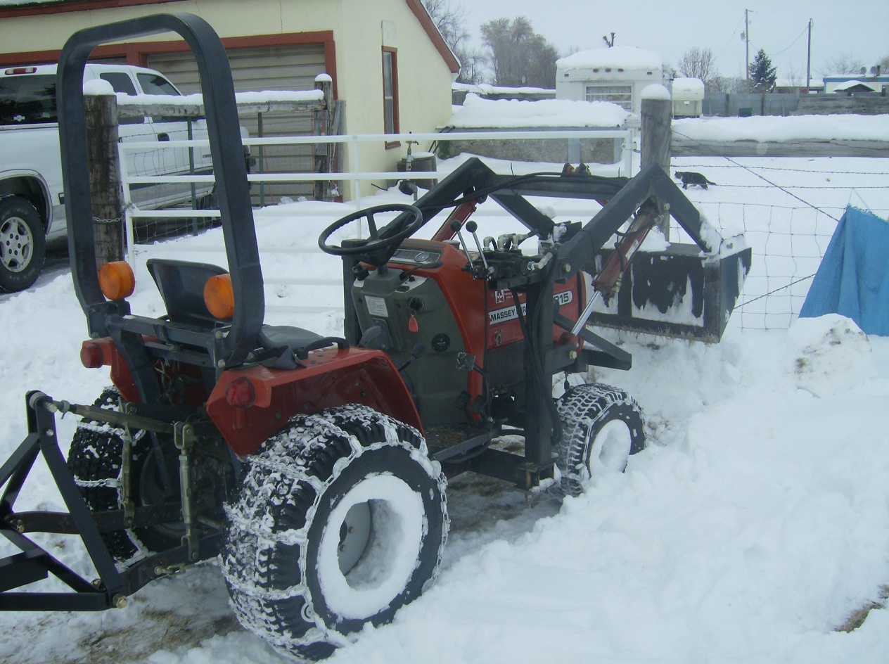

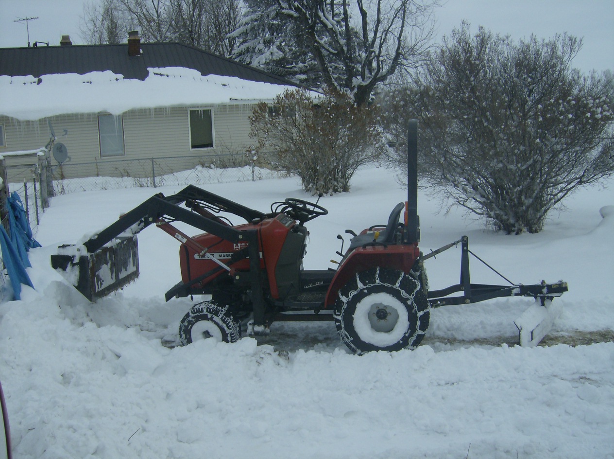

I'm done for now. I cheated a bit. Rather than remove the subframe to finish weld the whole thing, I just welded the surfaces I could do well as is. I'll have to take it off in the spring when it's warm enough to paint it. I'll finish the welding then.
I moved a bunch of snow today with it. The loader is almost as valuable for the added weight as it is for it's functionality. I could push a whole lot more snow just with the back blade than I could push before I put the loader on.
It's still slower than I'd like it to be. I may add a hydraulic pump someday that is driven off the mid-PTO. For now, though, I'm excited just to have a loader again.

It's looking good dude . Looks like it belongs there. What's next on your big projects ? :D
