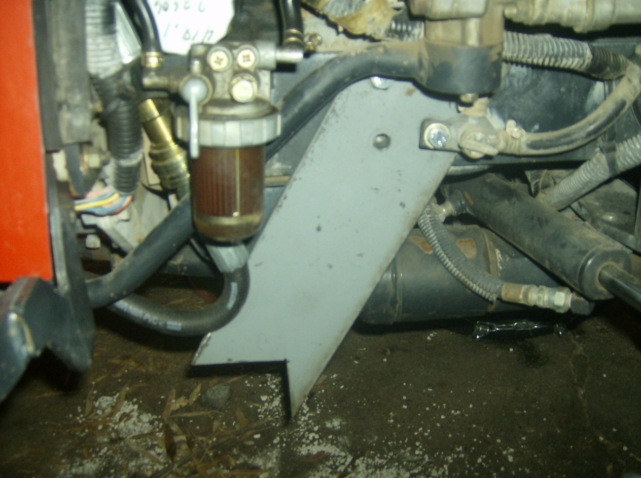

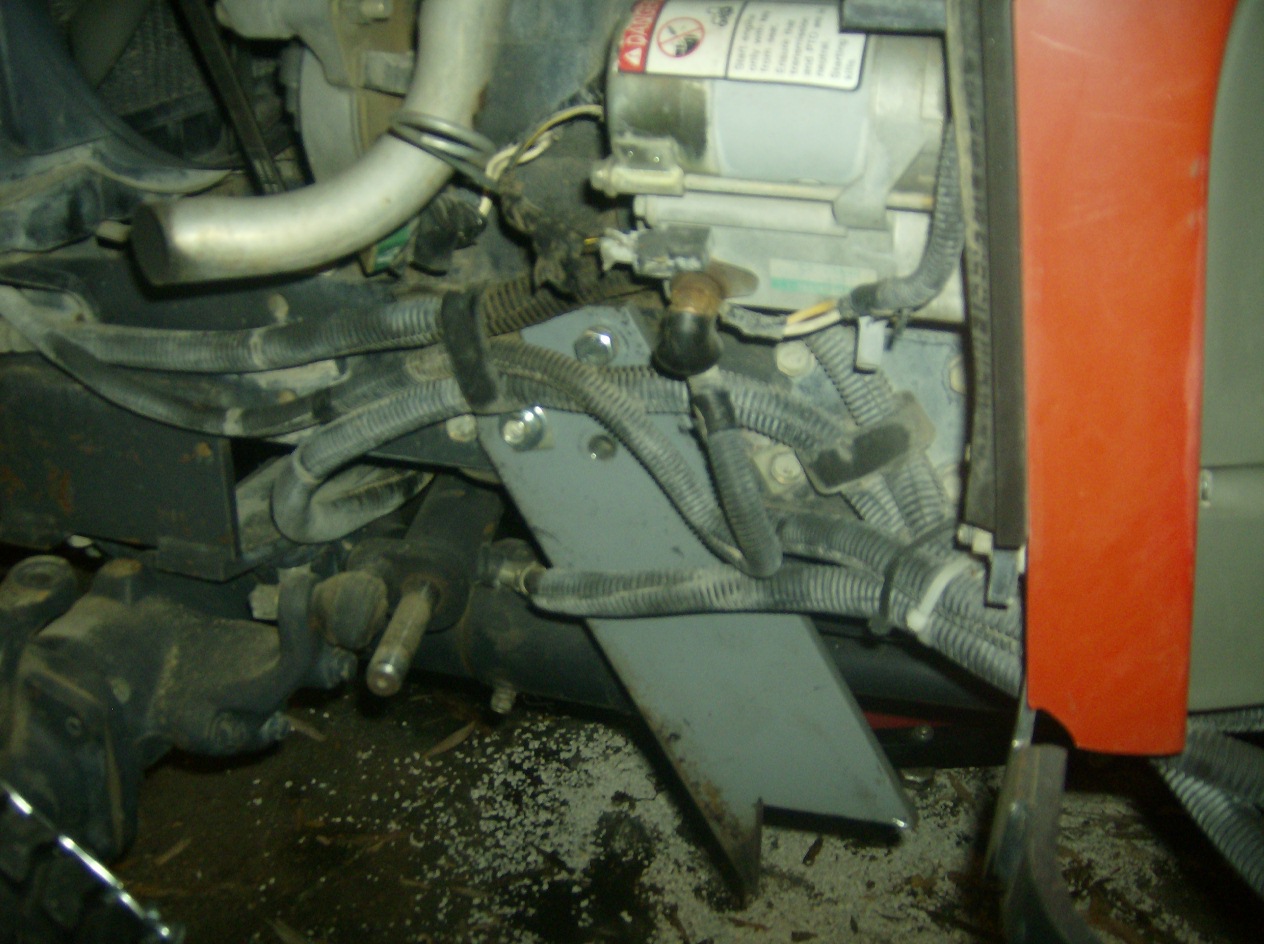

#24
I cut and drilled the front mounting brackets for the subframe. You'd think I'd be able to post more progress than that for a whole Saturday, but life happens. Besides, cutting 1/2" steel with an angle grinder is not exactly quick.
I've included pics of the left and right mounting brackets. In the first picture (the right bracket) you can see the new hose to the left of the bracket under the fuel filter.
I actually spend about 2 hours yesterday helping a neighboor dig out of the snow. I was running the 3 pt. up and down constantly the whole time since I was using a back blade. Everything ran great. That tells me that the hose is working okay.

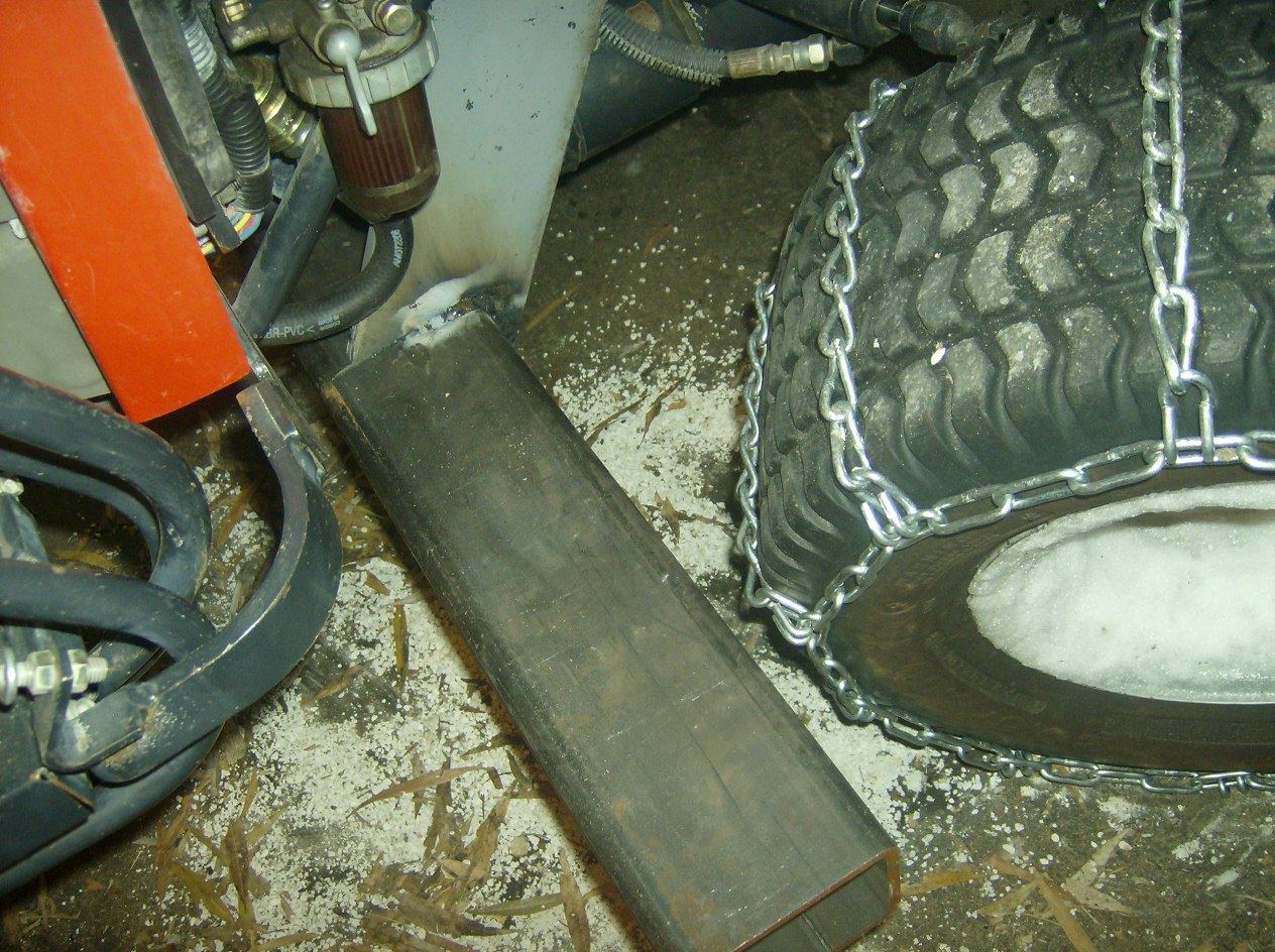

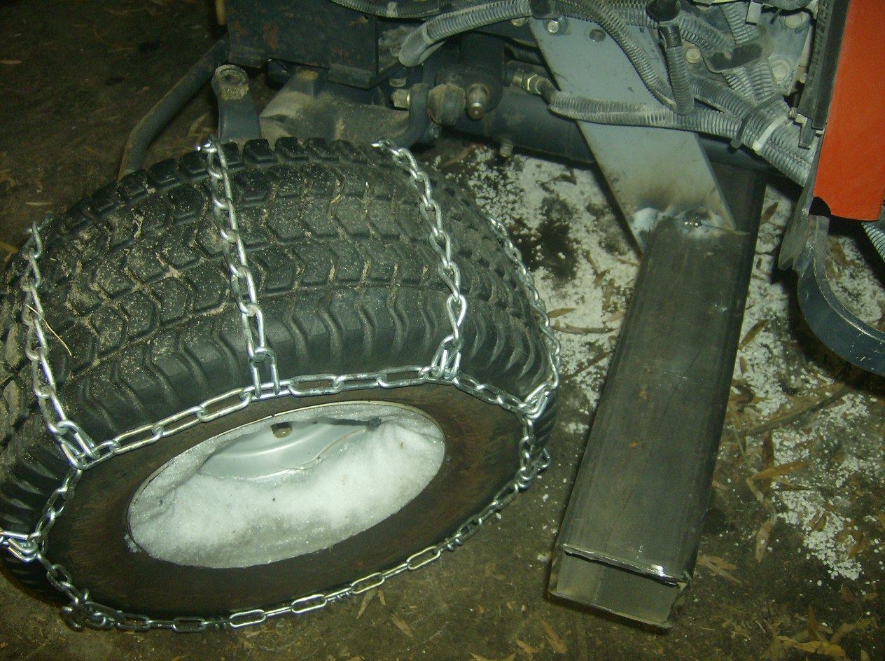

   / Building a Loader for a MF1215
#25
I cut out the main cross member of the subframe that will hold the loader uprights, and tacked it in place. It's pure luck that the front wheels clear it. I didn't even think to take that into account. As it is, though, there's enough clearance to be comfortable with it.
In the pictures you can see the clearance at its nearest point. You can also see where I've tacked the beam in place.
In addition I've jacked up the rear end and taken off one of the wheels so that I can get to the ROPS mounting bolts. I'm going to mount the back of the subframe into these bolt holes.

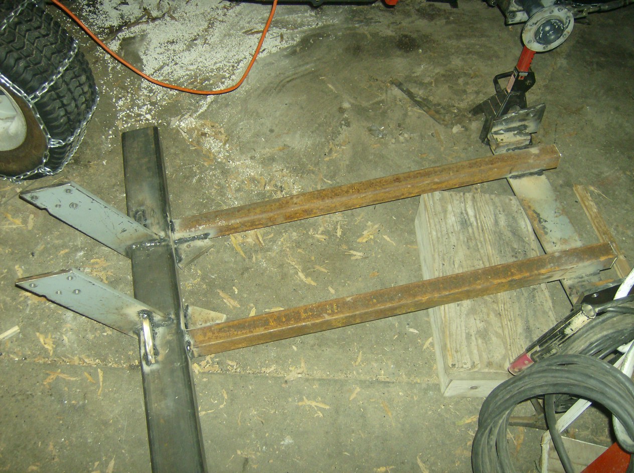

#26
I got the subframe put together. I am amazed that I was able to negotiate all of the pipes, pedals, and levers under the tractor with a straight tube. I thought for sure I'd have to Jerrymander around. Don't mind the mis-matched rust patterns. I used what I had handy. The only piece that I had to buy was the main tube going accross at the front.
