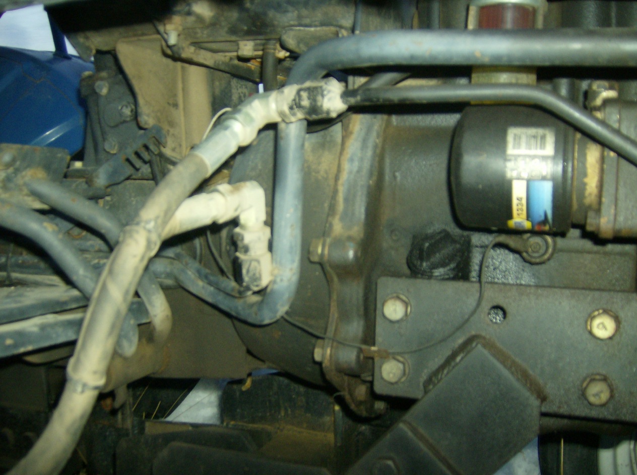

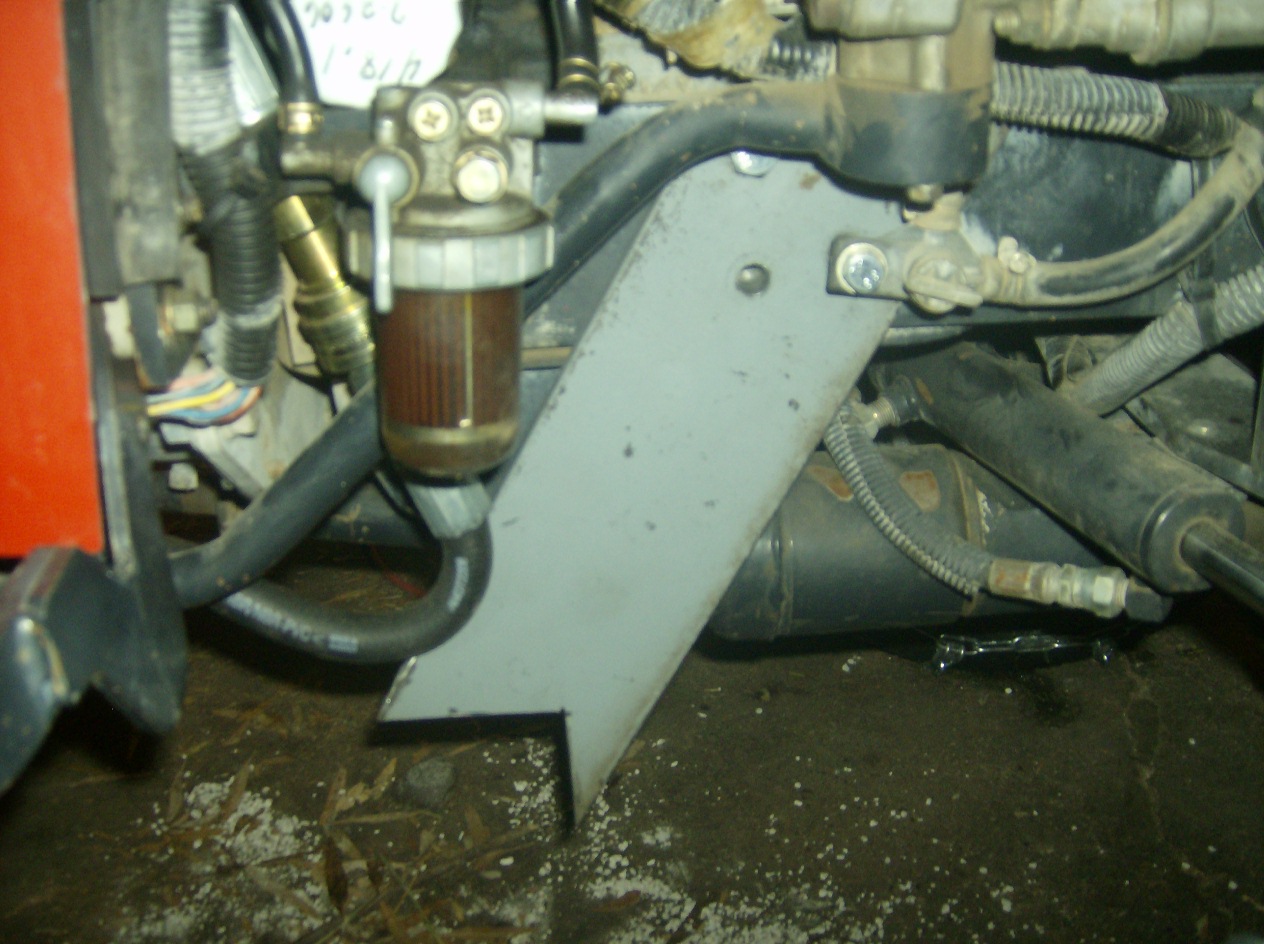

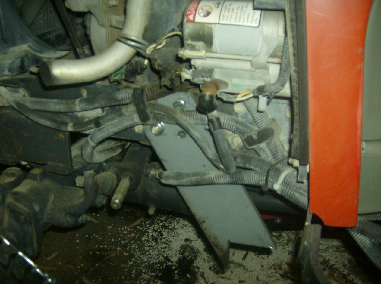

I cut and drilled the front mounting brackets for the subframe. You'd think I'd be able to post more progress than that for a whole Saturday, but life happens. Besides, cutting 1/2" steel with an angle grinder is not exactly quick.
I've included pics of the left and right mounting brackets. In the first picture (the right bracket) you can see the new hose to the left of the bracket under the fuel filter.
I actually spend about 2 hours yesterday helping a neighboor dig out of the snow. I was running the 3 pt. up and down constantly the whole time since I was using a back blade. Everything ran great. That tells me that the hose is working okay.

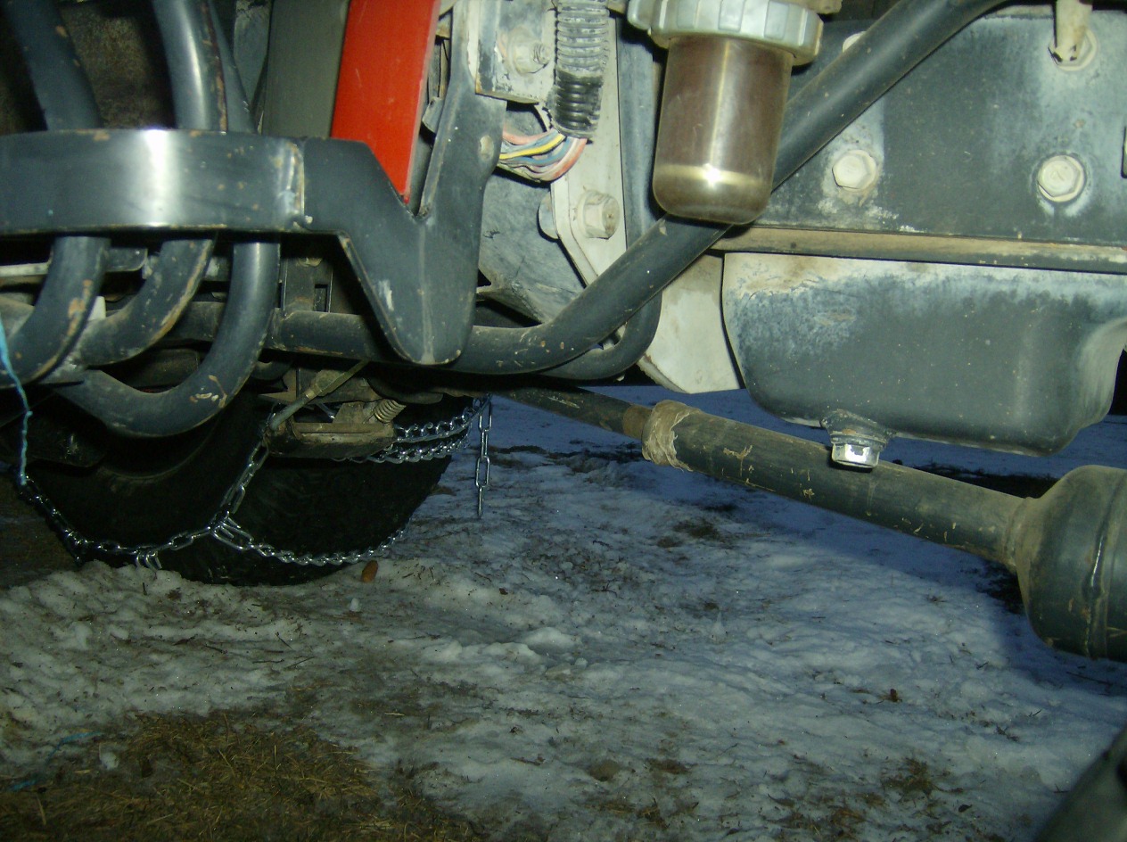

I cut out the main cross member of the subframe that will hold the loader uprights, and tacked it in place. It's pure luck that the front wheels clear it. I didn't even think to take that into account. As it is, though, there's enough clearance to be comfortable with it.
In the pictures you can see the clearance at its nearest point. You can also see where I've tacked the beam in place.
In addition I've jacked up the rear end and taken off one of the wheels so that I can get to the ROPS mounting bolts. I'm going to mount the back of the subframe into these bolt holes.

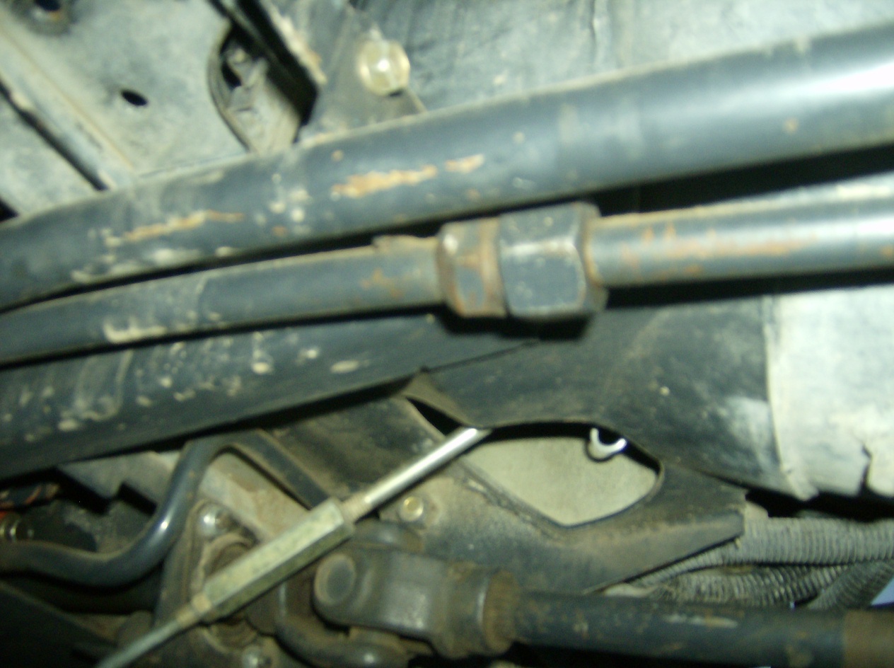

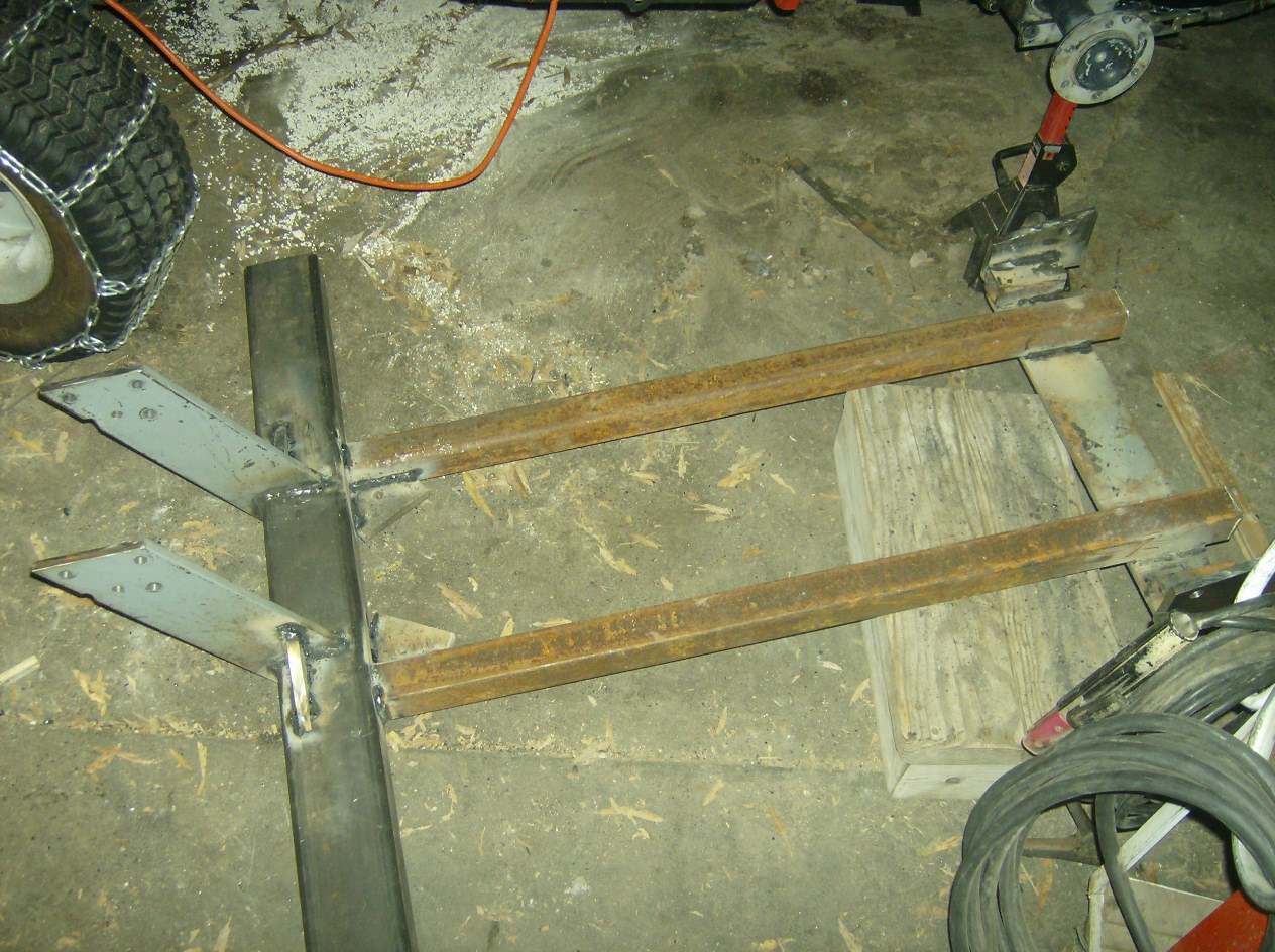

I got the subframe put together. I am amazed that I was able to negotiate all of the pipes, pedals, and levers under the tractor with a straight tube. I thought for sure I'd have to Jerrymander around. Don't mind the mis-matched rust patterns. I used what I had handy. The only piece that I had to buy was the main tube going accross at the front.

I have the loader put in place on the tractor now, but I don't have it bolted down. I had an issue with the bolt pattern to connect the loader to the subframe. The original subframe on the old tractor was made out of 3" square tubing, and this new one is 3" X 4". I measured the holes in the loader uprights, and I had plenty of clearance. But, I forgot to account for space for the nuts.
I think I have the problem solved, now. I bought some longer bolts to go the whole depth of the subframe such that the nut will actually be beneath the subframe. This has the added advantage of putting the stress on the system in such a way that the weak link is not my amateur welding skills.

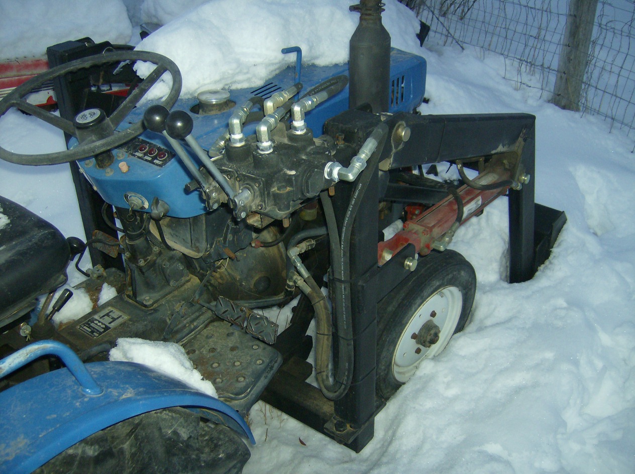

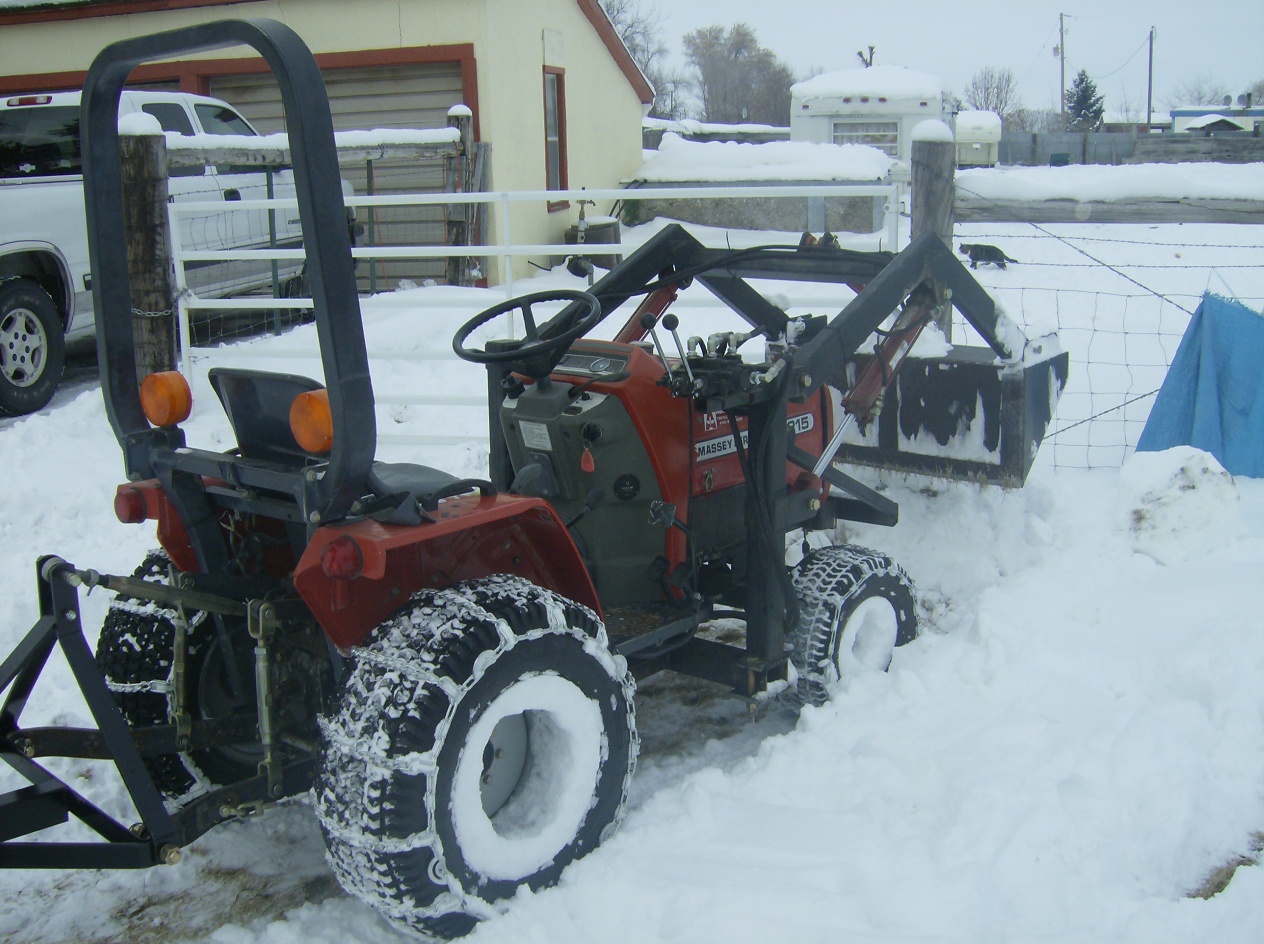

I'm done for now. I cheated a bit. Rather than remove the subframe to finish weld the whole thing, I just welded the surfaces I could do well as is. I'll have to take it off in the spring when it's warm enough to paint it. I'll finish the welding then.
I moved a bunch of snow today with it. The loader is almost as valuable for the added weight as it is for it's functionality. I could push a whole lot more snow just with the back blade than I could push before I put the loader on.
It's still slower than I'd like it to be. I may add a hydraulic pump someday that is driven off the mid-PTO. For now, though, I'm excited just to have a loader again.
