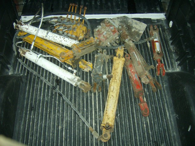

Well, I'm sure some of you saw this one coming. I am too much of a cheapskate to fork out twice what I paid for the tractor to put a loader on it. I've got a big head now from my experience building a hydraulic dump trailer, and now I'm going to build a front end loader for my Massey Ferguson 1215. If all goes well, I'll build a backhoe for it too.
Everyone was so helpful throughout the dump trailer build, and I just had to start this project out by posting here on TBN. I owe MossRoad big for his excellent example of how to post a project. Anyone who hasn't read his backhoe build should dedicate and afternoon to it. It's really pretty good.
I'm just in the planning stage and the accumulating junk stage. I've promised my wife that I will do a few projects around the house before I start work on the loader, but in the mean time I can plan, dream, and keep my eyes out for deals on materials.
There's a tractor and farm machinery wrecking yard about 20 miles away, and the guy that runs the place owes a few favors to a close friend of mine. I took said friend with me on Monday and picked up all the hydraulics that I'd need for both a backhoe and a front end loader.
I got the 5 spool valve and the 3 spool valve in the attached picture plus the 10 rams of various lengths and diameters all for $350. All are guaranteed to work.

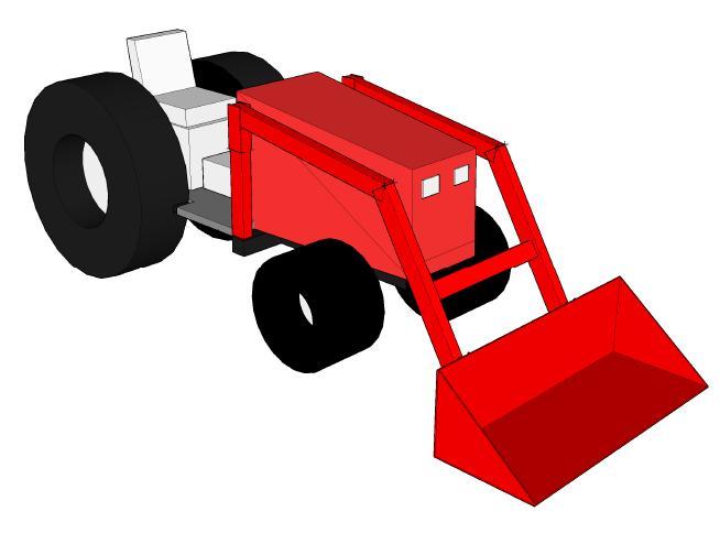

I've been using google sketchup to do some initial modeling and figuring. (Thanks hazmat for recommending it to me clear back in September.) The second picture is a shot from sketchup of the loader as it is designed so far. I still plan on considering a load leveling system, and I've got the third spool on the valve to keep my options open for a grapple or something like it.
I'm just introducing the project right now. Be patient with me and I will post back with plenty of pictures, stories, lessons learned, and I'm sure lots of questions.

Nice start. I made one for my MTD 990 tractor. I made my bucket a quick disconnect type. Here is a sketch of the design and the actual brackets made from a cut down angle welded together. The main support tubing was 3.5" Square instead of 4". Here is my 3d drawing of the assembly. The finished loader. If you need any other information let me know. My cylinders are all 2" dia. and 16" stroke.
/ Building a Loader for a MF1215
Wow! You've got my plans beat by a mile. I love the detail.
What file type are these? I may want to pirate them.
/ Building a Loader for a MF1215 #4
Looks like solidworks, AutoCad Inventor, or solidedge (surely not Pro/E??)
Nice models btw. Very nice loader!
/ Building a Loader for a MF1215 #5
I used AutoCad Inventor Pro. I'm a retired mechanical designer. Now I design things for myself.

Here's my first question to the group regarding this project...
How should I clean out used hydraulic cylinders and valves? I got these used hydraulic parts for dirt cheap, and I want to make sure the cheap dirt doesn't end up in my tractor's hydraulic system.
I have a parts washer with stoddard solvent in it. Is it a good idea to use the stoddard solvent? Should I rig some system to run hydraulic fluid through all of these parts to flush them out before mounting anything to the tractor?
Any and all advice and input is appreciated.
/ Building a Loader for a MF1215 #7
Here's how i do it, after cutting and rewelding a hydraulic cylinder to desired length:
I put a bucket half full of diesel, stick the cylinder into it with the oil port submerged, then yank the piston rod in and out untill the diesel starts to foam...
The opening on the top end near the piston rod ?? hmm.... never tried that end. Maybe you have a short piece of hydraulic hose to put into the bucket of diesel, as a suction line.
Funny coincidence... I just found a can of Diesel?/Kerosene? in the corner of the garage this weekend as I was cleaning up. That would be a great use for it.
After the diesel, do I need to get hyd. fluid into in pretty soon, or will the diesel lube and protect enough until I get the whole system put together?

Nice model. I spotted the green/red/blue axis icon in the bottom left corner of your model so I knew it was inventor. I'm a mechanical designer with only 27 years til retirement:D I design lots of my own stuff...but don't have the time or money build any of it!

Thats why i allways use diesel: it doesnt bite anything else, and doesnt rust quite easily. And its easier to flush than thick oil.
When storing it for longer than a week, a squirt of oil after flushing them out, might be better than just diesel though...
