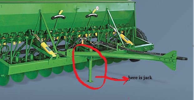

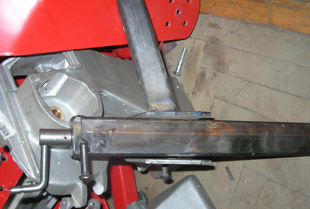

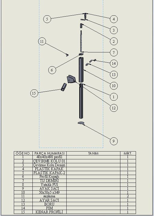

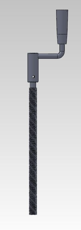

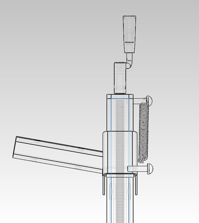

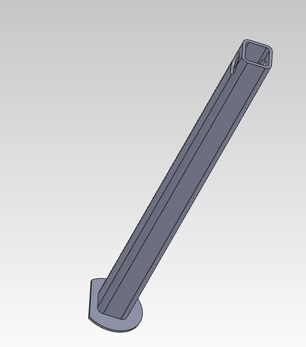

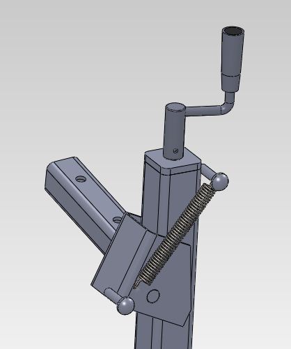

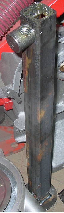

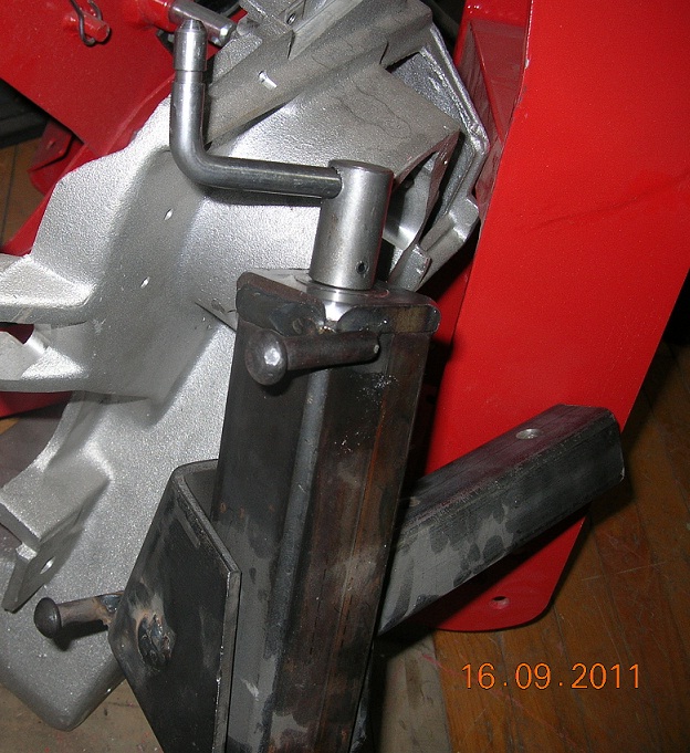

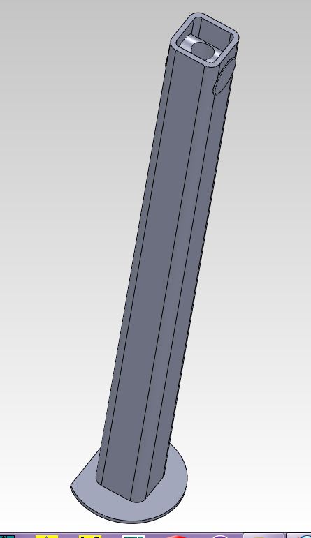

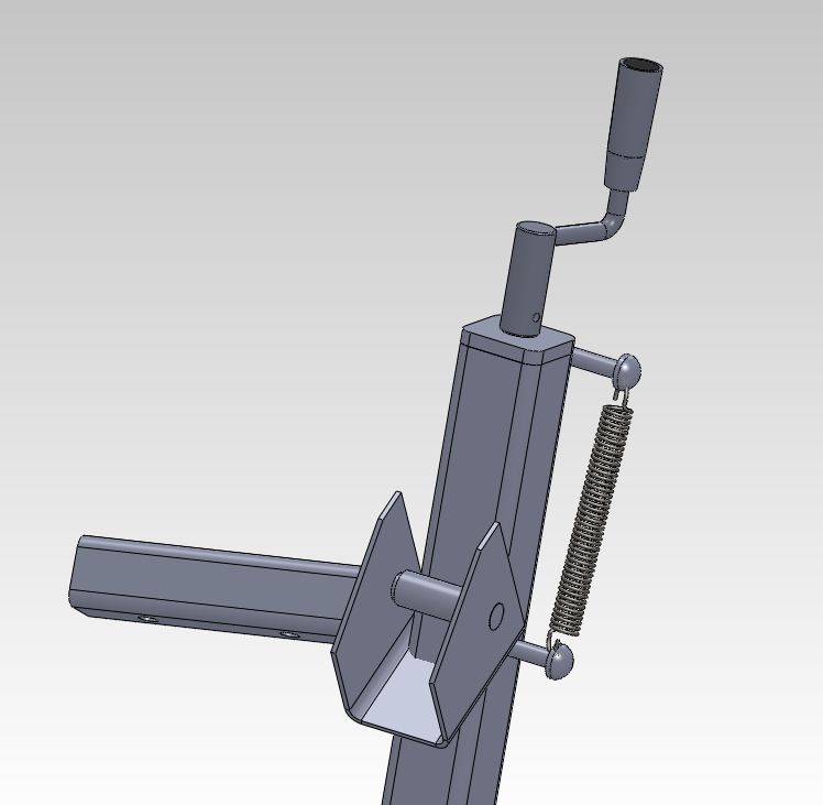

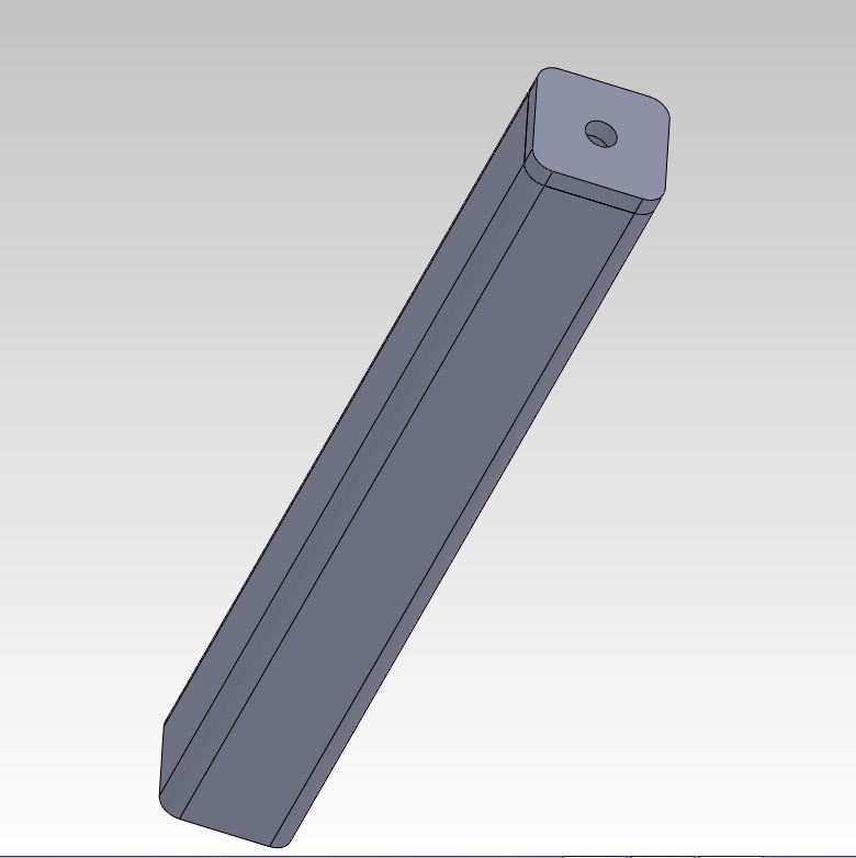

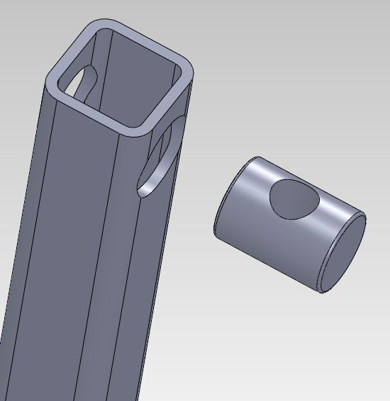

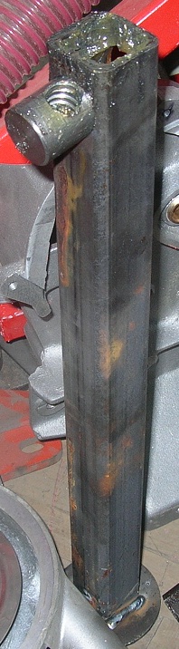

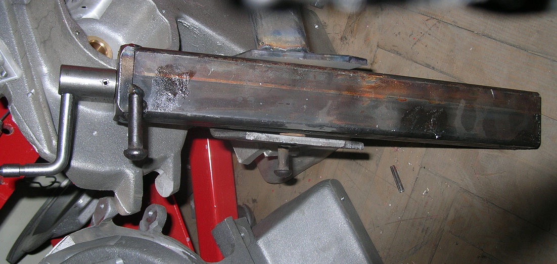

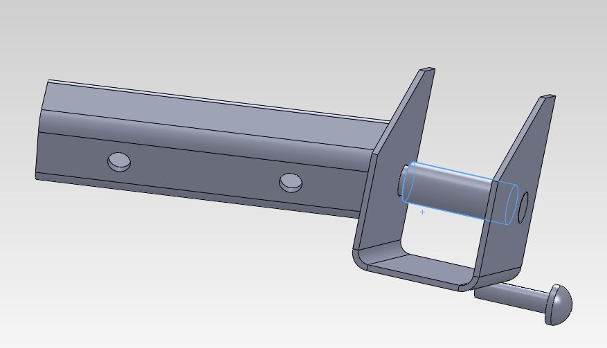

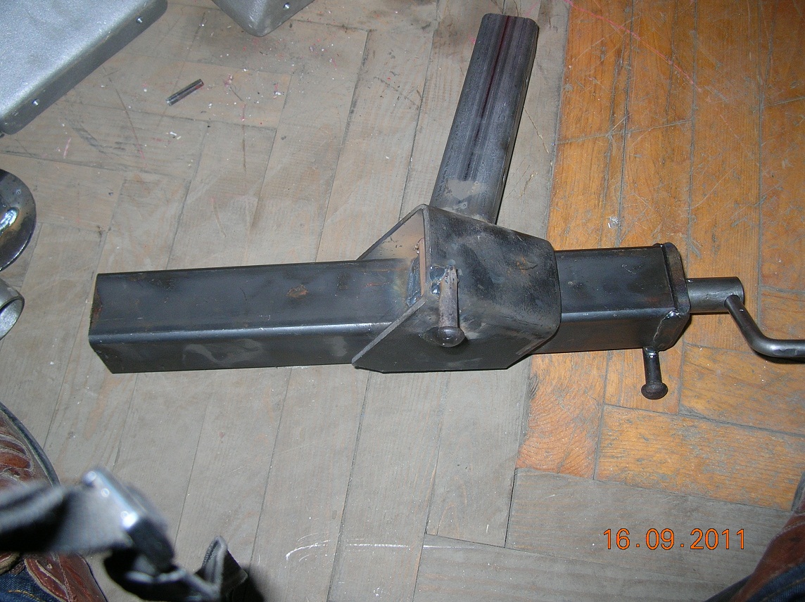

Here is ı can tell about that how can build a jack.My english is not very well but ı can try to help everyone to make this apparatus.Thanks.

Great job! Painted it looks just like it came that way!

Nice build, and nice sketches. It's cool to see the end product actually look like the sketch.
