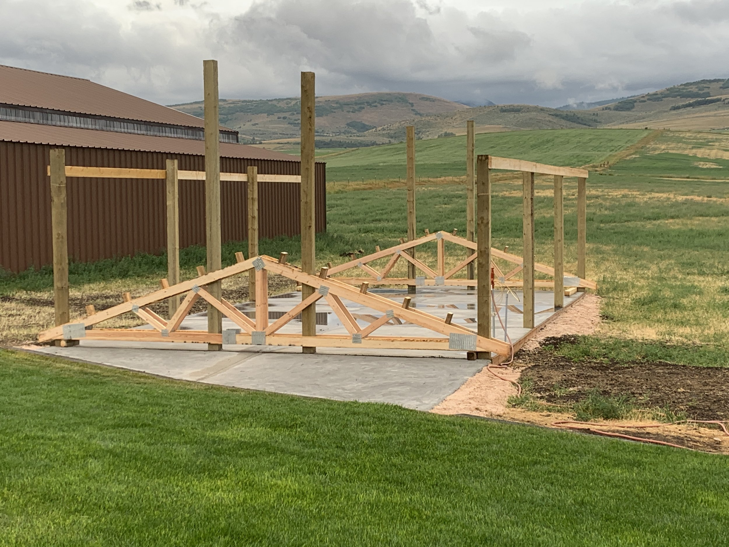

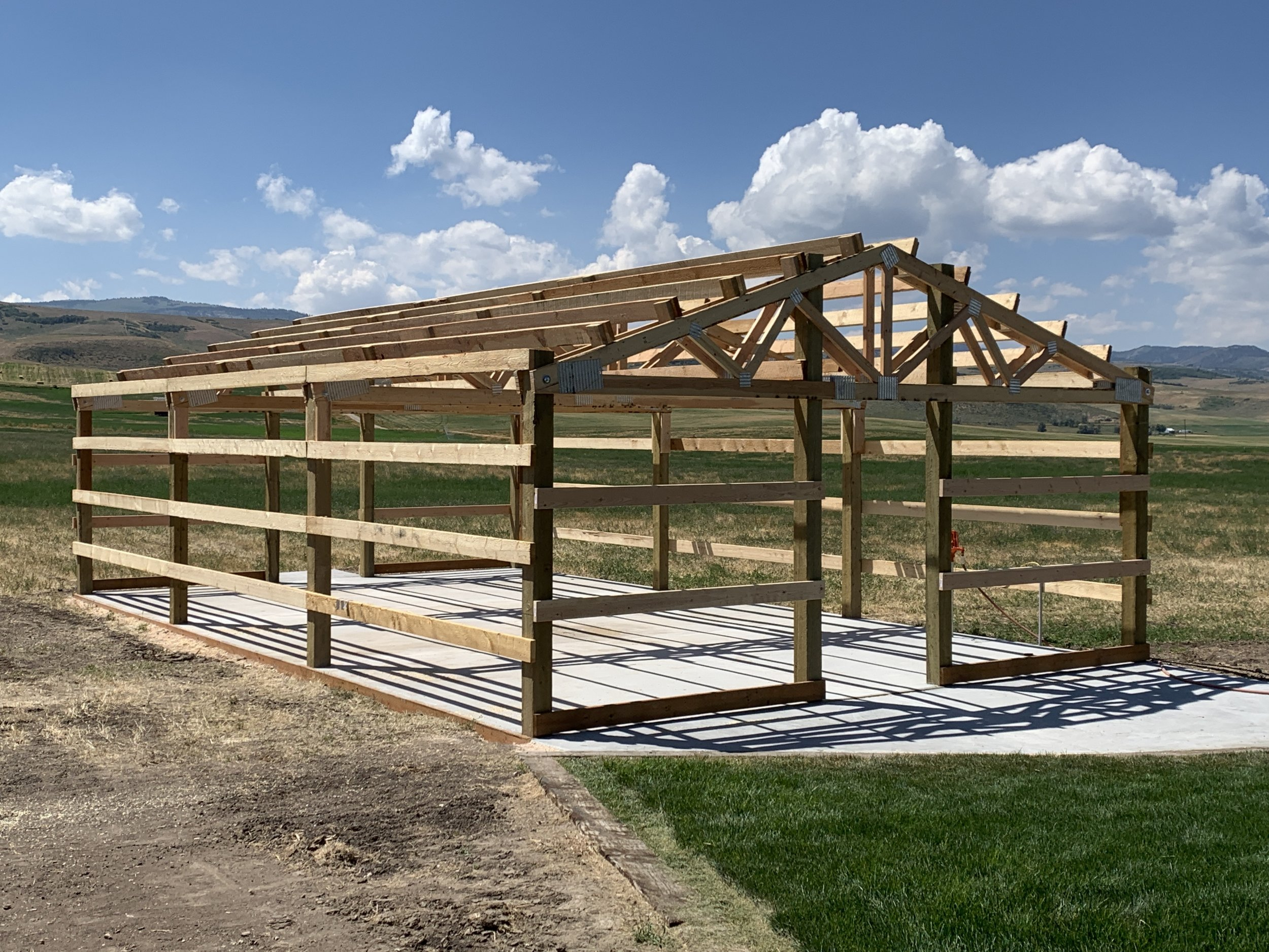

/ Building a Green House. #23

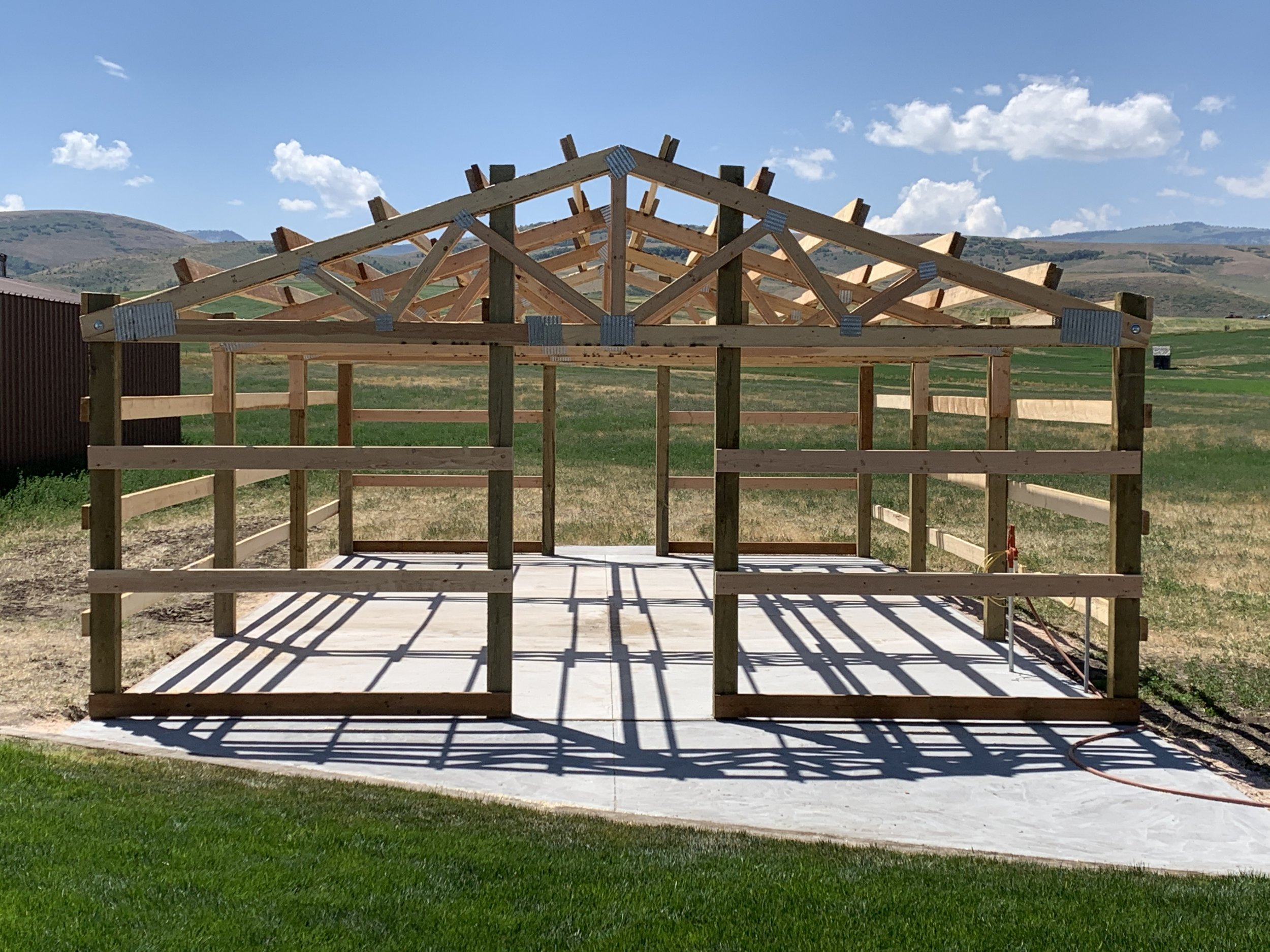

Framing done, waiting for metal and translucent panels.
View attachment 756902View attachment 756903
Some folks here built one. I guess they had a plan from up north. That thing has a 12/12 pitch on it. Even yours looks like a 4/12 pitch. Much easier to deal with. They never skinned it after the first time. Just framing now. They should put metal and a few scattered pieces of fiberglass sheathing on the roof to make it usable. Around here you can grow till November. We always plant corn on valentine's day. Some things will grow all winter if it doesn't snow my mother has a green house area and it's nice to have plants already started before setting out. Now we have major problemo with coons. Took dad 5 big live traps for them. Can't use foot hold traps because of kids and dogs, we love both. Dad's just hauling them 20 miles away and letting them go. We did grow over 6000 watermelon, but it won't happen this year. I'm talking a pack of fur bandits with black masks have hit us on the regular. Fig trees stripped. Peach trees no peaches. Fat coons everywhere. Them live traps and sardines are rectifying the situation.

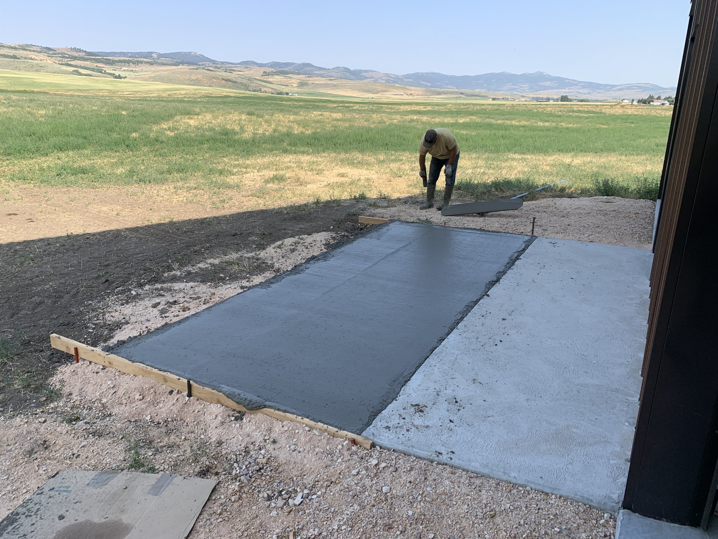

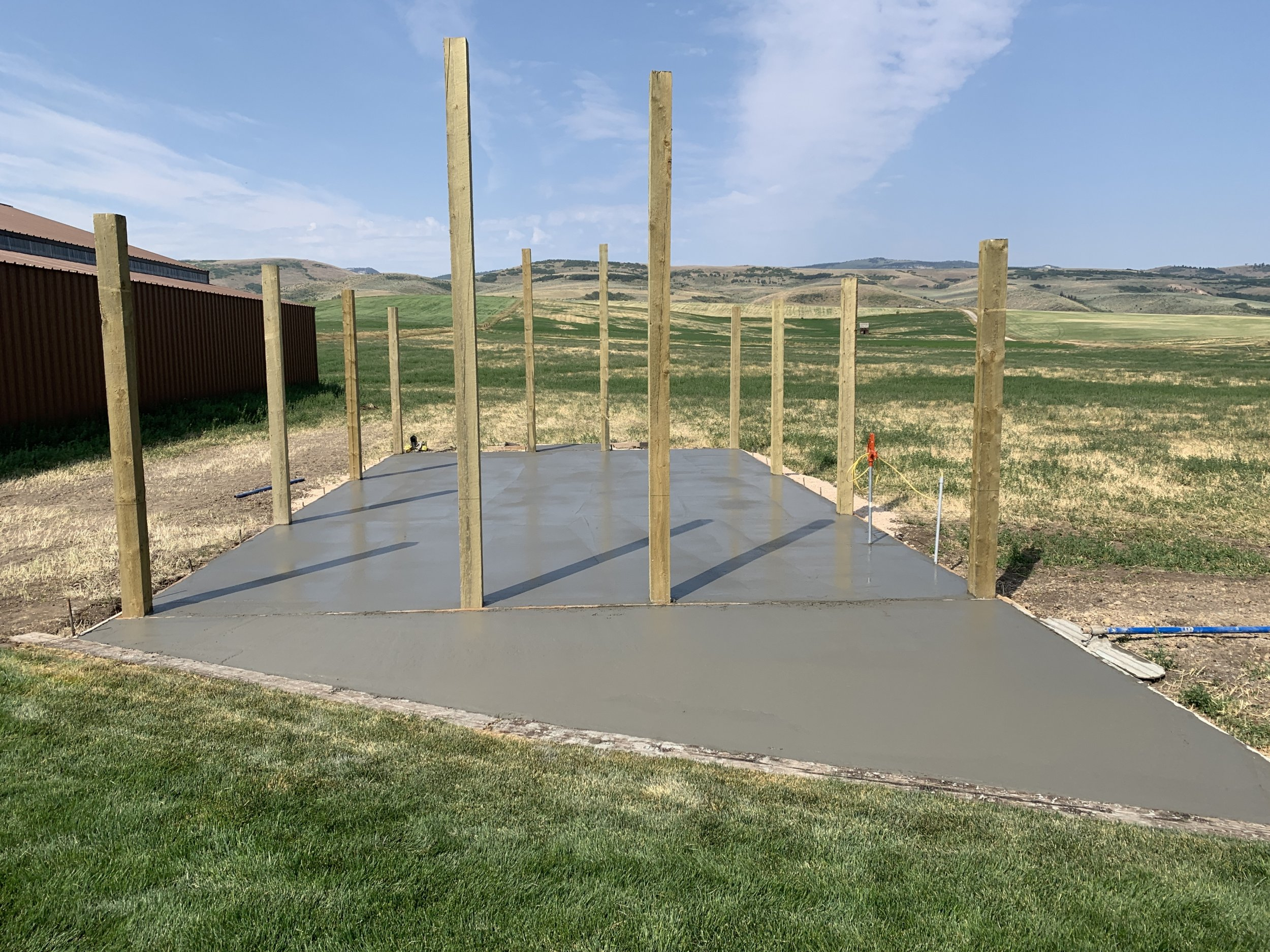

#25

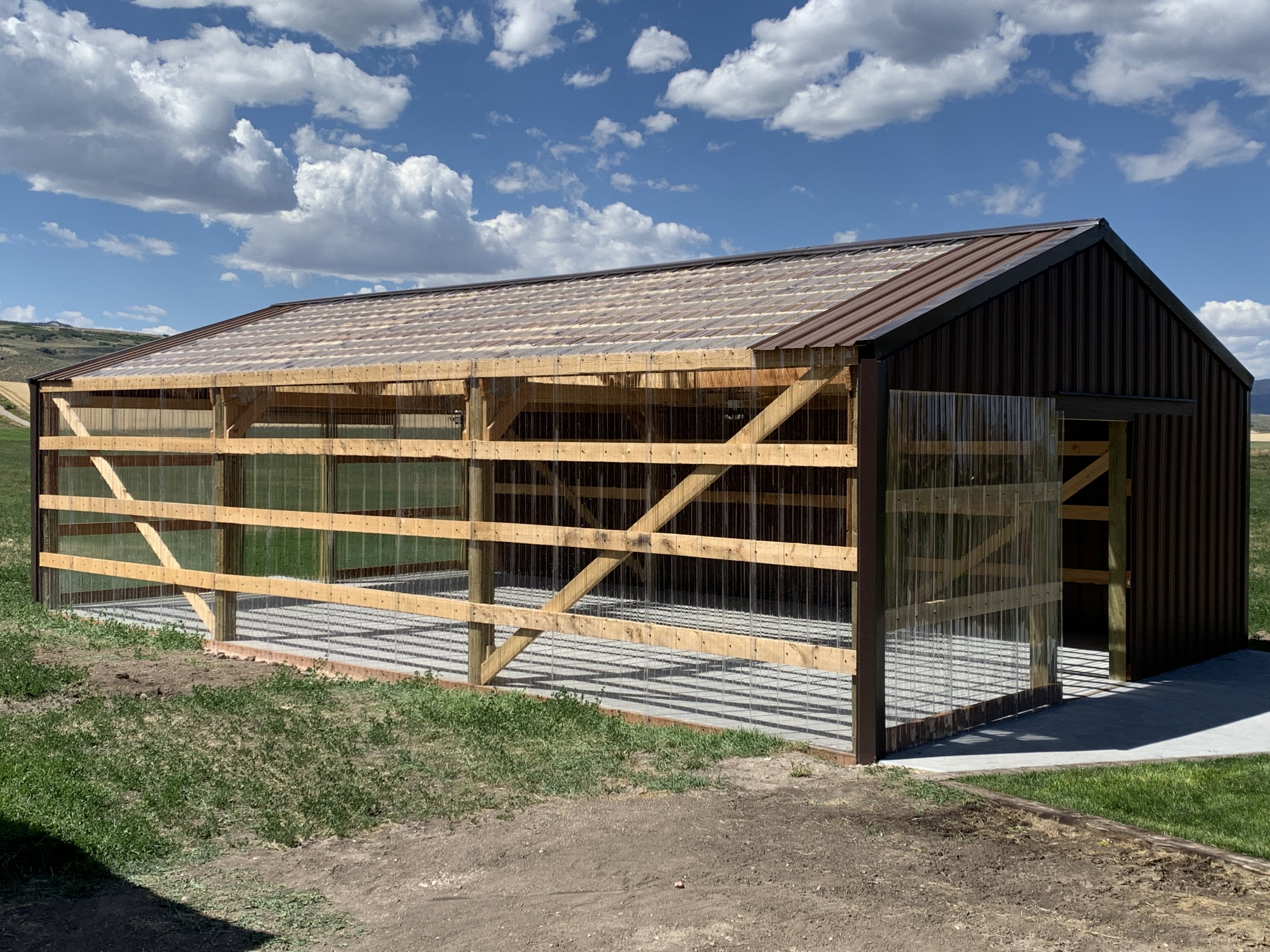

Sorry haven't posted in a bit, I've been busy with hay.
Here are a few pictures of the progress. Still need to put up 8 more wall panels but ran out of screws. Should be done by Friday. Then I can start working on the doors. They will be sliding barn style doors.

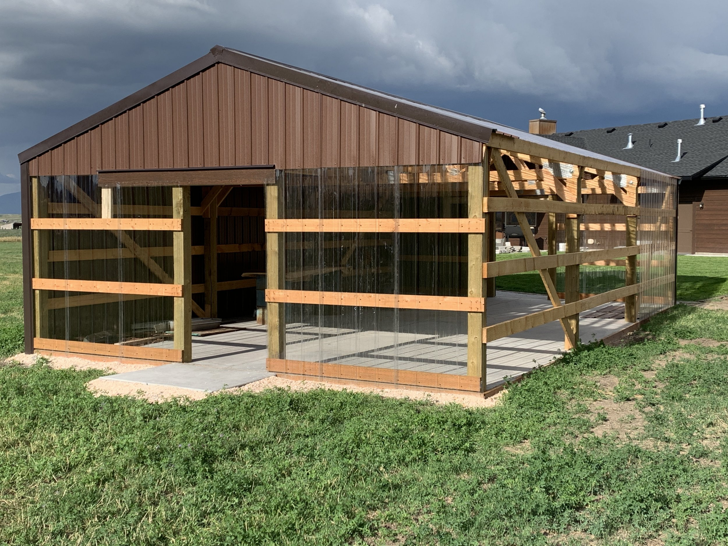

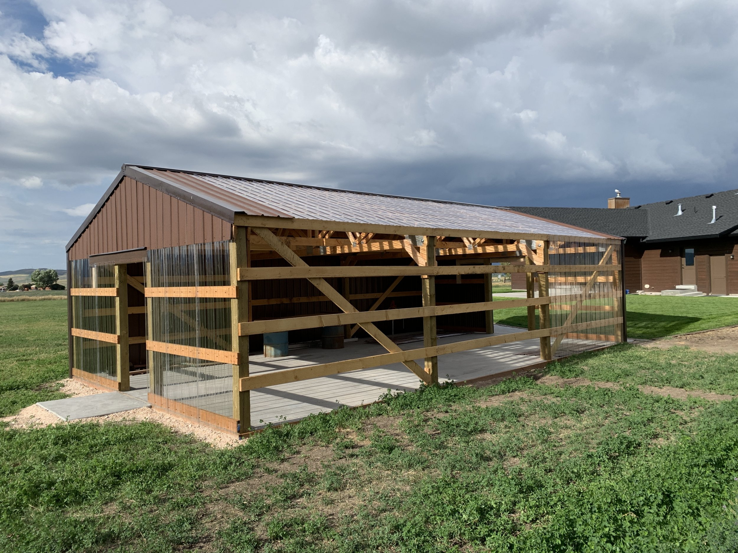

#29
The shell is done, now I have until next spring to get the raised beds setup and a watering system.
/ Building a Green House. #30
Looks great. How much of a temperature change is there inside the building?
/ Building a Green House. #31
Very nice, I'm jealous.

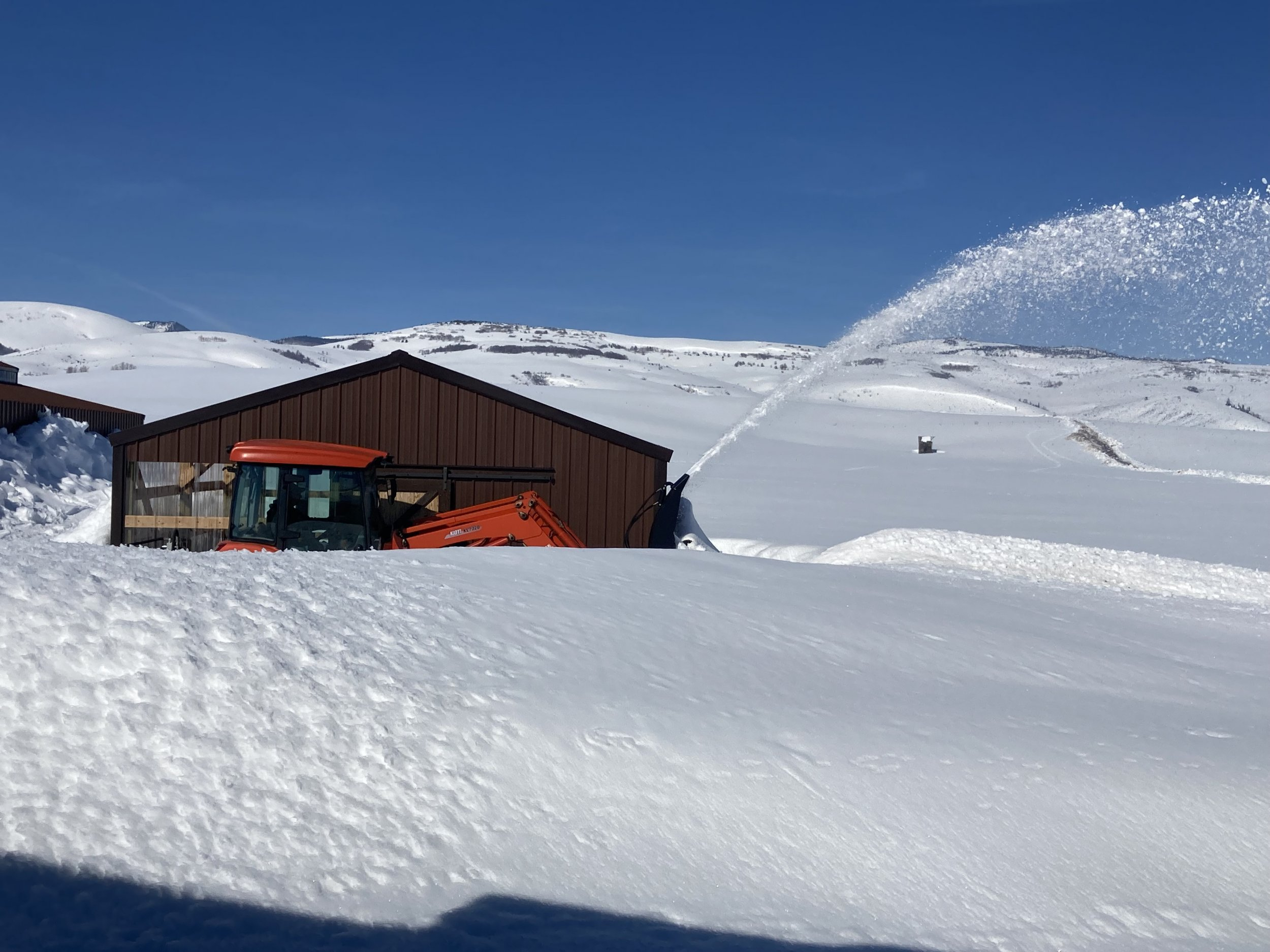

Spring is trying to come again to the Bear Lake Valley. I figured it was time to get something going on the greenhouse. First, getting access to it. The Robin got in somehow and that is proof that spring is coming..;)
We have the raised beds ordered. (water troughs) We'll get working in earnest once we get them. Of coarse, an automatic water system will also be installed. (by me)
I'm also glad that with the record snowfall we've had the greenhouse and barn are still standing with no damage.(y)
/ Building a Green House. #35
WOW, that's a lot of snow!!!!!
Since I don't know anything about living where it snows, what happens to the snow when it lands on the greenhouse? Does the heat inside the greenhouse melt it so it doesn't build up?
#36
It will build up while it's snowing but slides off soon after.

/ Building a Green House. #39
nice Greenhouse. I'd be afraid of the snow sliding off and cracking the side panels.
