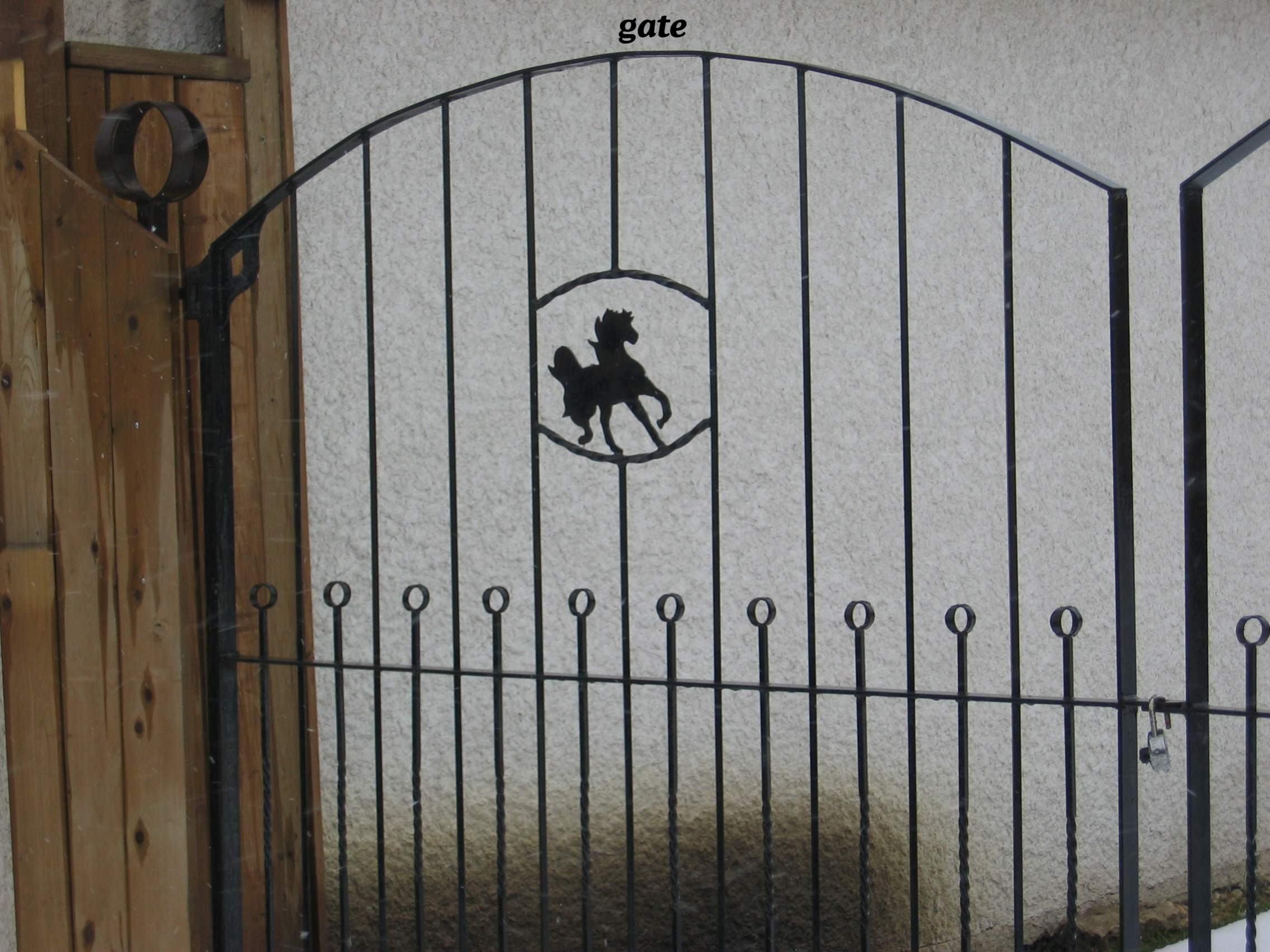

pic of one of my gates

wldrbob - very handsome gate, the pony must be proud.
jim
