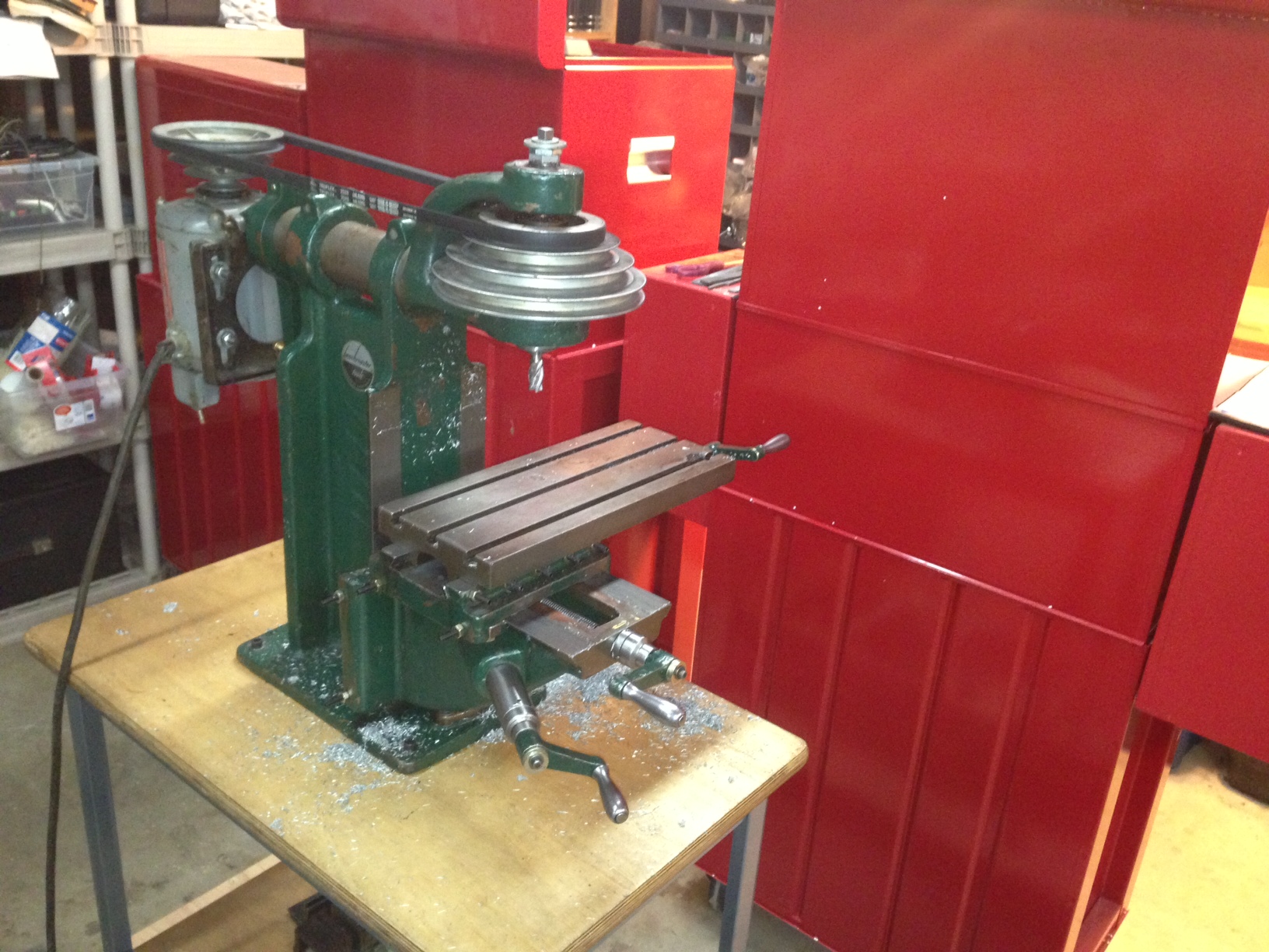

Every once in a while I need a milling machine for repairs. For as little as I use it, I didn't want to get a big or expensive machine. And I did not want to get an imported machine. Found this for $300 on Craigslist. Benchmaster, made in Los Angeles after WWII. This one is over 65 years old, still works fine.
/ Build it yourself? How about "Machine it yourself"?
#19
NICE! That'd be just the ticket for my little shop. I'll have to start cruising Craigslist again.
