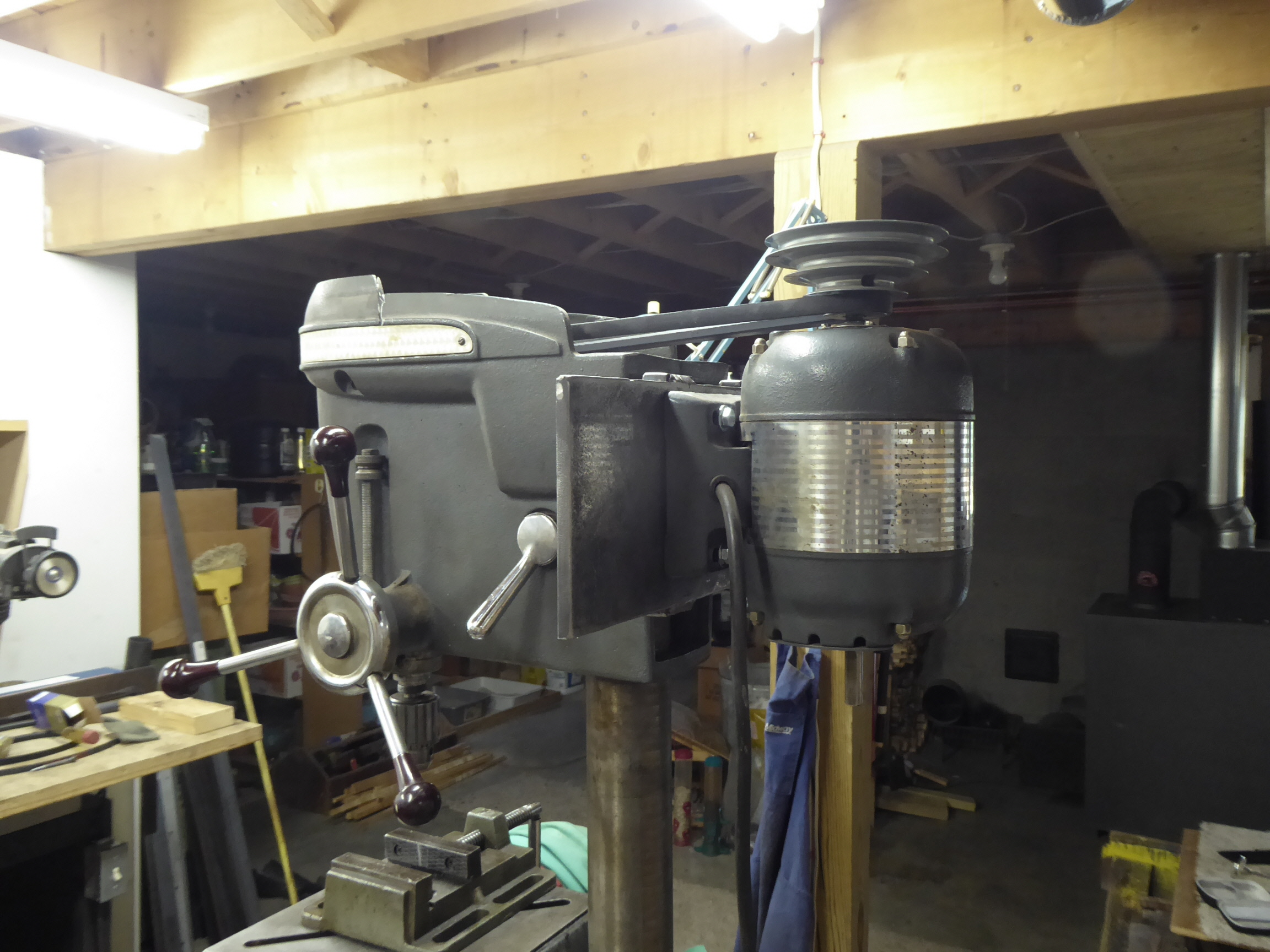

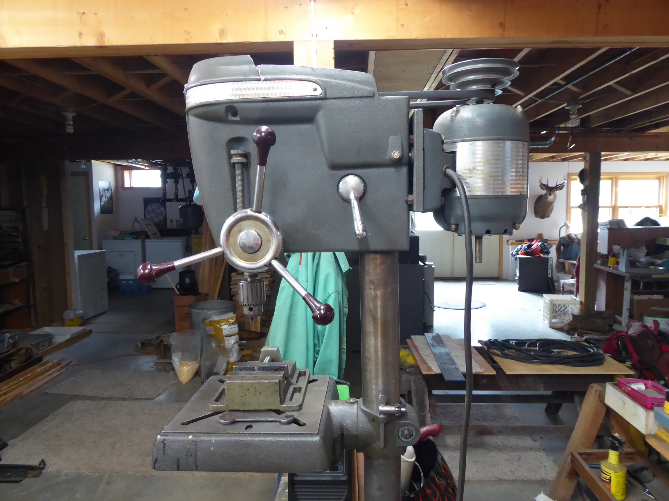

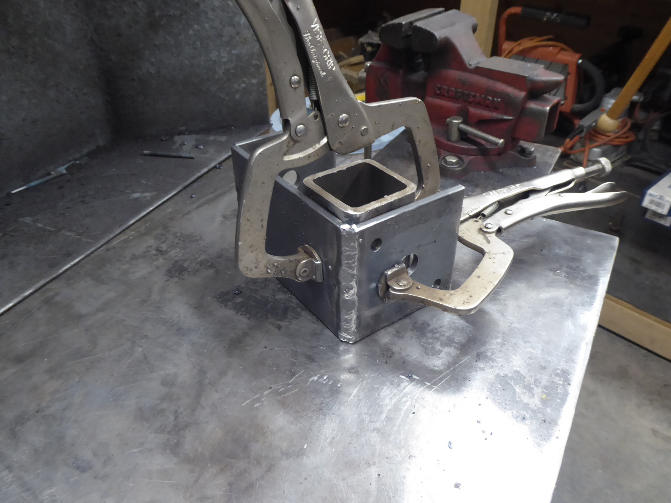

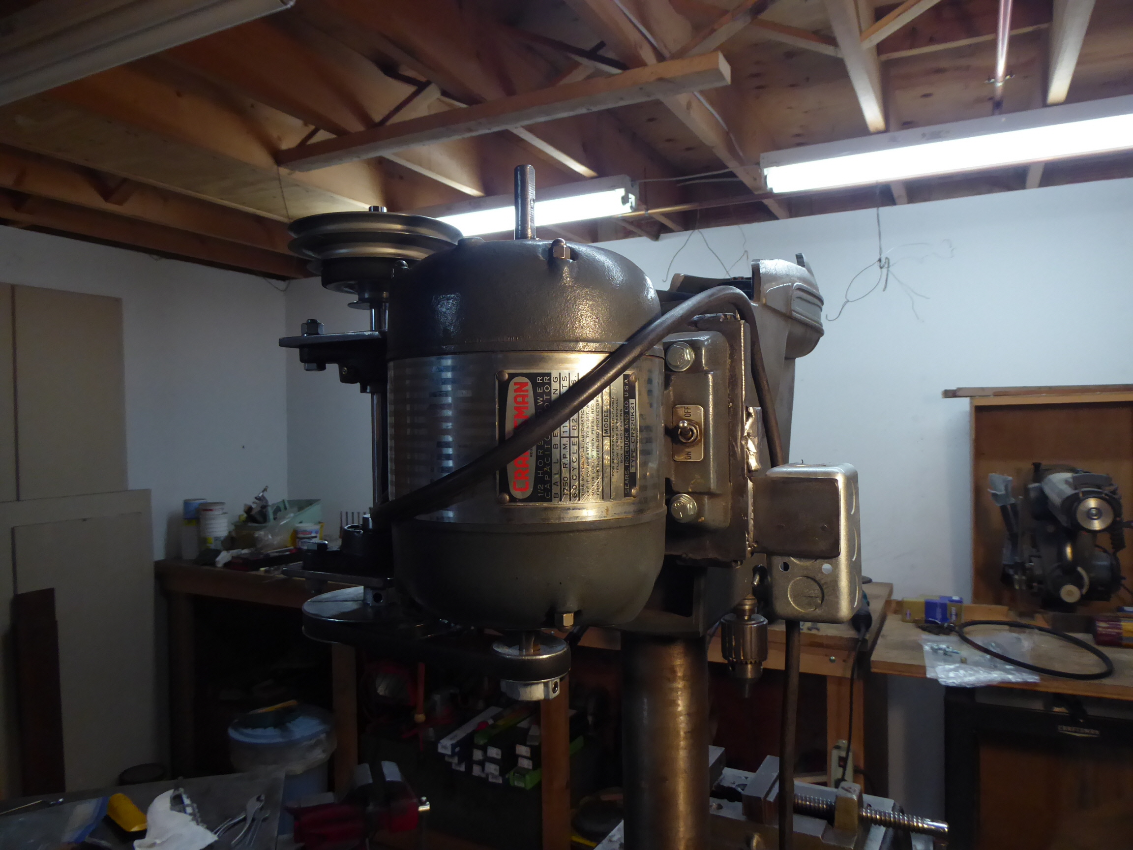

I have been running this Craftsman Drill Press since I was 14 years old. At that time, 60 years ago, it belonged to a man down the road who built metal tables with ceramic tile tops as a side business. I worked for him part time. 8 years later he became my FIL and I finally ended up with the drill in my shop.
I often wished that it would turn slower than 560 RPM. Wanting an indoor project recently, I decided to slow down the drill - finally. A factor of 3 seemed about right for what I do. So I ordered a set of pulleys and a 1/2" shaft 12" long from McMasterCarr. The pulleys were 1-1/2" and 4-1/4" pitch to give a 2.83 speed reduction ratio and a 200 RPM low speed and 1900 top speed. I also ordered 2 flange bearings and an A21 drive belt from Surplus Center.

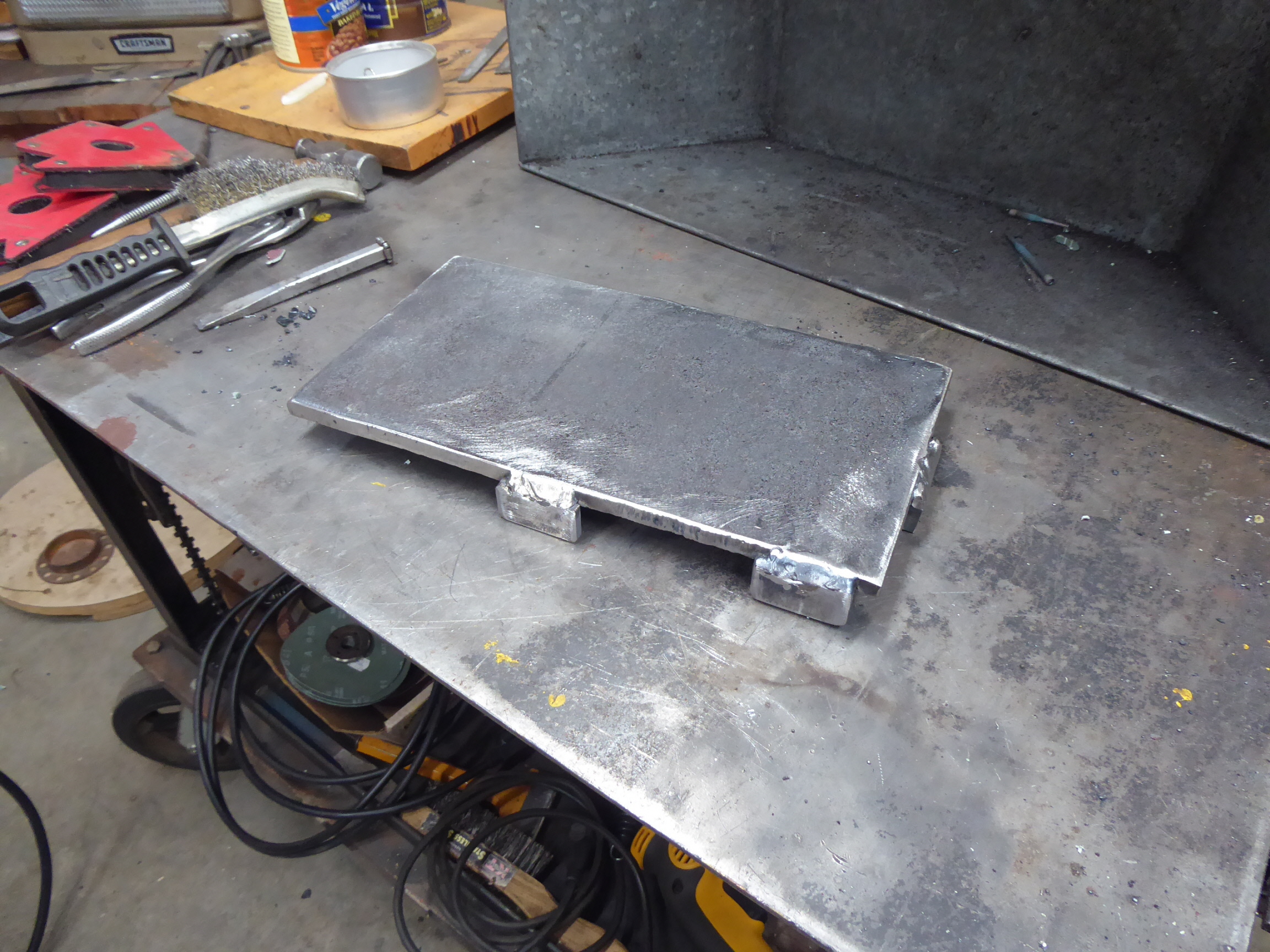

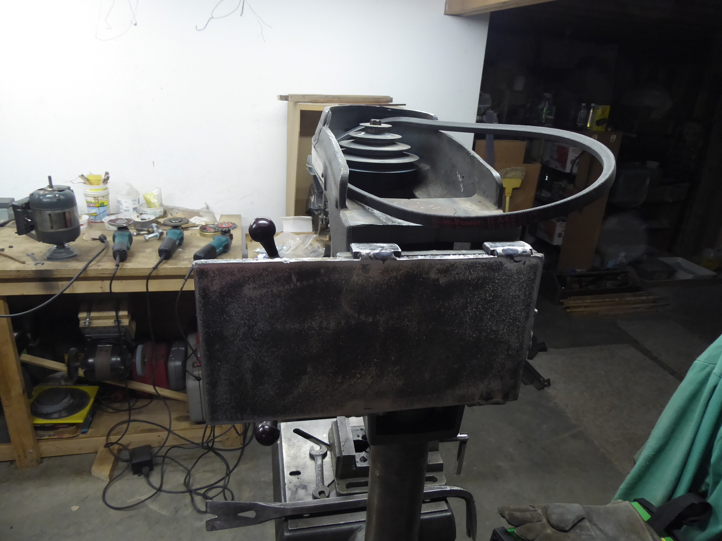

First I made a 6-1/4" X 12" motor mount pad with ears on it so it would fit snugly over and be supported by the drill press mounting pad built into the casting. Then remounted the motor so I could continue using the drill.

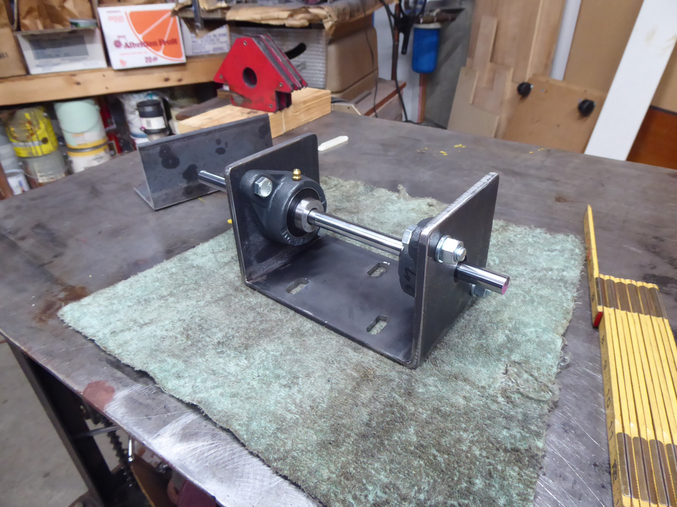

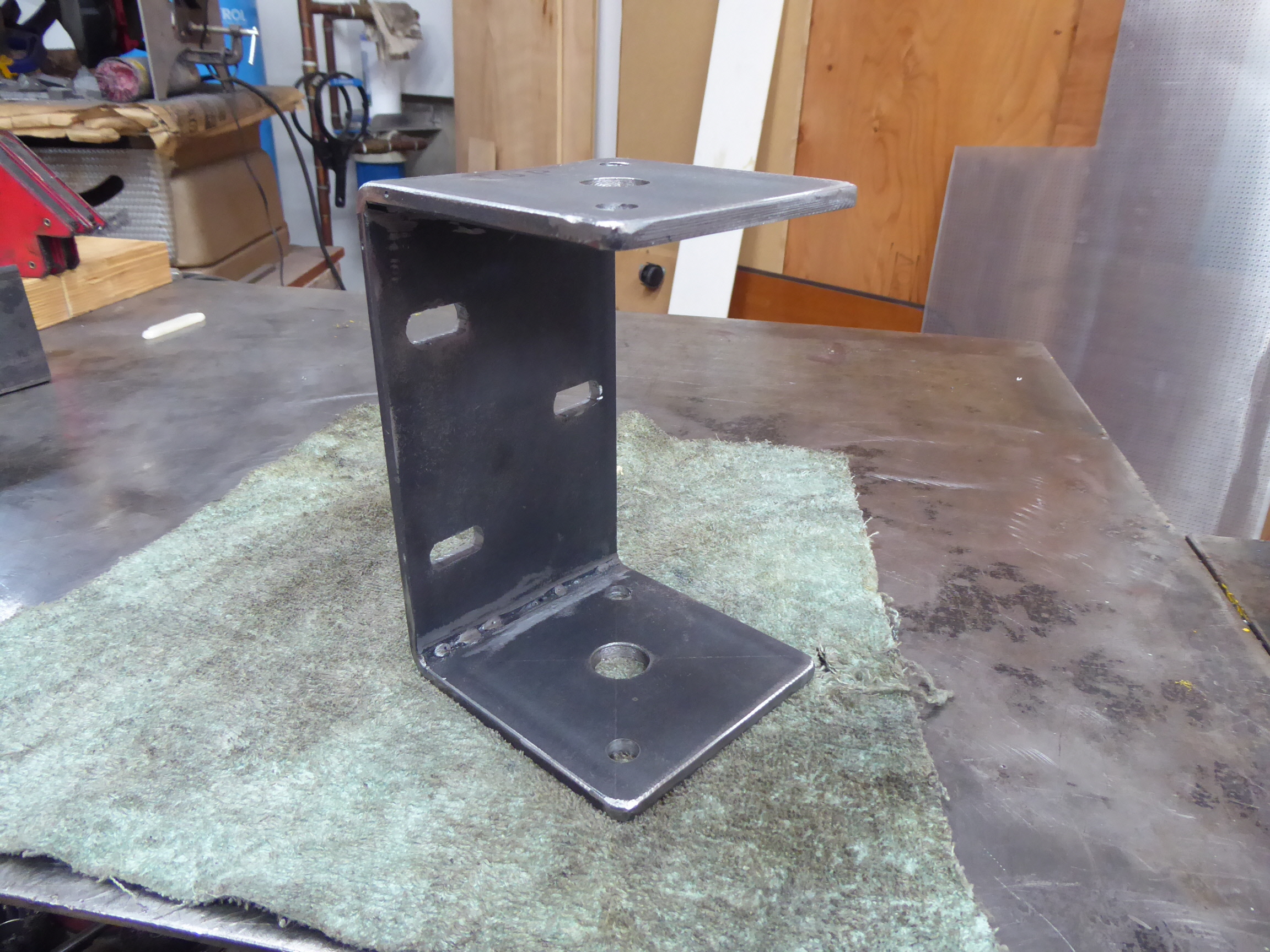

Next I welded up the C-Frame for the spindle from 4 X 1/4 bar. I pre-drilled the end plates for the bearings and managed to keep it square during welding. This is the first of 2 passes.
I added slotted holes to adjust the pulley tension and assembled the bearings and shaft.

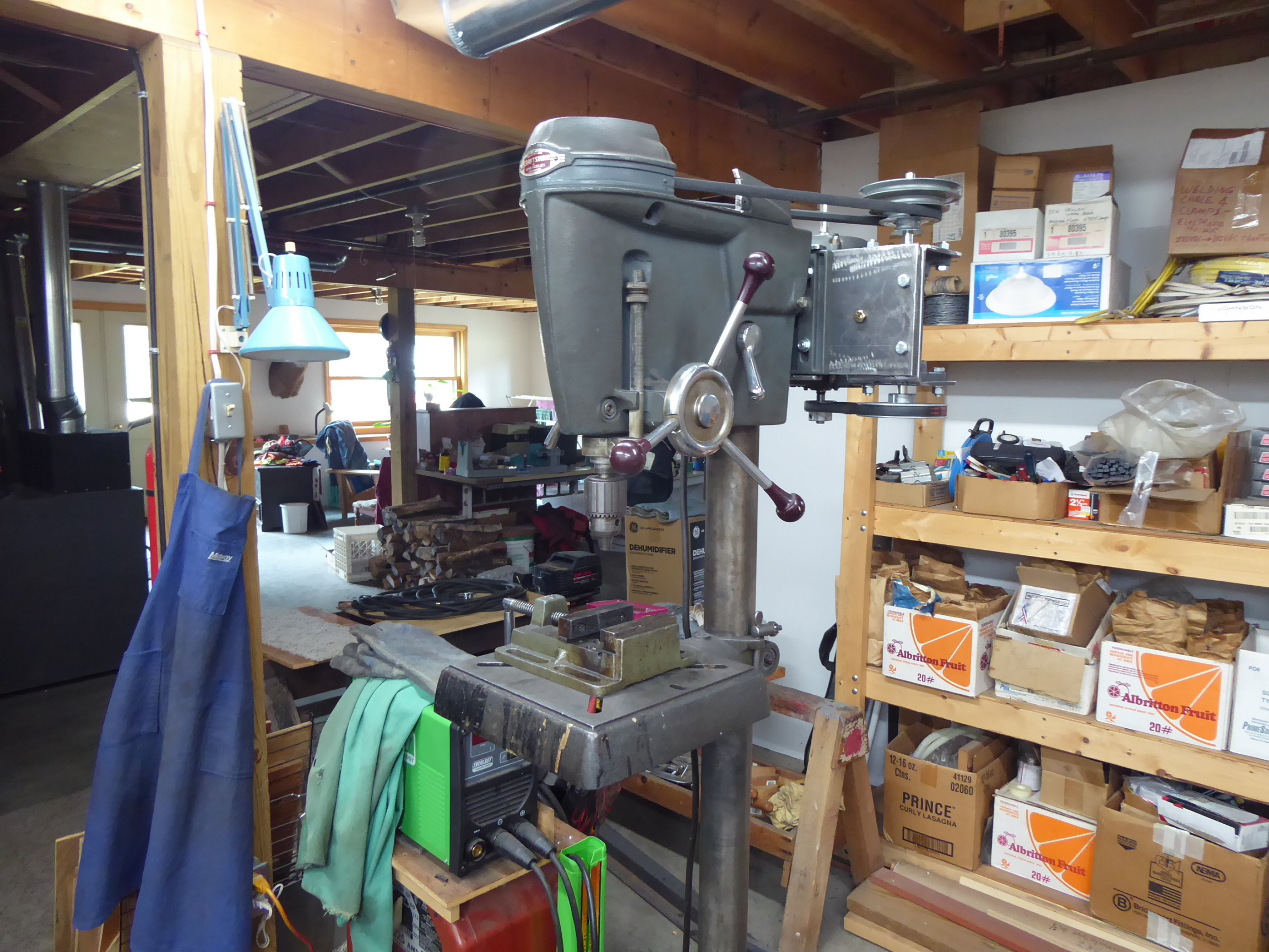

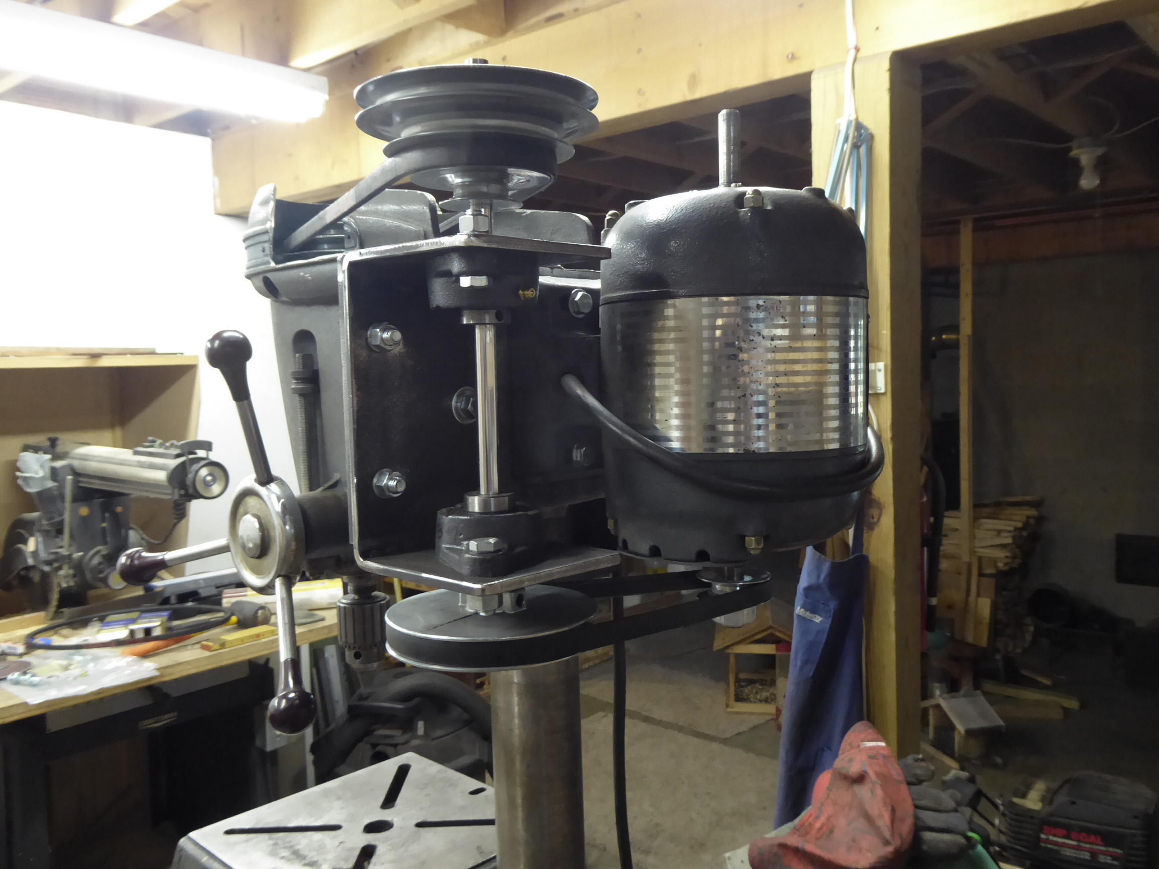

Then mounted the new spindle to the motor mount pad putting the speed reduction pulley on the bottom and the original 4 way drill pulley on top. I had to cut a notch out of the side of the drill casting for the main belt.
While I was at it I mounted a switch box to another ear on the motor mount pad so I could attach a grounded power cord. Another thing I have been thinking I should do for a long long time.
Turned out to be an interesting project and works as it should. Drilling 1" plus holes will no longer be the adventure it once was. Don't know why I waited so long.

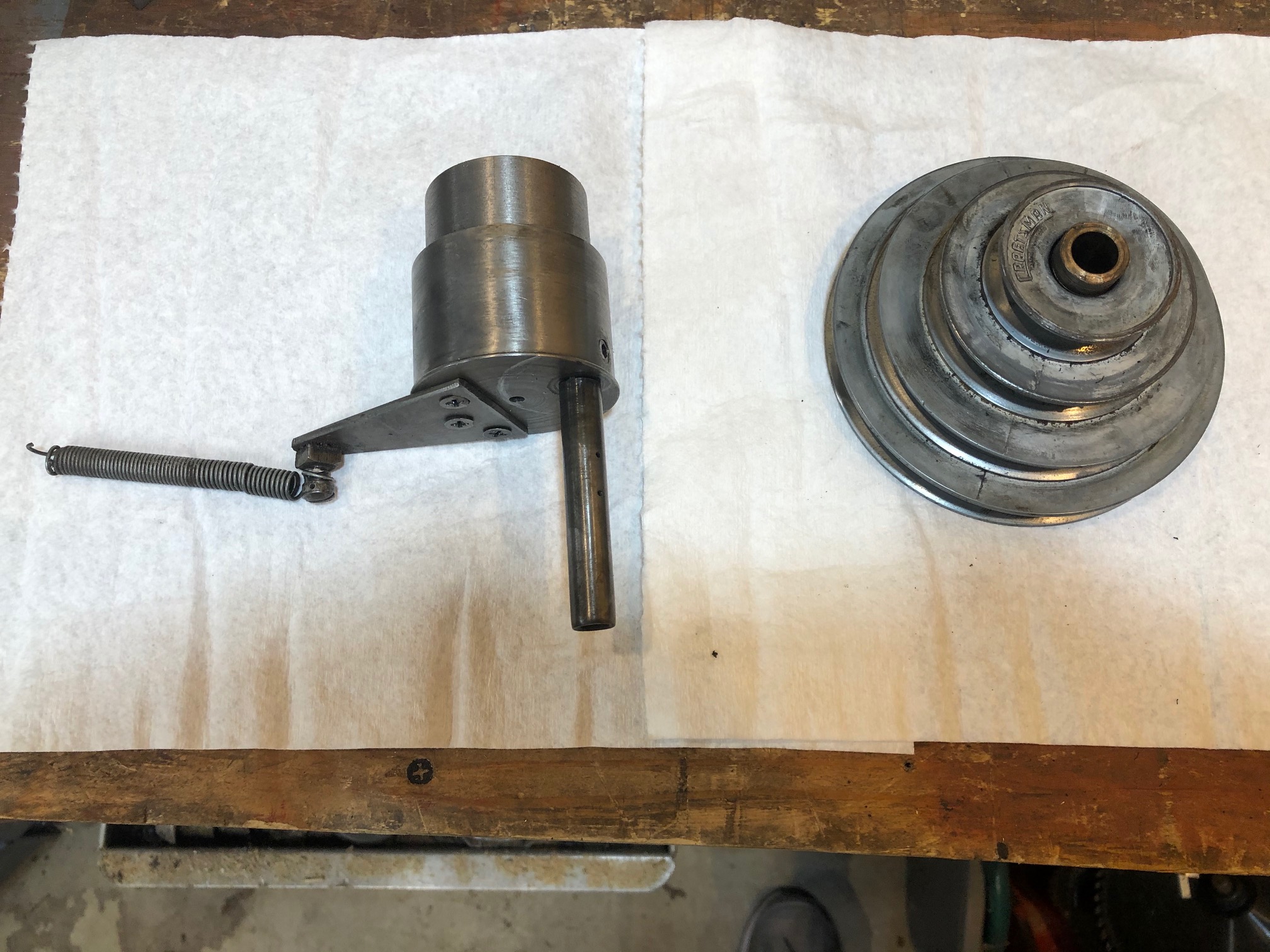

I have an old Craftsman drill press about the same vintage. Someone added an intermediate pulley. The pulley goes on an arbor that is mounted off center on a plug that just drops into the upright tube. Very slick. Spindle speeds down to 290 rpm and much higher that I never use.
Like SR said mine is pretty routine but that little gem is really really clever. All you need is one small pulley for the motor and two new belts. And if that plug is free to swivel in the tube both belts tighten at the same time with the adjustment that is already there. Too simple.
