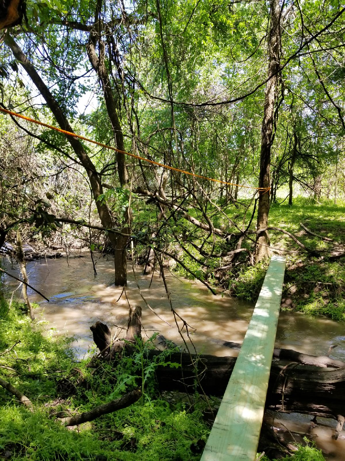

Hello Everyone, Thanks for all the insight!
I like in Katy, Texas near Houston and our new property is in Smithville, Texas about 70 miles out. It will be our retirement place but for now, it is our weekend ranch with just an RV. I will be there tomorrow and will take lots of pictures of the creek, but for now this is the only one I have. It is a rope and a 2X12X20 board that I bought at the local lumber store for a temporary cross. The board now has an anchor in the middle of the creek. Like I mentioned earlier, I think to clear the creek to solid ground on both ends will like be 24 ft. Here is the pic.

Like Newbury I have been involved in planning and building "hasty bridges" when in the Seabees. We did some innovative things. They were just that; keep the troops and cargo moving. Was not intended to last and was built with what we had available. That is not what the OP is looking for. I agree we are short on info and pictures to do a real planning scenario. If I understand the OP's desire he really does not want a HS-20 capability bridge. My RR tie stringers are still viable. Yes they need to be off the ground on sills or gravel. Used Waterfront structure timbers should be in good supply around Houston as well as RR ties. I assume this is not a "permitted" project so stamped engineer documents are not in the scheme. Like all of us he will be fine with our standard DIY "overbuilding" ideas.
Ron
