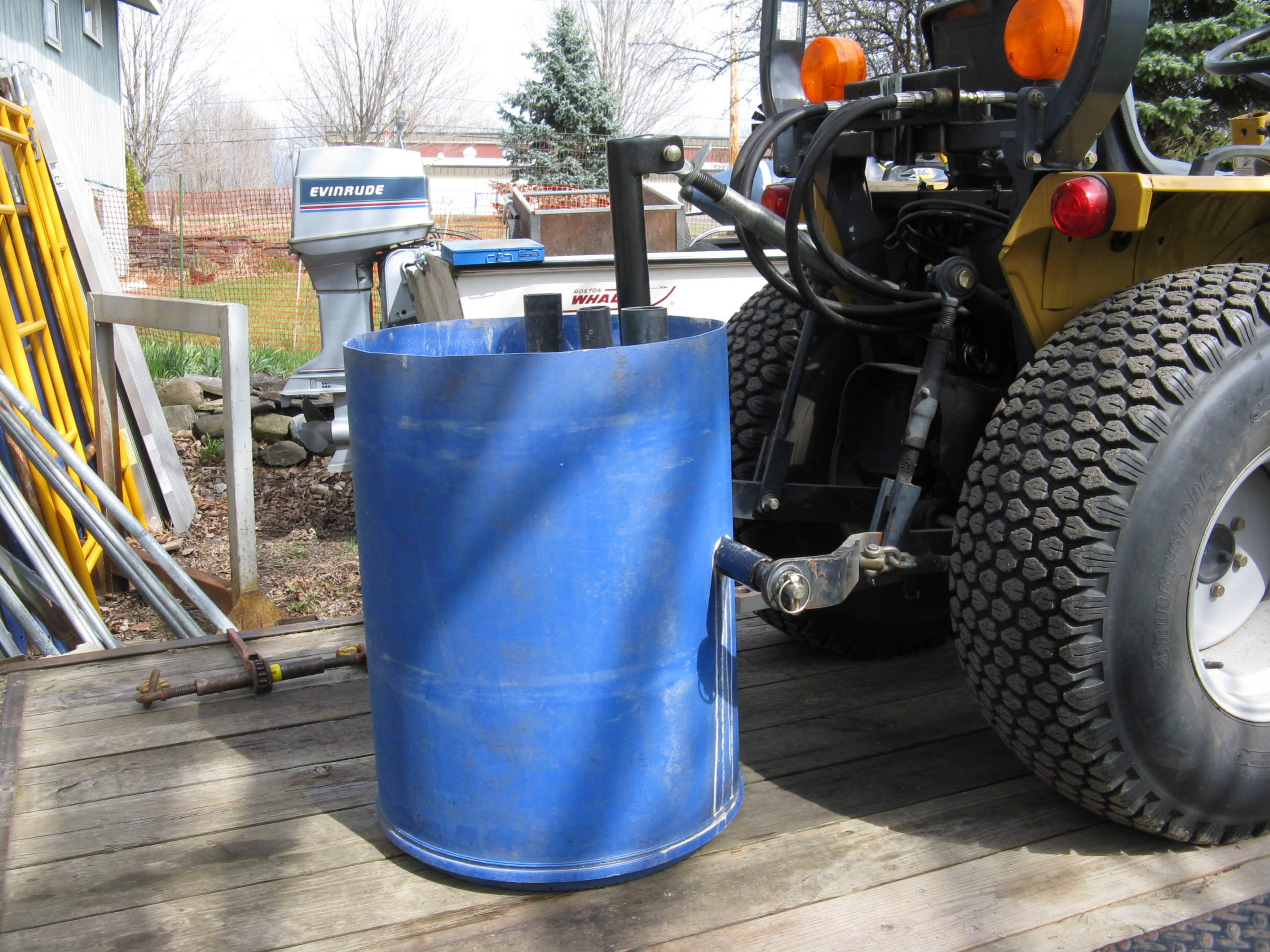

Having more time then money and a lot of junk lying around I decided to build a counter weight for the 5045E on as low a budget as possible. Having a steel 55 gallon drum in hand and a few old hardened bags of mortar mix, or cement etc. That has become the plan. n o great revelation here .I'm just going to do it about the same as every body else has.

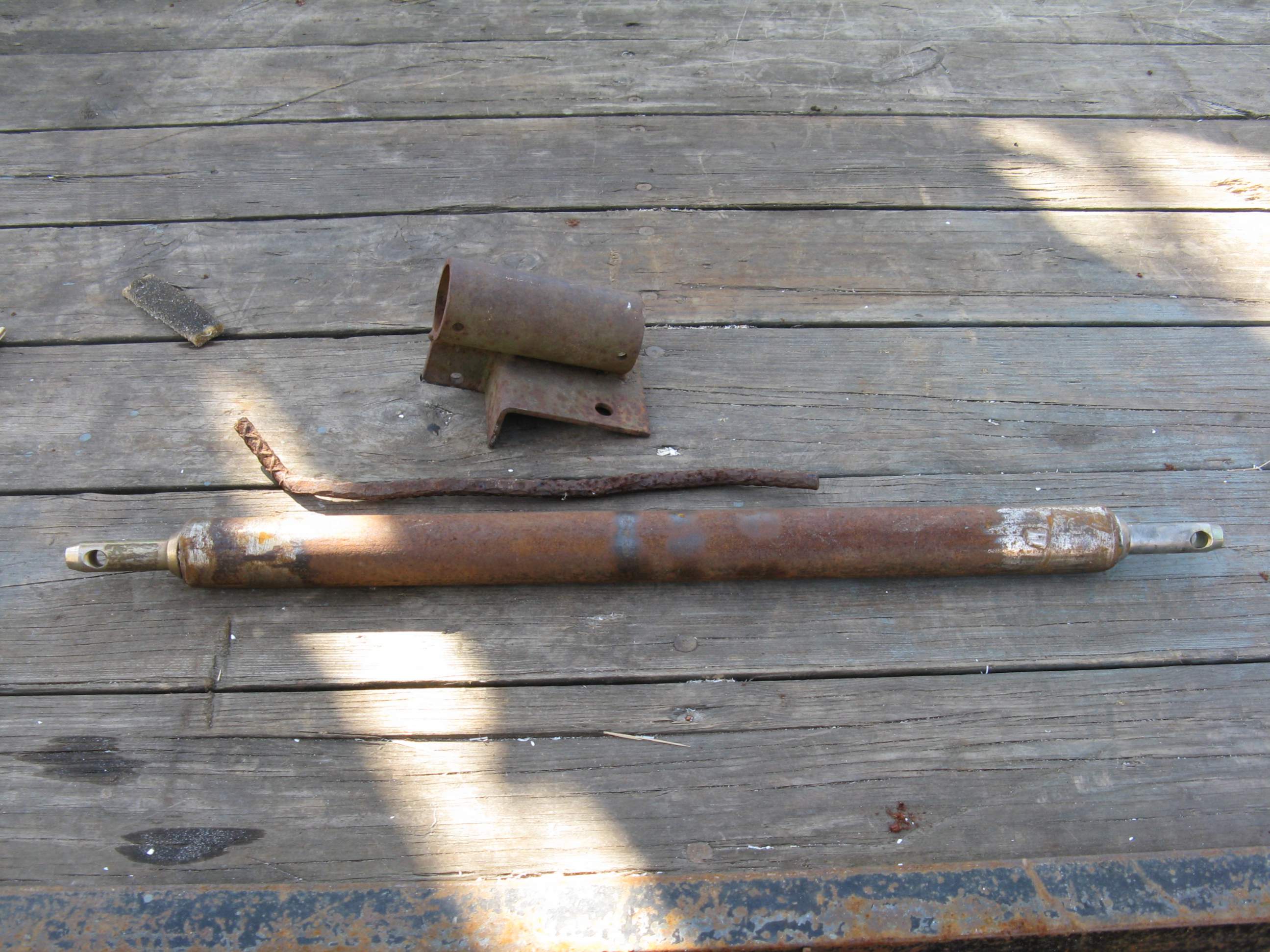

Anyway today I took the first step. I found a #8 rebar in the bone pile and cut it to length and drilled the holes in the ends for the lynch pins. I ground off most of the rebar deformations on the ends even though it fit through Cat. 2 bushings as it was. I regained my respect for grade 60 steel and had to relearn how to sharpen drill bits.
So far my counter weight weighs about ten pounds. :D

Rebar is melted down scrap so it can be mild steel or carbon steel or a mixture of the two. Sounds like you have some carbon steel in yours. I would buy a bag or two of crete mix and bond all of the stuff you are adding to your weight.
/ Budget counter weight.
That is in the plan. Just how many remains to be determined. Some of the old cement and mortar mix left overs I have lying around may be able to be mixed with a little effort and some of it is just shove the whole thing bag and all into the crete. I have to get the drum from its hiding place and get some holes through it for the cross bar then work out the top link tabs. One expense I may have to spring for is a drill bit large enough to drill the holes for the top pin. I don't have anything that big in hand.
/ Budget counter weight. #4
I would weld the top link in some way that it would be attached to your bottom pins. I would also weld some pieces of rebar on the horizontal,so it will not spin. bust your junk bags up and pour in some good quick crete. Paint and decals later. Top of barrel left 4 inches high for extra chain storage.
/ Budget counter weight. #5
This seems like a good use for your bent crossbar. Probably still stronger than the rebar.
I have some #4 bar to connect the two. I'm thinking the top link tabs need to come out of the side of the barrel eighteen inches above the cross bar instead of sticking up out of the top of the concrete.
Yes to your other suggestions.

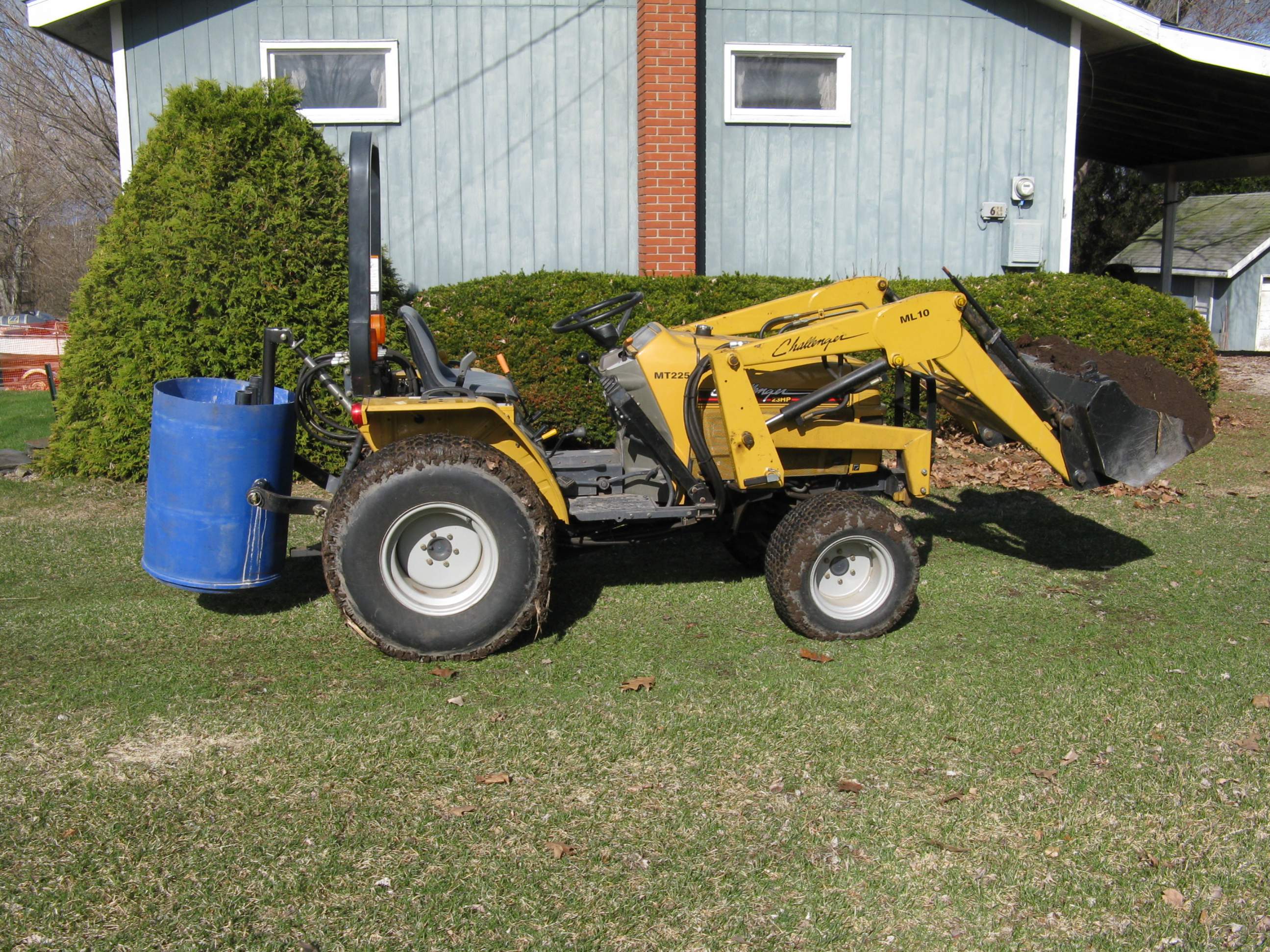

I used 1 1/2'' pipe and pins from Tractor supply. Metal from old dock hardware and seven 80 lb. bags of concrete mix.
/ Budget counter weight. #10
Update w/pics??? :confused3:

Ballast barrel is a great place to get rid of any old brake drums or rotors lying around too. If you haul scrap fairly often may be worth more to you selling it but it's a cheap way to add weight!
#14
Oh I plan on adding quite a few bits and pieces from my scrap pile including seveal old brake drums. I think I've got enough scrap around to get the finished drum up to about 1300 lbs.
/ Budget counter weight. #15
Change that to 15 inches and you can use the JD i-match 3 point quick hitch.
