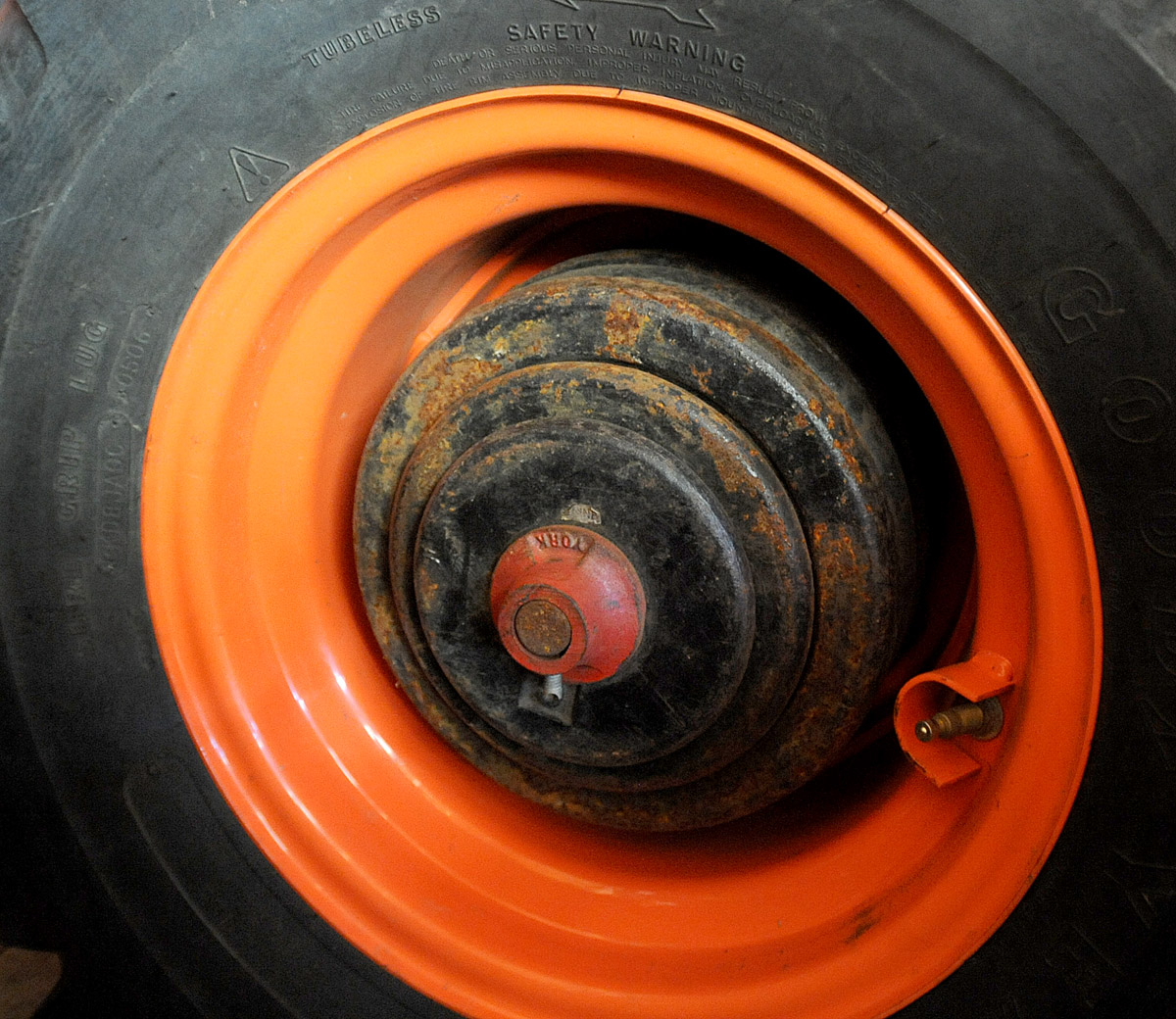

Here is a picture of what I made. It bolts up to the hub wit three of the lug bolts. The 1" rod in the center is welded into 1/4 plate and there are some other not so minor details that I'm lazy to type up now.
It has #115 of gym weights per side at the moment but eventually I would like to have #200 per side but I have to have stuff custom cut for that.
It is probably out of balance but I wouldn't know as I'm off the hinge.:drink:

I don't know if it matters all that much when you are traveling 1-6mph on a rough dirt surface. I understand the need for a balanced tire on a vehicle traveling 60mph, but I just don't think it would be an issue with a tractor. I do agree that the 1/8 steel plate would be too thin.
Most tractors will run a little faster than 6 MPH. The man said they would be 10" deep. Even at 6 MPH and "Rough dirt", maybe a few ruts & rocks. Hanging out 10" even 100 pounds over time is going to ruin something.
Your weights are nice and close in, that makes a big difference.
Welding a hunk of barrel to a flat plate even 1/4, it is going to warp. Even if pre-drilled and centered that weight is going to hang at an angle.
You being a real "Authority", please tell me why it is a GOOD Idea.

I'm by no means any kind of an "authority" on this and was farthest from my intention to ruffle feathers over this subject. I was hoping you would give a definite reason why this could be a source of trouble, so myself and others can avoid it. Never read before that they can cause trouble.
I personally prefer the wheel weights because they make repair to the tires easier. No fluid leaking out of a wheel that weighs 200-400 lbs. and it might need to be transported somewhere. That is all.
