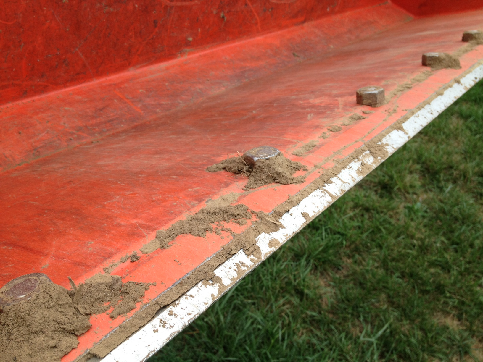

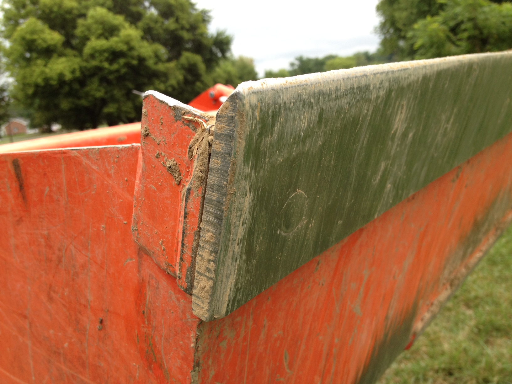

If anyone buys a weld on cutting edge and cuts the old one out be careful and alternate your weld in two-inch stiches.
Giving it some cooling time in between stich welds and alternating positions.!
It's very easy to have a warped cutting edge
I watched a guy ruin his bucket just running a continuous bead.
Bolt on cutting edges and plug weld is a better way to go if not a real experienced welder
I welded one in my backhoe bucket but had learned what NOT to do from watching my friend ruin his. It was pitiful how bad he warped it.😵‍💫

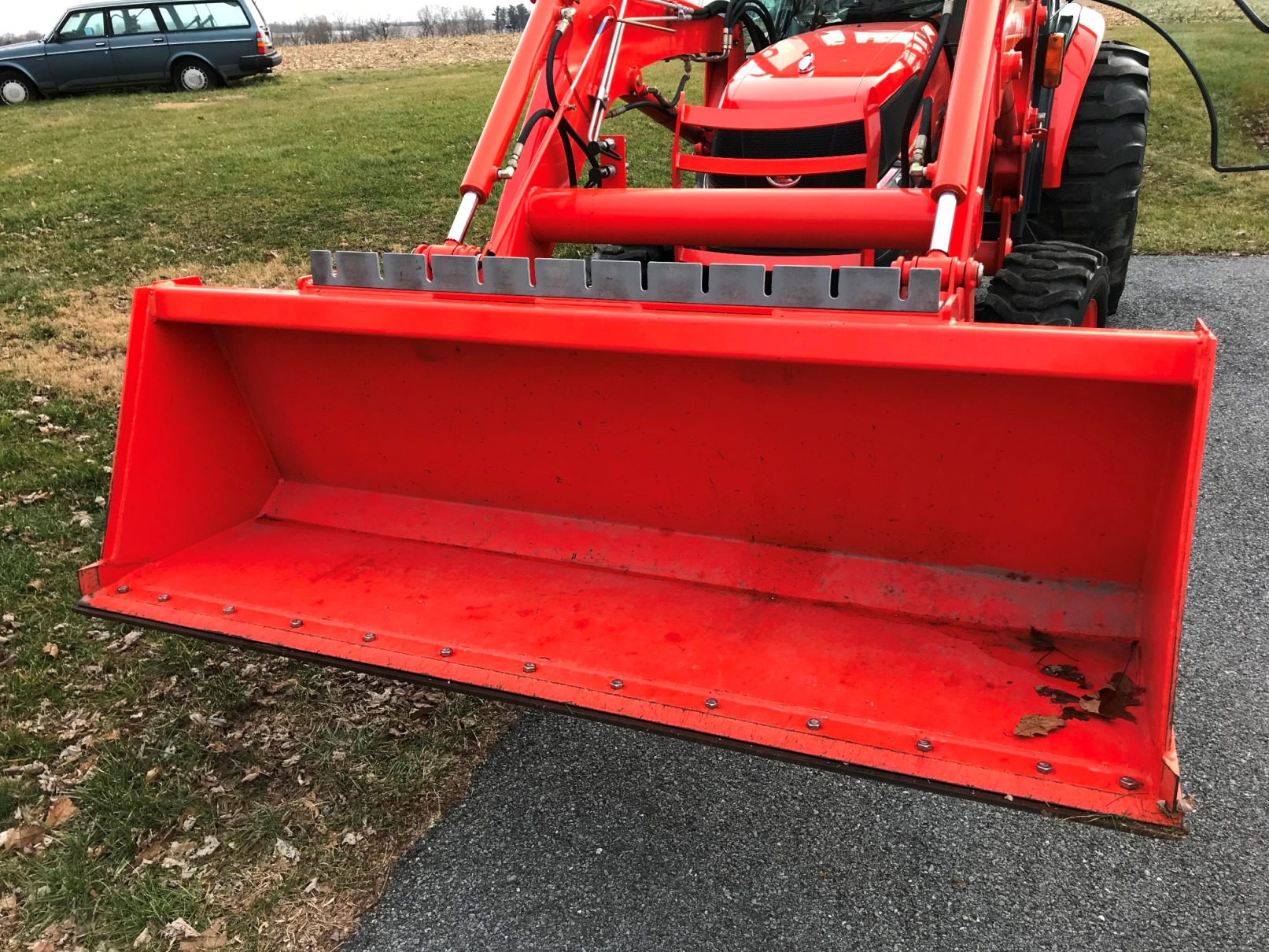

I managed to produce a little heat on this one. 5 holes, annular cutter, no coolant oil only, heavy enough drill press. $12 for the cutter I could think of as the cost of doing business. $58 material, $12 cutter, way ahead vs dealer cost of $280.
