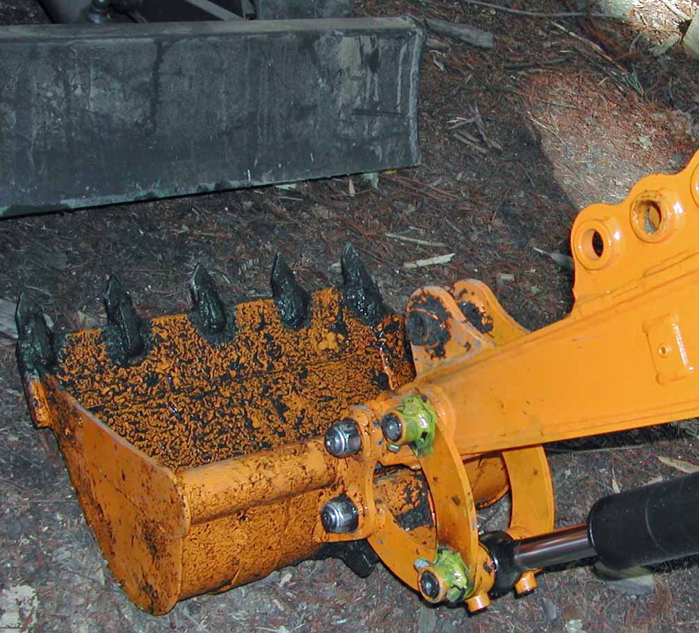

I bought a kit off the internet and built my own, about half the cost of a prefab job, easily removed when not needed and has replaceable teeth if I break or wear one out. Don't remember who I purchased from. Easy build, maybe 2hrs at the most.

There a lot of pretty inexpensive weld on shanks with pin-on teeth teeth on eBay. Search "2740-MW-23" . Also, Amazon has a lot of products from Digger Supply such as "5 CAT Style J200 Backhoe Bucket Shanks 3/4" Lip, Dirt Teeth, 1U-3202, 119-3205" These would work great with a piece of about 1/2" by 3 to make your own tooth bar or just buy the pin-on teeth and cut to fit and weld them to the bucket. Either would be very strong!

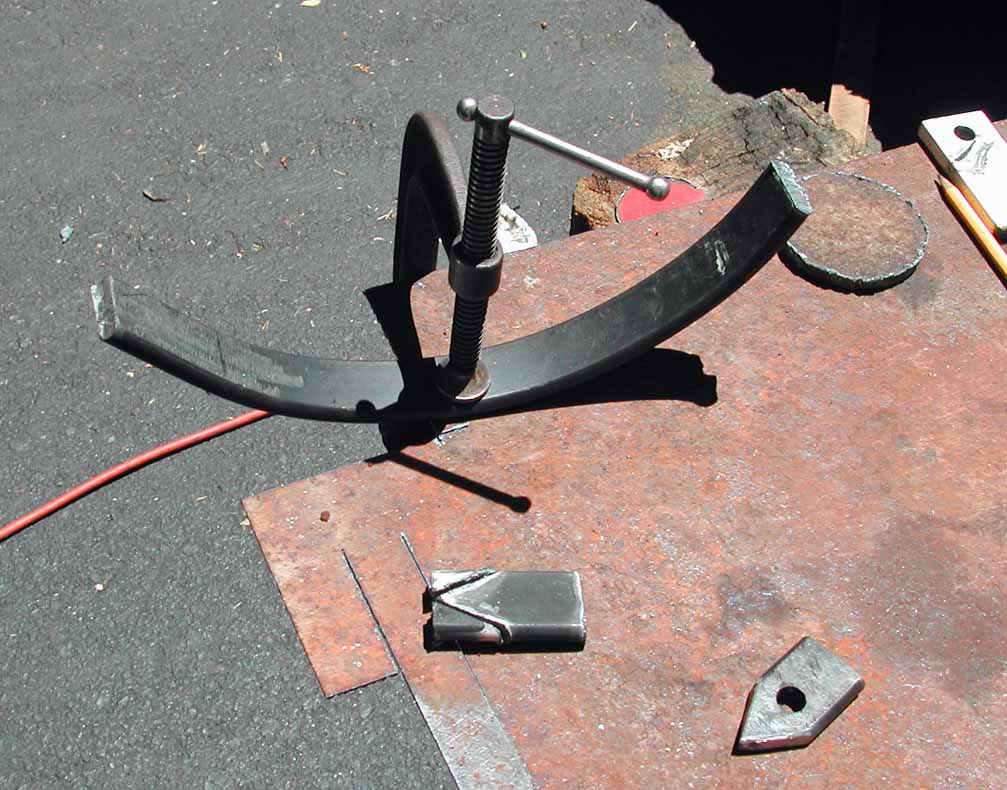

So I figure 40 bucks worth of steel 10 bucks worth of rod a half a box of wobbly pop should do it. The deffinite drawback will be the "permanense" of it, but once again half a box should get it ground back off.

I'm thinking of using 1"-1 1/4" solid stock steel, then cutting 8-10" inch lenghths at an angle (for the tooth point) then hard surfacing the point edges, then welding solid to the bucket. Any ideas. I already decided that solid mount would be ok. I don't need to take them off....i hope. Oh well I always can grind the welds out.
