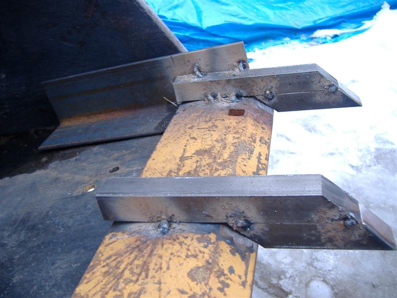

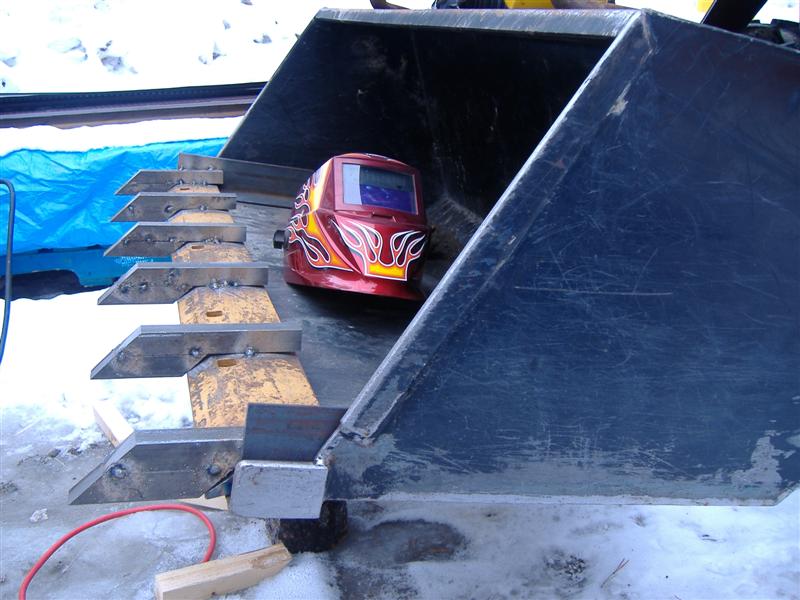

Made some teeth last month out of 1 1/2" hex the neighbor gave me.Cut them on the chop saw.
/ Bucket Teeth/Home Made? #22
Yukon .... Very nice. Don't worry about what the welds look like .... Just blame it on the wobbly juice (as evidenced in the background on the driveway!)
Not bad for $100

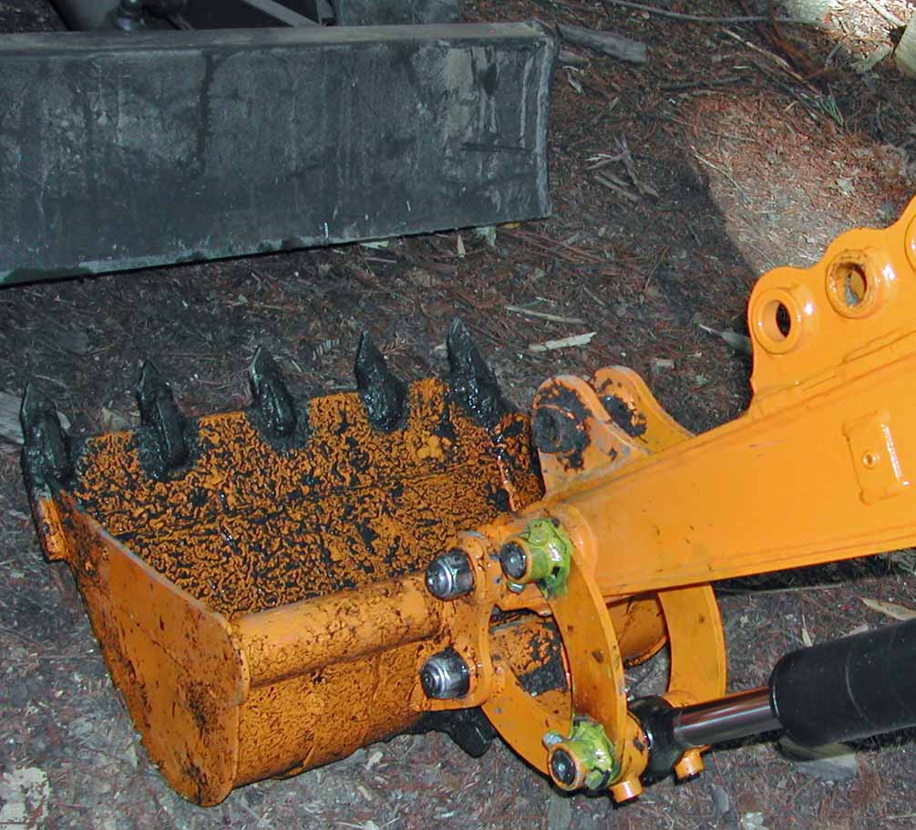

I am just coming into 100hr on my custom teeth made from 3-point rake tines. They have held up very well on my mini-X bucket. I posted them in another thread, but here they are again. 12yo thread....brings back tooth memories....

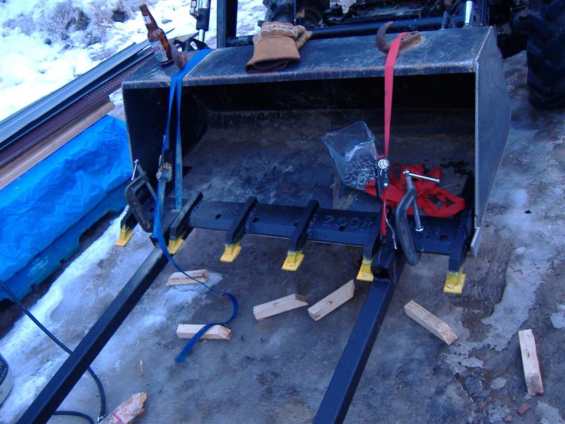

A neighbor built this toothbar for my tractor. Ingenious use of available materials to make a very useful toothbar which is easy to get on an off (one bolt on each side of the bucket). If the prongs break they are easily replaced.
Say, now that is a nice design. The neighbor did a great job and I can see the ease of installing, very nice job..
That is a nice convenient set up and should dig right in. I personally like the idea of a bolt in versus a welded one simply for maintaining the integrity of the bucket strength. I would like to make a suggestion. If you could use the type of bolts made for the sickle bar teeth that have a tapered head they would fit flush with the top of the tooth (guard).It would be less apt to keep the dirt from sticking and building up in the bucket.
