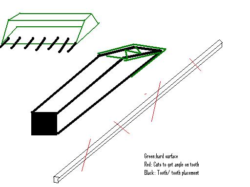

I'm thinking of using 1"-1 1/4" solid stock steel, then cutting 8-10" inch lenghths at an angle (for the tooth point) then hard surfacing the point edges, then welding solid to the bucket. Any ideas. I already decided that solid mount would be ok. I don't need to take them off....i hope. Oh well I always can grind the welds out.

/ Bucket Teeth/Home Made? #2
Will you be using this for manure or dirt? My dad did this on his Case years ago, only he made them longer and bolted them on with 8" of tooth back into the bucket, 6" sticking out(for manure). Make sure that you mount the wide side vertical so the added depth will give you more strength. You may want to also add (weld)some bracing accross the bottom of your bucket to stiffen it. Mine looked strong enough (no tooth bar) until I started lifting big rocks, now it has a slight bow downwards in the middle....

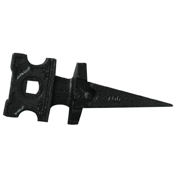

A neighbor built this toothbar for my tractor. Ingenious use of available materials to make a very useful toothbar which is easy to get on an off (one bolt on each side of the bucket). If the prongs break they are easily replaced.

I like those teeth! Never seen those for sale anywhere.
they look like the teath heads? that sicklebars use. perhaps off a corn head?

Licklog said:
I probably should included more info on the "teeth". Here is a link describing them a whole lot better than I can.
Oh oh! They seem to be malleable cast iron mower guards. Not hard at all.
I am afraid they will wear out fast on that FEL bucket.
/ Bucket Teeth/Home Made? #11
YukonKing said:
Plus it will trully tell me if I should have bought her "implants' or just "dentures".
YukonKing
Well, I think your implants will be a bucket of grief instead of bucket teeth. If the teeth stick out very far in front of the lip, they will put tremendous twisting force on your bucket's cutting edge and maybe even twist and distort the bucket's sheet metal. You need a thick bar to mount the teeth onto and a groove over the lip to keep the teeth from peeling upwards when you hit a rock. It won't be long until you are snaggle-toothed. you might prevent this by drilling and bolting the teeth to the bucket, but it all seems so futile when $300, shipping, and a little patience could get you a very nice tooth-bar instead of a homemade headache.
I know your tractor is only 25 hp, but I don't think that will matter. I just can't be positive about your chances. Color me skeptical.:rolleyes: :)

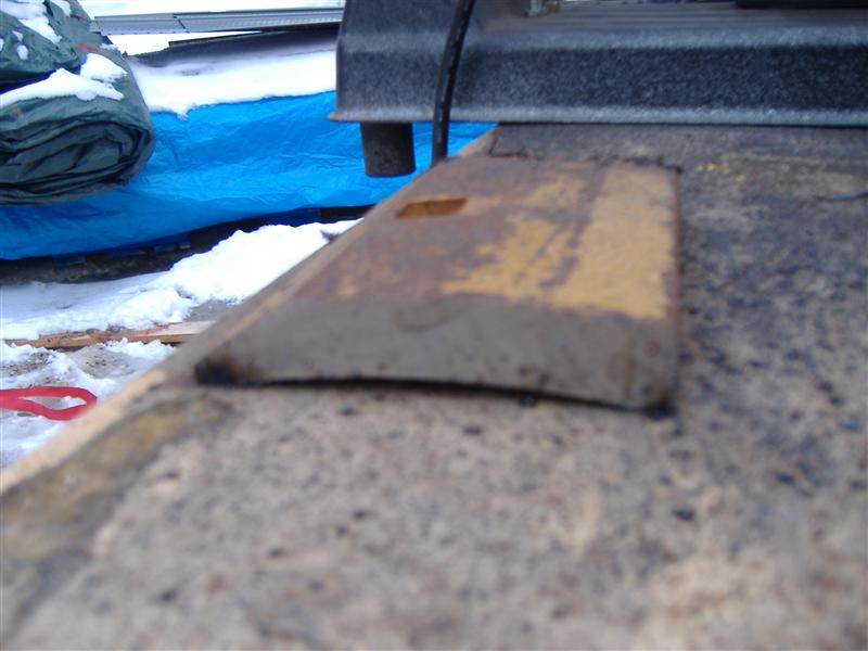

YukonKing,

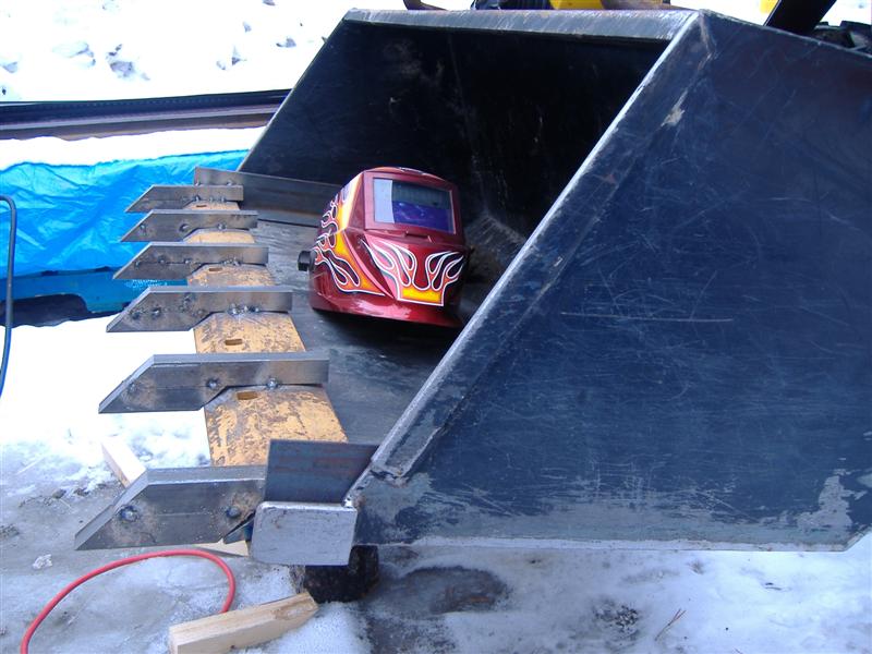

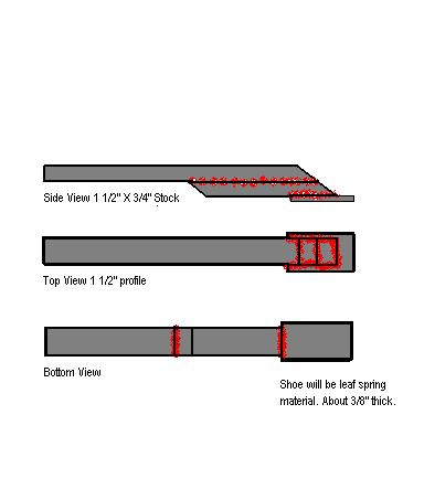

A few years ago I needed to get a toothbar for my tractor but did not want to spend the $300.00 for one either. While working in my shop one day I noticed a stack of leaf springs and the idea hit me. Springs are made of some tough metal. I disassembled the springs and cut them apart using a metal blade in a skill saw. I used 3/4 inch bar stock and three pieces of leaf spring to form a wedge shaped tooth. I cut holes in the leafs to bolt to my bucket and welded together. After making each tooth the next was a little different design so they are not all identical.
When I put these teeth to the test the spring material kept snapping near the welds when backdragging. I would reweld but the breaking would occur again. The problem was due to the spring metal becoming brittle near the welds. The springs (teeth) needed to be tempered. I wanted to heat the metal to 500 to 600 degrees F and hold there for a while. I thought of cooking them in the kitchen oven with it in the self cleaning mode. Instead, I used the gas grill with it turned on high and cooked the teeth for about an hour then let cool slowly. Since then I have not had any breakage.
If I were going to buy old springs from a salvage yard, I would buy ones from a large truck like a dump truck. Mine are smaller since them came off of a 1/2 ton truck which I had taken the axle from. You might find used springs at a truck spring shop. I hope this helps.

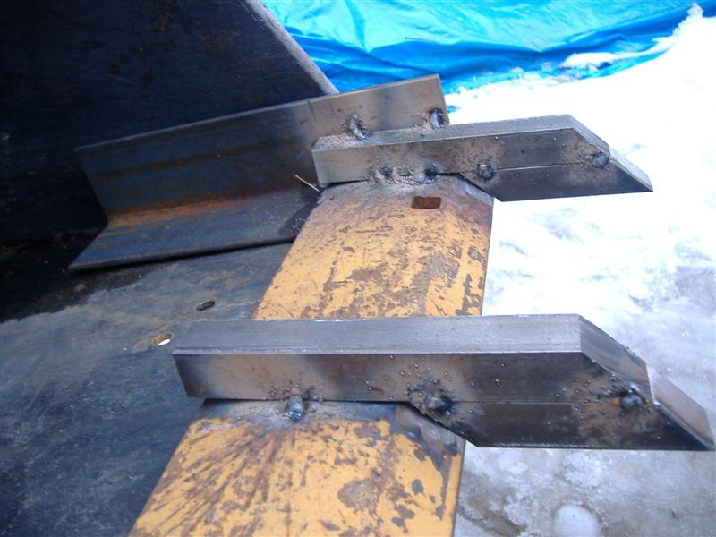

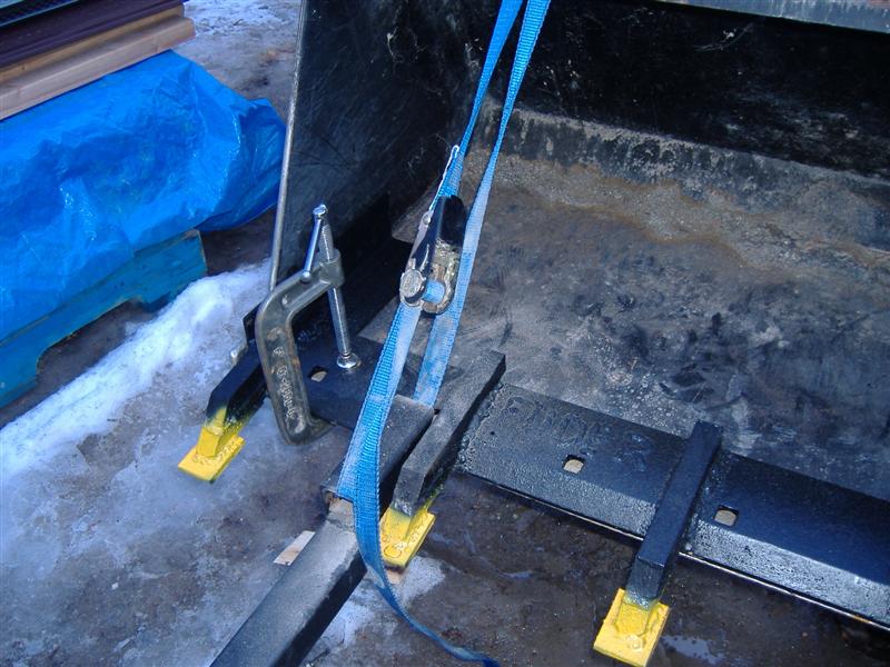

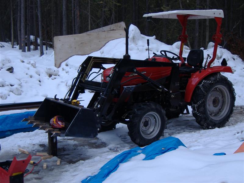

Ok,
So I'm resurecting this old thread. Yesterday I started building my tooth bar.
So far everything is tacked together. I'm using a tinny winny welder to tack with so the welds look like crap, The bar stock was exchanged for 1" solid square stock as in the drawing. I will get some pictures up later today.
So far I looks good.
YukonKing

/ Bucket Teeth/Home Made? #19
I like this. Using the leaf springs and tempering them is a great idea.
Yukon, you might want to think about putting a flat bar inside to add some strength, or even underneath the front lip.

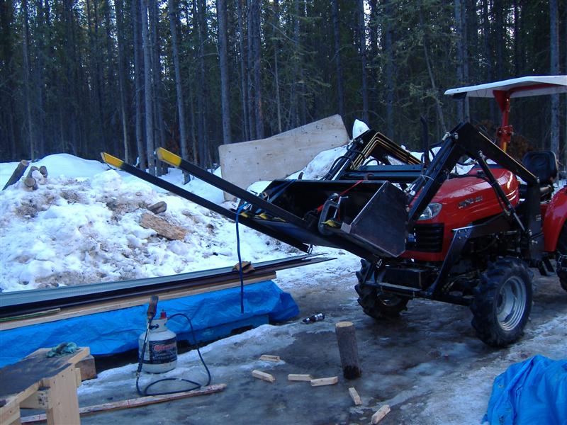

ok,
so made some forks too. total cost 100$.
