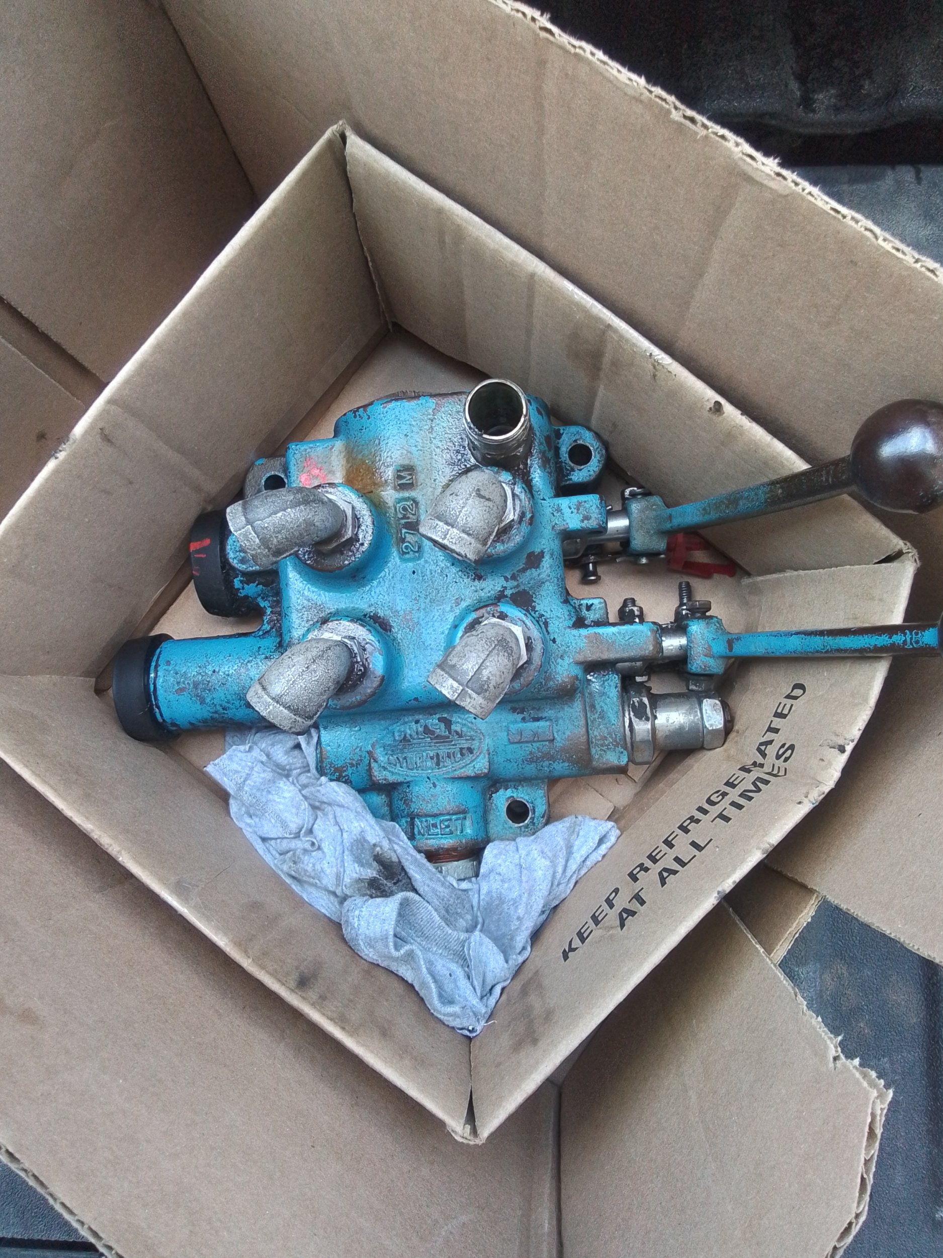

   / Bucket partially dumps when raising the loader...
#9
So here's what I'm working with. This dumping issue is something new so I don't think it's safety related. Maybe taking this unit to a local hydraulics shop will get me some answers. Or maybe it's just time for a replacement. The linkage on the levers are awful ovaled and sloppy anyways. Guess I'll see what the hydro shop says.

   / Bucket partially dumps when raising the loader... #10
I'd be surprised if the advice from the dealer's shop can match the expertise from the members here who have commented.
You now know for sure that the cylinders are good. So be wary if that it is suggested otherwise.
I don't know that particuar control valve or even the tractor. So can't help. I'd be surprised if it had regeneration or load leveling. It might not even have load checks. The less expensive control valves do leak internally and have none of those features.
Brand new control valves are available all over the internet. They are a universal part. The group here can help you specify a replacement. Prices run several hundred dollars and up...depending on quality. Dealers often charge much more for their identical control valves.
