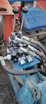

I would not waste my time trying to get that valve fixed. It doesn't have load checks and it is two lever. Get a joy stick valve, you well like it a lot better if you match the valve GPM with the tractor.

So here's what I'm working with. This dumping issue is something new so I don't think it's safety related. Maybe taking this unit to a local hydraulics shop will get me some answers. Or maybe it's just time for a replacement. The linkage on the levers are awful ovaled and sloppy anyways. Guess I'll see what the hydro shop says.
Are those galvanized pipe elbows in that picture of the valve. If yes get rid of the galvanized fittings since it will flake off and contaminate your system. Other problem is they probably are not rated for your system operating pressure.
Since new problem could be spool not centering and a good hydraulic shop should be able to fix that or at least test it for a minimal fee.

Well, this is what I ended up with. It definitely fixed the problem. I was considering to have the old valve assembly inspected/ repaired but time was the biggest issue. I have a project waiting so this replacement was the best option. The 2 lever was cheaper than the joystick and what I'm already used to so I stuck with that type. All in I was 380.00cad. That's about 200.00 for you boys!!!
Thanks again for the advice and testing tips. It's very much appreciated. 🍻
