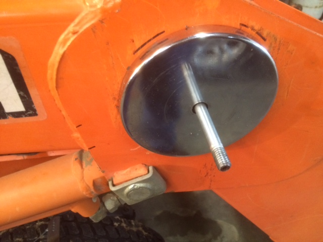

This shows the addition of a delrin (plastic) bushing which serves as a low friction/low wear pivot for the pointer and quadrant. The bushing is just slightly longer than the thickness of the pointer and quadrant combined so that the 3/8" hexnut will clamp it (the bushing) against the white pointer to keep it from moving while leaving the pointer and quadrant free to pivot.

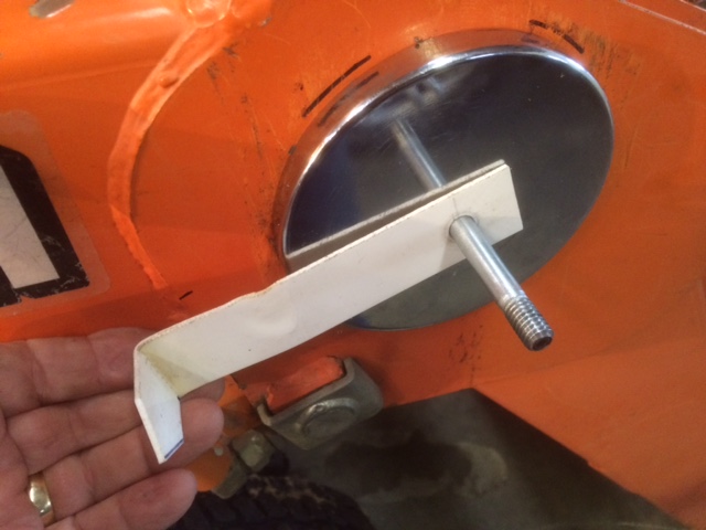

#22
This shows the addition of the metal pointer with it's lever arm at 90 degrees where the 1/16" cable is attached. Also shown is the attachment of the cable via a small magnet on the loader frame at about 4" below the loader arm pivot. I used small magnets with internal threads for a setscrew as shown to clamp the cable. Drilled a cross hole for the cable to pass thru. Makes for an easy adjustment of cable length and magnet position when calibrating the system.
You may notice an extra piece of flat metal attached to the backside of the pointer near the outer end. This is simply additional weight to keep the cable taut.
The metal pointer rotates clockwise as the loader arms lift The quadrant rotates clockwise when the bucket is tilted down. This is how level is achieved-by aligning the two elements. The bucket can be pre-leveled to what will be its level position while still "in the air" by aligning the metal pointer with the yellow reference mark on the quadrant. This speeds up bucket leveling while returning to the "pile" and before the boom is lowered to ground level.

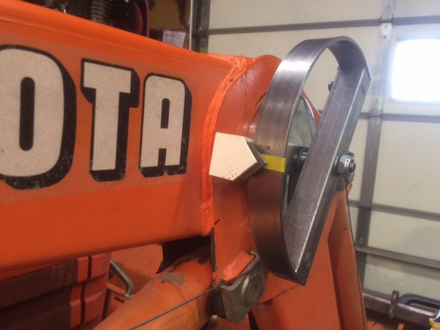

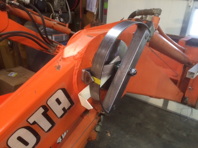

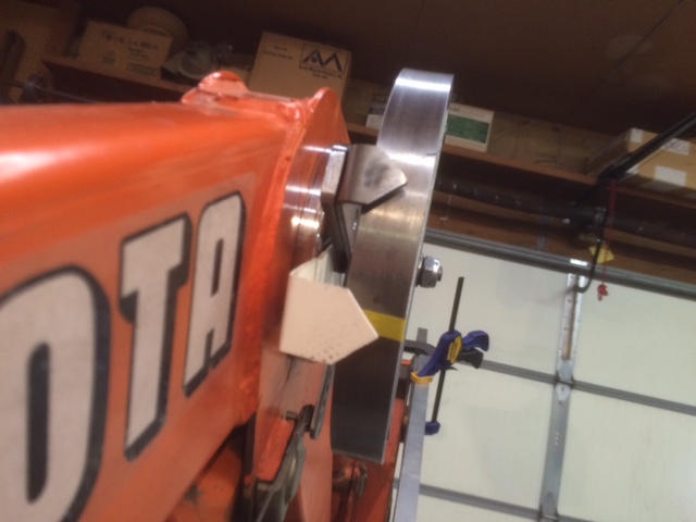

This shows the addition of the quadrant. I formed the curve out of 1/8"x1" metal using a quick and dirty form block of MDF somewhat smaller than the 4" inside radius of the curve to allow for springback.
The cross member is 1/8" x 1" square tubing with holes drilled in each end to accept a 1/2" diameter pin which is cross drilled and tapped 1/4"-20 to accept the flat head screws that hold it all together.
The square tube is also drilled and reamed .750 (3/4") diameter in the middle to accept a press fit spacer bushing with 1/2" ID which serves as it's pivot on the delrin bushing.
The inner end of the upper 1/2" pin is drilled and tapped 10-24NC for attachment of the cable using a 10-24NC screw with a tiny 1/2" OD bushing on it. The cable (going to the right in the picture) is attached between the front pivots as shown. (Rather than the bucket itself)
The first pic shows "ground level" position where the white pointer, the metal pointer and the yellow on the quadrant all lined up.
If pre-leveling the bucket position is desired prior to dropping the boom to the ground--tilt the bucket to align the yellow on the quadrant with the white pointer. The metal pointer will then align with the other two as shown when the boom is dropped to ground level.
