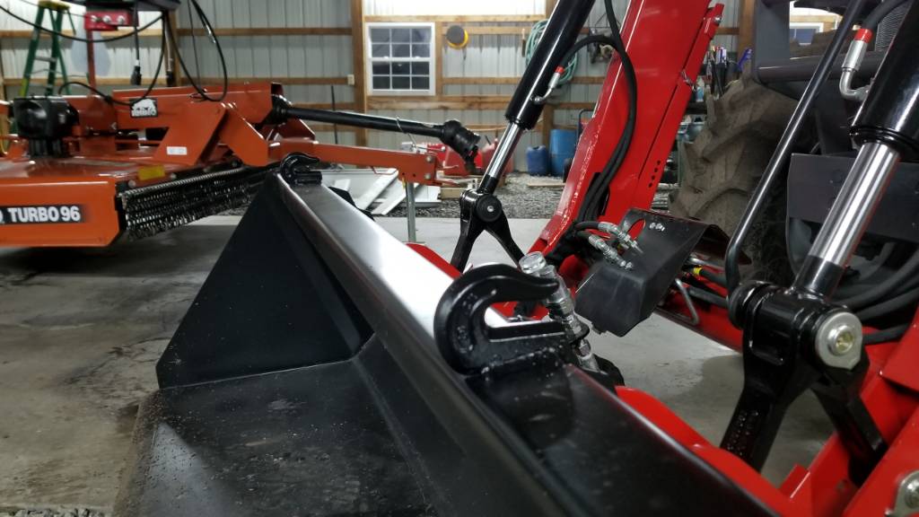

Since I can't weld, I went with the old Bolt-on Hooks from Ken.
/ Bucket Hooks #66
As Dale stated, above, Ken's Bolt on Hooks. They are very easy to install because you are talking to someone that is mechanically challenged. My wife hates it when I try to start a project cause it always cost her more money than just having a professional come in and do it.
So, if I can install them, anyone can.

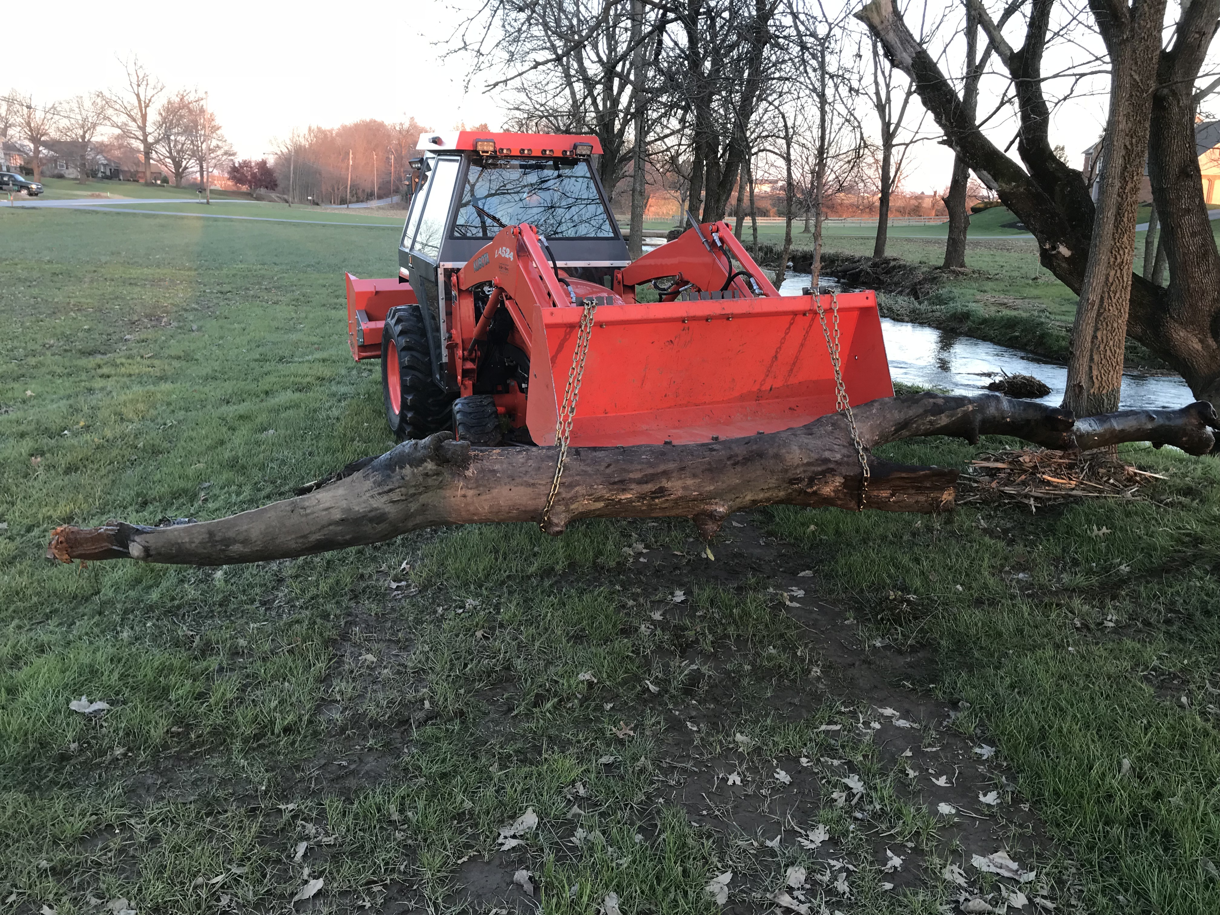

Oh you don't give us any credit for stupid tricks!
I have the BXpanded clip on hooks and they work great but expensive! Very handy because you can move them in seconds. I was looking for an abusive action shot but here is what they look like...
