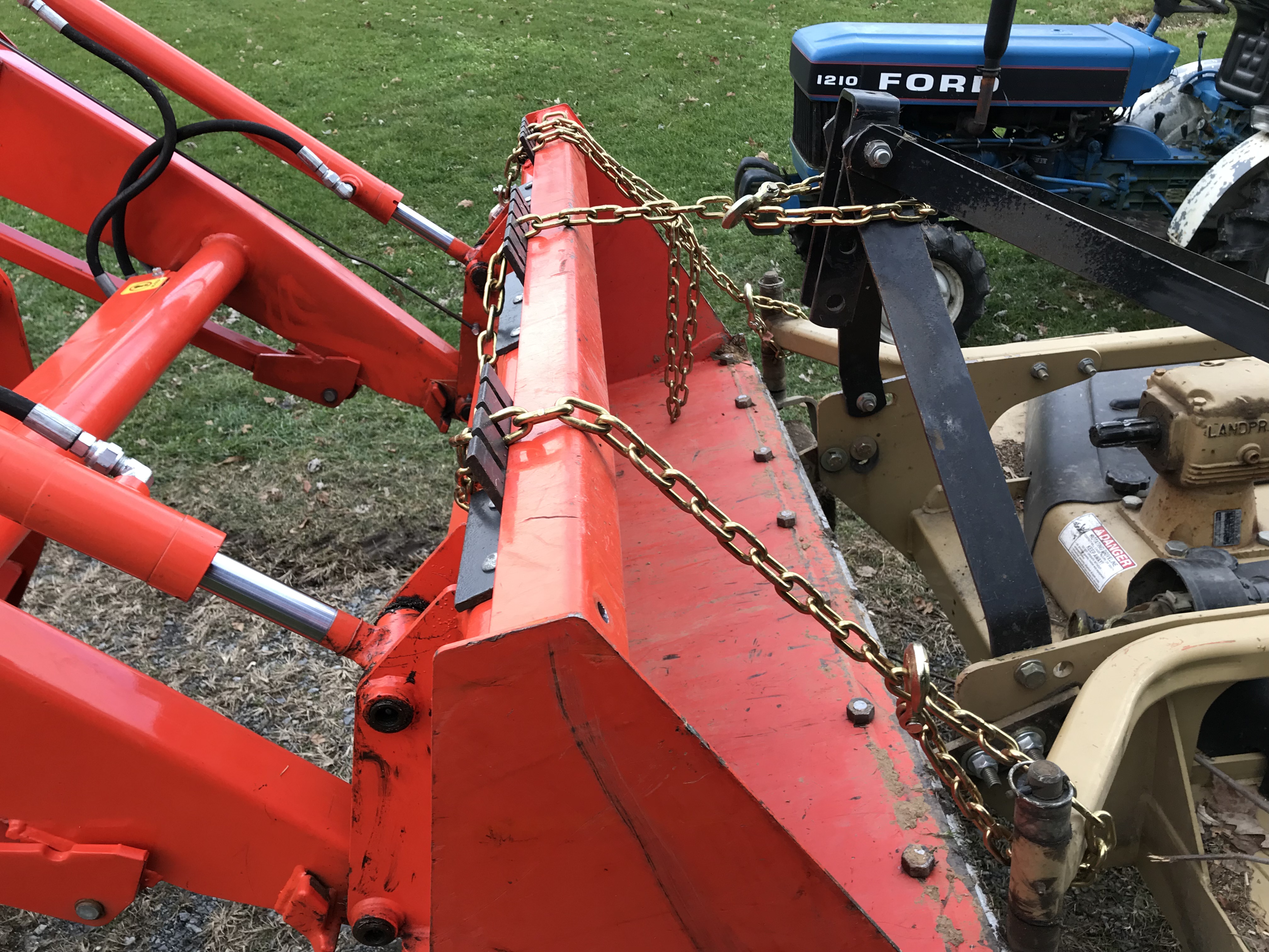

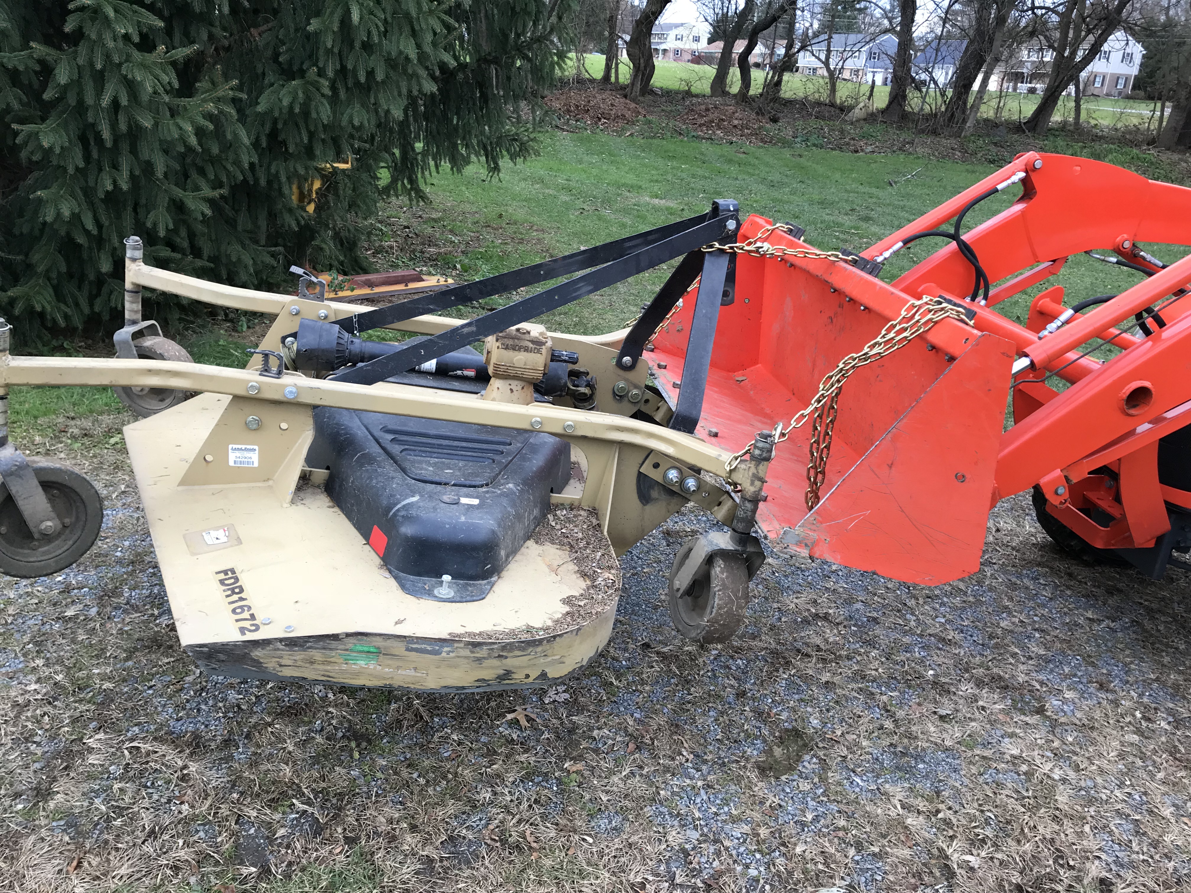

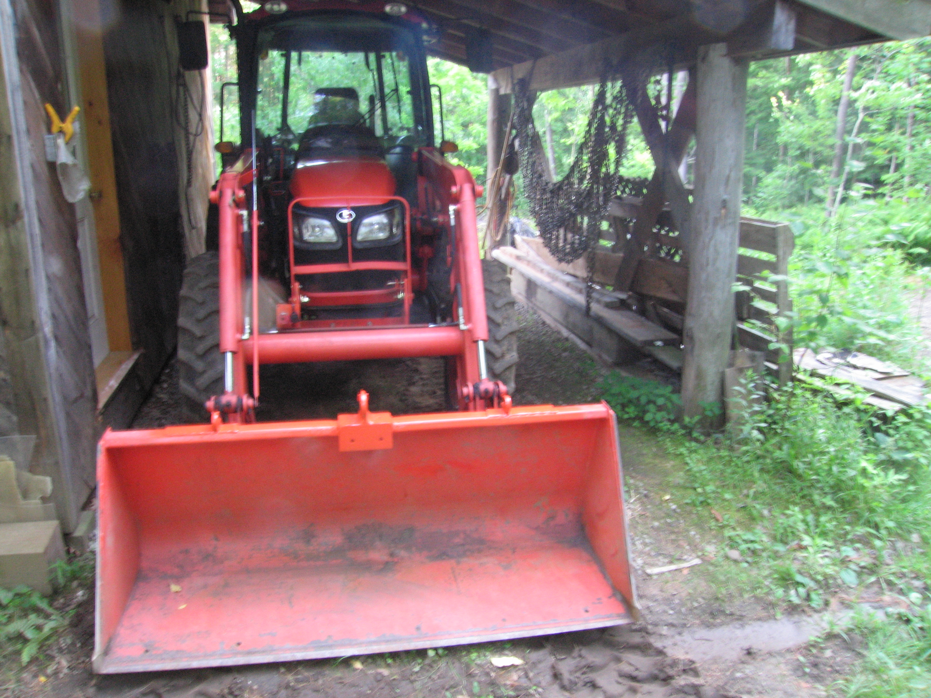

Everyone needs and loves bucket hooks. I've had this tractor a couple years now. The guy I bought it from had just one bucket hook. It is in the center. A little hard to use for a lot of things so I finally put hooks on the ends. After I welded the first one on backwards (Duh - I have an excuse but it is pretty lame.) I decided to just go with it and put a second one backwards in case I ever want to hang chains off the back of the bucket. So I ended up with a reverse pair and a forward pair of hooks plus a pair of lugs for a 1/2" shackle. The first chance I get I will use the backwards hooks just to make me feel better.
gg
It looks fine and purposeful- like when you don't want the loose end of the chain dangling in the bucket.
/ Bucket Hooks #42
You did it that way to minimize leverage from a heavy load. Dropping a chain behind the bucket allows you to pick up closer to loader pins!
Everyone will say you’re brilliant!

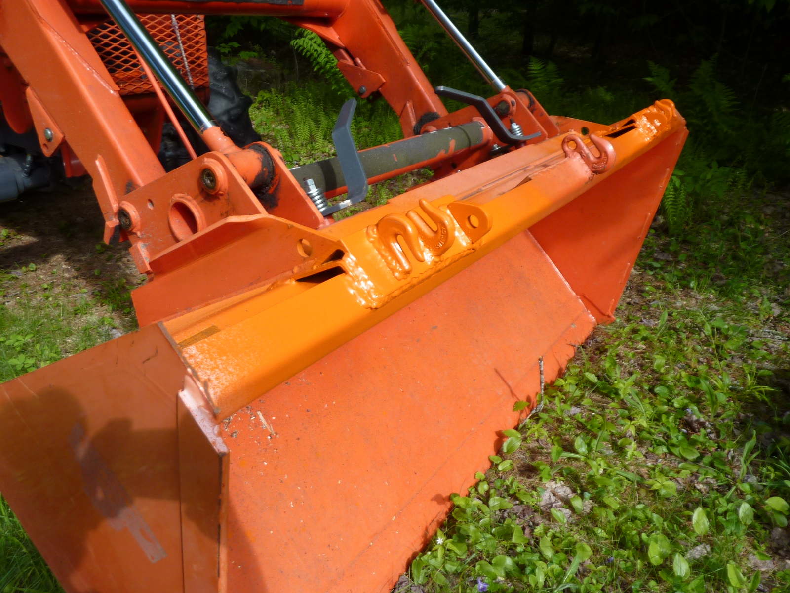

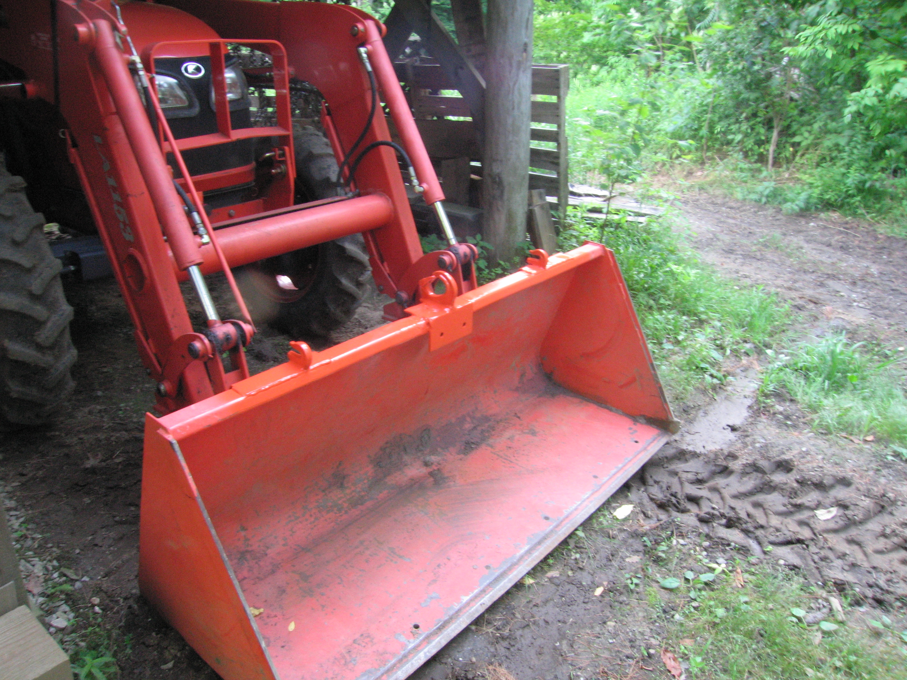

Is it pretty standard practice to weld a plate onto the top of the bucket, then weld the hooks onto that? Versus just welding the hooks directly onto the top of the bucket?
/ Bucket Hooks #47
It depends on how sturdy the top metal appears to be. Many loaders will profit by having a reinforcing plate welded on first to keep the weld from tearing out. But is unneeded on some others. In my case there was a piece of reinforcing metal already welded in place from the factory to weld hooks on to, so I did. The pix of the gray Kioti bucket shows that metal piece. The modified Kubota bucket has a piece of metal all across the top I put in myself

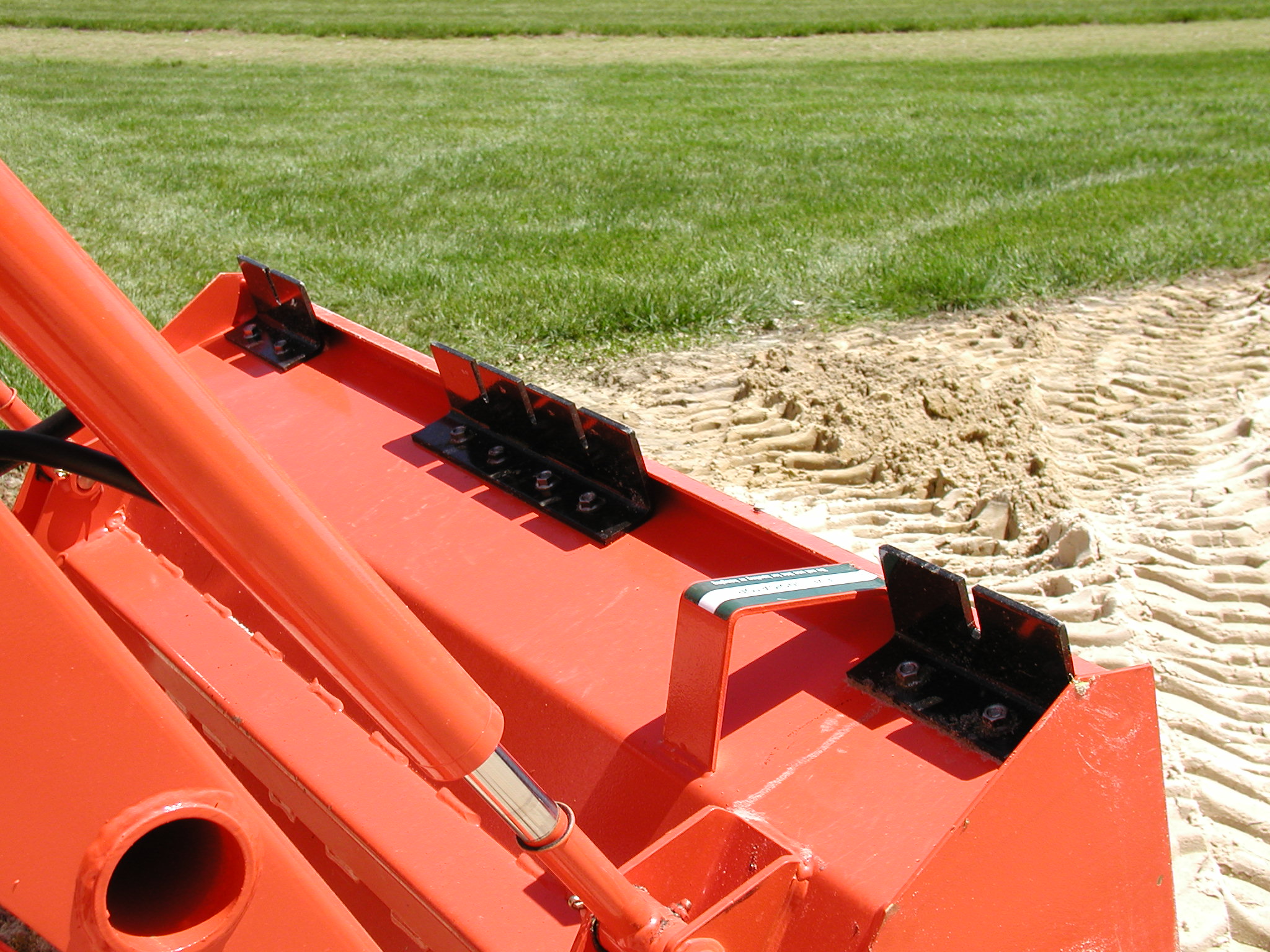

Yesterday I bought an old side discharge Caroni 5' RFM to replace the one on the Ford. The seller had an L3130GST he used to load the deck on my trailer. I had taken my own chains, but his bucket had only a bare edge to hook the chains on. The experience made me glad I don't live with that setup. Buckets should have some means of connecting chains to them. My BIL has Ken's hooks and clevis mounts on his L4740HSTC and they're the ticket if you're not into DIY.

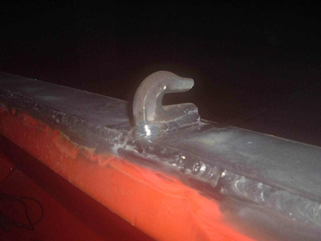

I am about to weld that same setup on my bucket after the single grab hook that I had mounted in the bucket center broke off when a log I was dragging hung up and popped the hook off. My poor novice welding was likely to blame

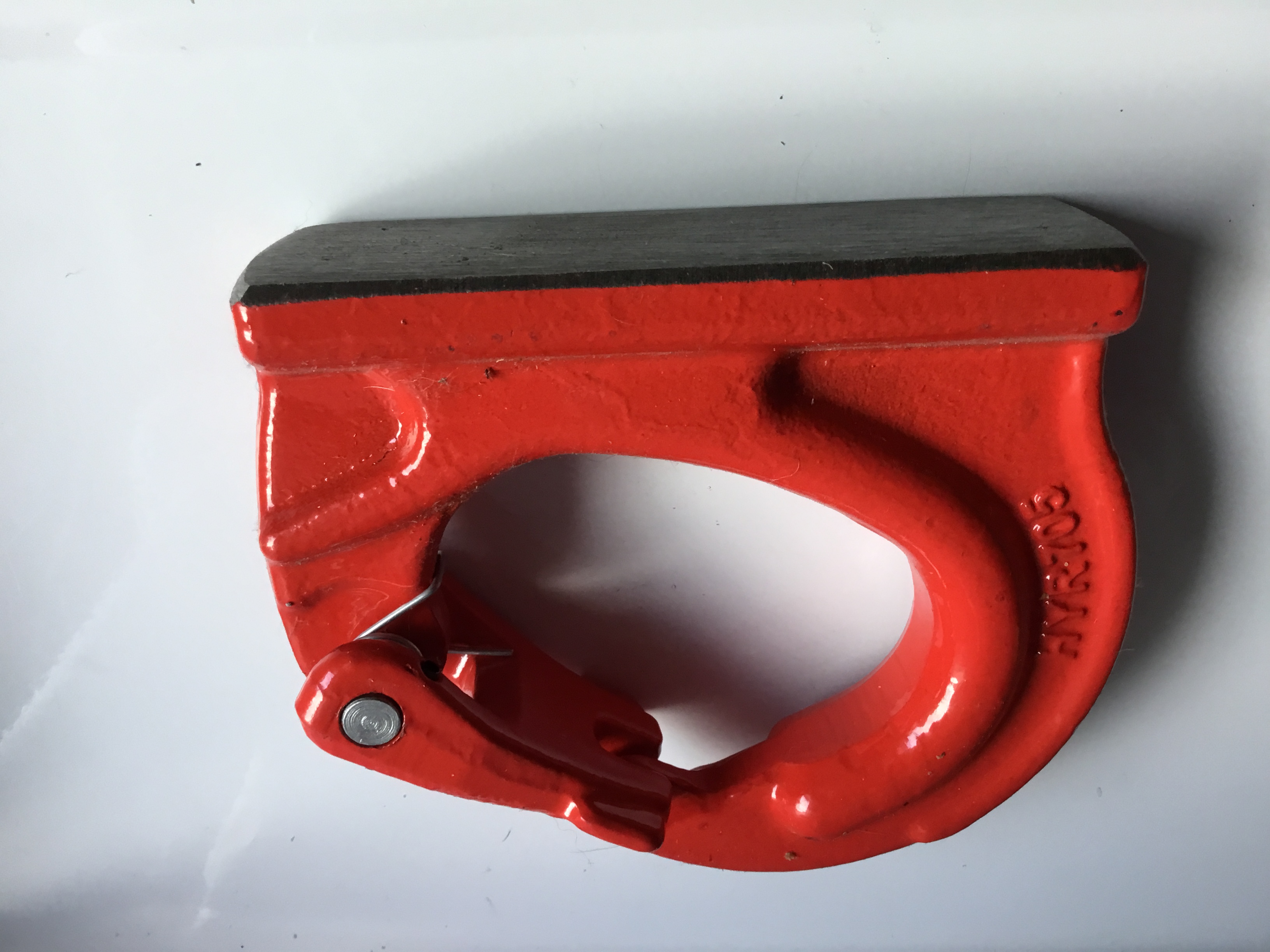

Here is a slip hook with keeper that I am going to weld on the center of my small bucket. I will also mount a grab hook on each side of that bucket.
