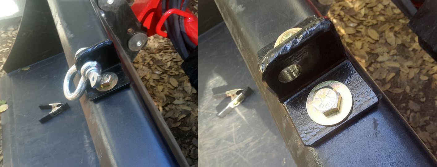

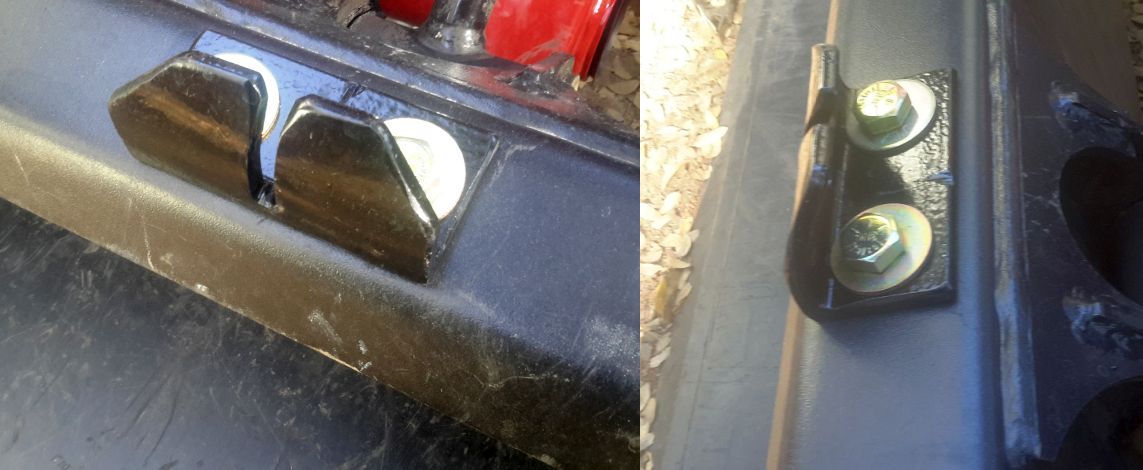

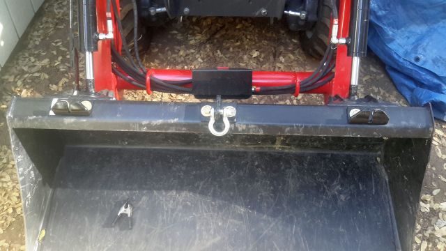

This is what I did for bucket hooks...Thought long and hard about adding "bolt on hooks" and just could not seem to make that purchase...
Materials are 2 x 2 x 1/4 steel angle and all bolting materials are 1/2 inch Grade 8... Slots were drilled 5/16 about 1/2 inch from edge of angel (targets for saw work) and hacksaw was employed to cut slots... Angles were also heated and curved over a bit for for better chain retention (I hope)...
Center "eye" is two pieces of angle welded back to back to form inverted "T" and drilled 11/16 for 1/2 inch shackle... Funny part is 1/2 inch shackle has 5/8 pin...
Since bucket materials is actually thinner than brackets I have no fears in brackets failing, my only concern will be not bending bucket lip....
And if you were wondering spring clip holds tarp in place when tractor parked...
Dale

I like the chain slots. I welded large angle iron across about 4 feet of the bucket with 6 or so slots cut in on my previous fel.
Slots are very convenient.

Nice job.:thumbsup: Great idea using chain slots, perfect!
/ Bucket Hooks #4
Very nice

Just curious and I really like the work you did,, but why bolt and not weld? just asking.
/ Bucket Hooks #6
I used Kens bolt on on my GC, the top of the GC bucket is pretty rugged and doesn't need any added stock so the bolt on work just fine.. I have lifted 600 lbs with them and they work great..
/ Bucket Hooks
Just seemed the right thing to do, if one fails its easier to replace....
Maybe its a trust issue with my welds at high stress points though I really have not had any fail...
Dale
/ Bucket Hooks #9
I like the chain slots too. :thumbsup:
No experience with them but I would think they would be easier/more convenient than the bucket hooks I have, since one could come straight at them vs. having to bend the chain 90deg to secure.
/ Bucket Hooks #10
LOL the title should be “Bucket Slots”, not hooks!
Good job :thumbsup:
/ Bucket Hooks #12
Your slots are a great idea - nice work too. I like RjCorazza idea too with a row of slots. I have a tooth bar and I'm always using the teeth to position the chains from my two bucket hooks. If I didn't have that tooth bar a row of slots across the bucket would be a mighty convenient way to position the chains.

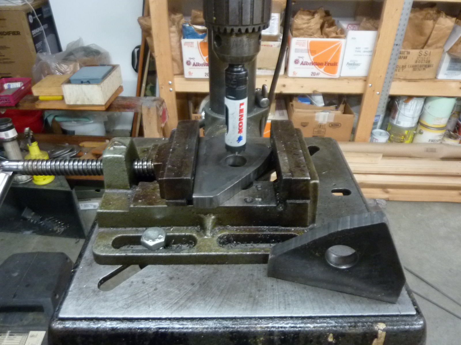

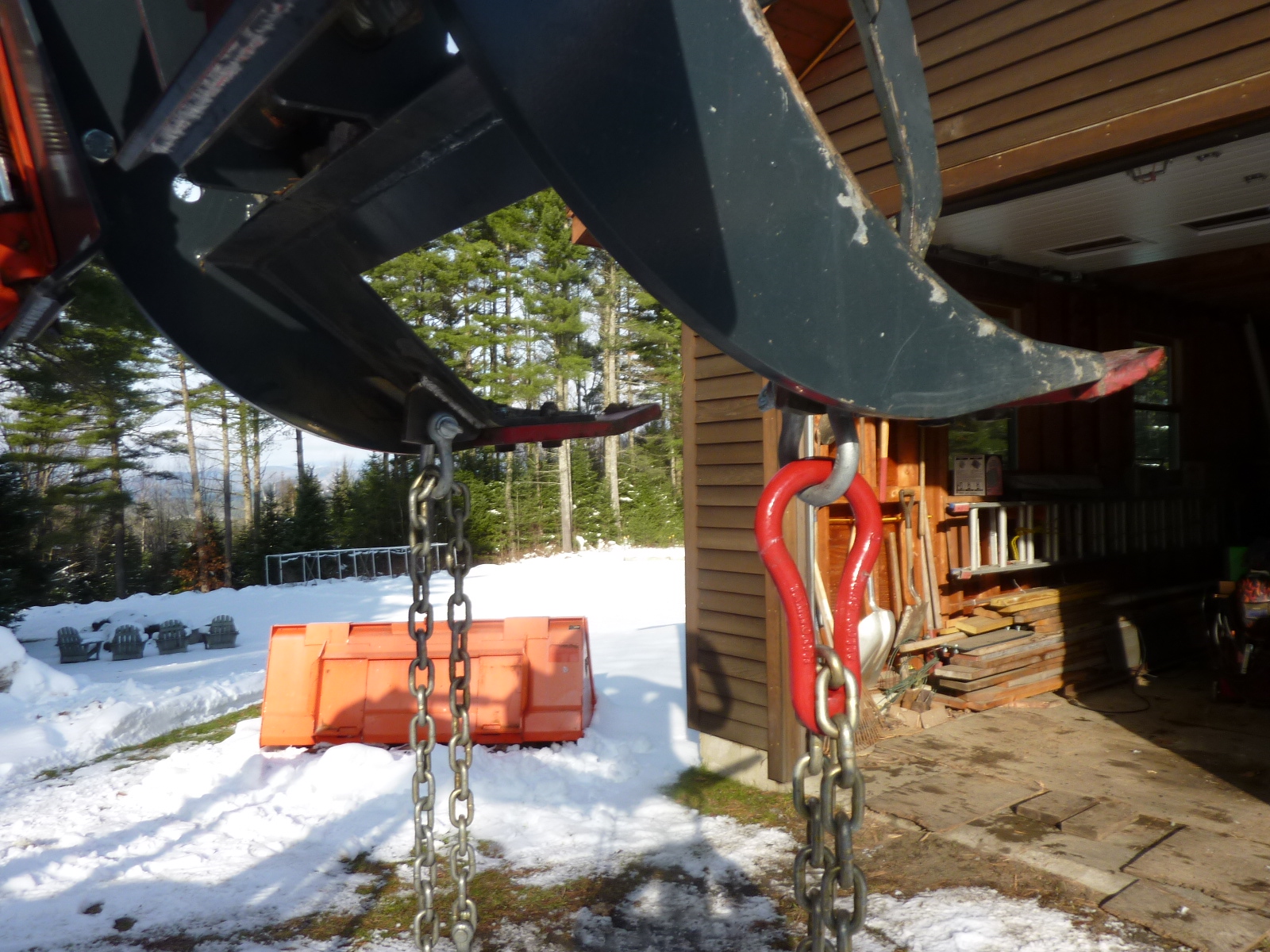

I needed a good chain connection on the tines of my log grapple. I was going to just drill a couple 3/4" holes and use a shackle. I didn't know what the steel was but when I tried to drill an 1/8" pilot hole with a hand drill and a good bit I found out it was Kryptonite. A definite no-go with a hand drill - for me at least. Thought about burning a hole but my torch work is a little crude for a 3/4" hole. So I made a couple 1/2" weld lugs instead.
Now I have a slip connections with just the shackles or I can add a grab links big enough to pass a hook thru to get a grab connection.
