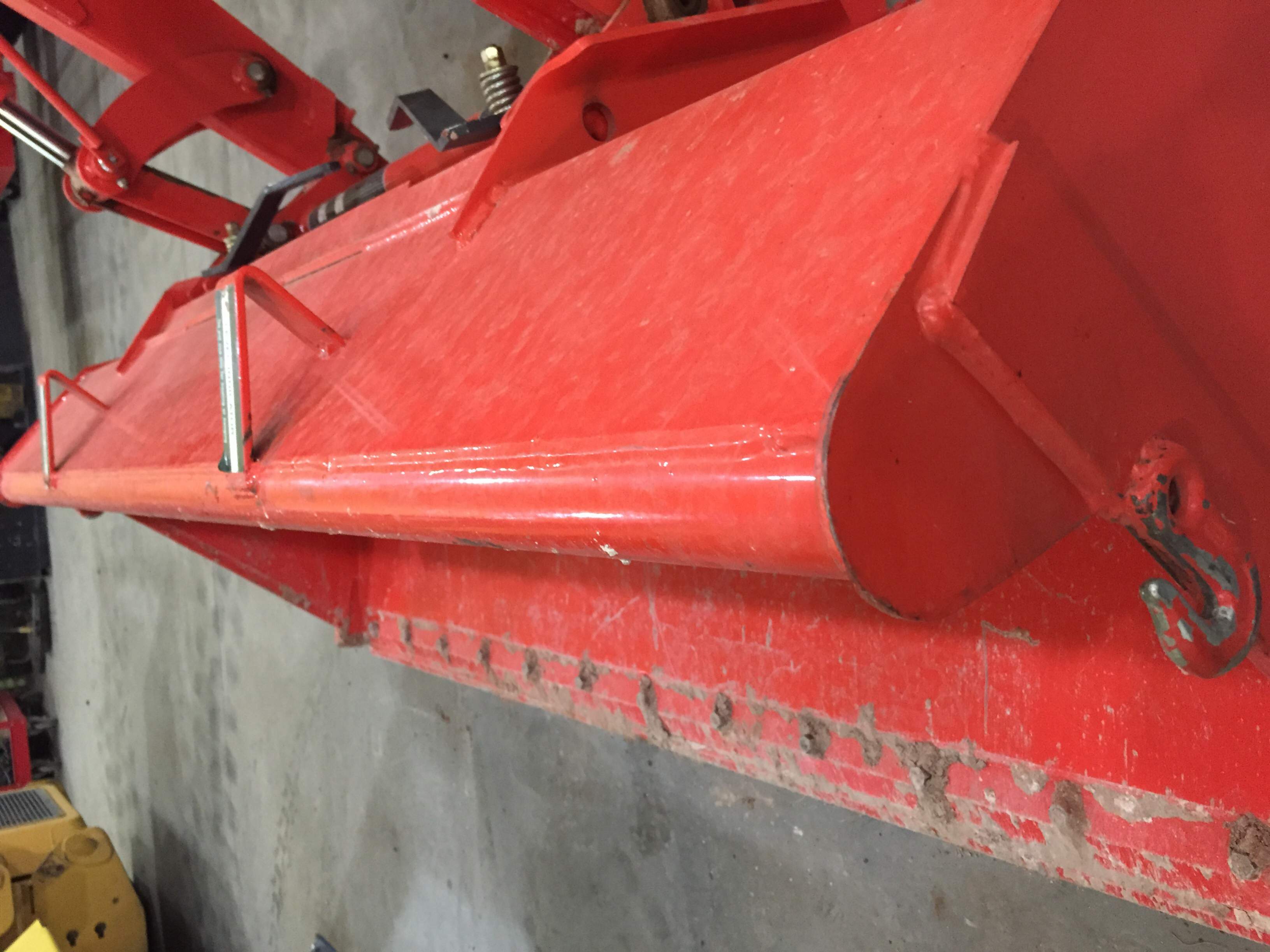

I am wanting to put some hooks on top of my bucket. The top however is unlike any I have seen. The top edge is a pipe which leaves no flat surface to weld to. I am sure I can figure something out just curious if anyone has already mounted them on something like this and had ideas to share.
The hooks on there in the pic were put on by the previous owner. I am taking them off I don't like hooks on the edge it is easy to bend things

These are what I used.
New 5 16 Weld on Grab Chain Hooks G 70 Bucket Trailer | eBay
The flat back with the beveled edge is ideal for welding on nearly any surface. The way they are made you could likely weld them to the flat area just behind the pipe with them extended up some and build a weld between the upper edge of the hook and where the pipe begins to round.

Weld least 1/4" angle iron top of roll and bucket.
/ Bucket hooks on round top bucket #4
Since you will be using the hooks for chain they do not need to be right on the rounded edge of the bucket. Just move back of the rounded edge to where the metal is flat and weld away. Depending on how thick the bucket metal is you may have to weld a small back up plate on the inside of the bucket opposite of the hooks. I just bought and installed a bolt on set of hooks for my NH T 4.75 and could kick myself for not doing it years ago. The hooks are a world handier than wrapping chain all the way around the bucket.

Thanks for the recommendations, but the Bolt On Hooks are not compatible with these round-topped buckets. Welding just behind the round tube seems to be the best choice.

I have the HD round bucket also. When I bought the tractor the dealer recommended the edge as the best place. My hooks have been there for 15 years and I have picked some very heavy stuff on the hooks. I have never bent them digging either. Mine are a little higher than yours.
Go ahead and add some on top but I doubt if you will bend the ones you have if you leave them on.

You could weld a short piece of shallow channel along the tube to give you a flat to weld or bolt on a hook'

Thanks for the replies guys. Many good ideas. I really don't want them on the flat part because they will be angled such that chain can slip out. Not an issue when you have weight hanging from it but I would prefer to have gravity in my favor especially when trying to use the hooks to secure things in the bucket.

I'd just weld on the back below the curve on the flat area closest.
For sure with the curved top edge you wont kink it with heavy loads.
Your only concern could be tear out if thin metal. To prevent that first weld the hook to a , say, 3 X 4 inch 1/4" plate and then the plate to your bucket.
Another solution would be the bolt on hooks sold on TBN with an inner backer plate.
Your best location for safe lifting is center of the bucket.
