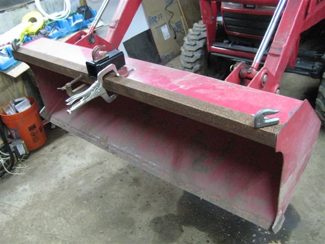

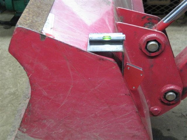

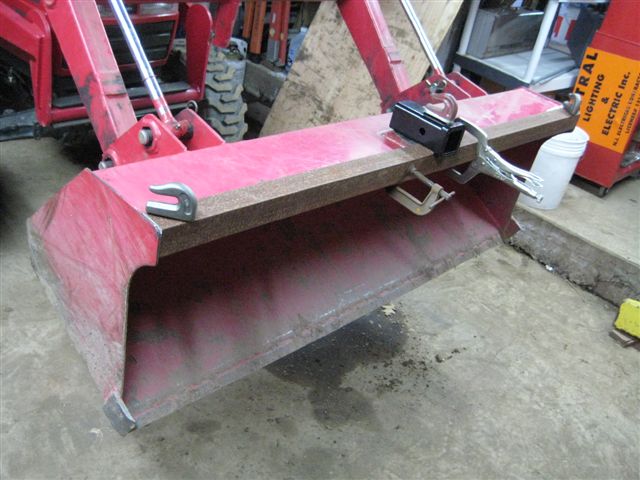

Previous owner had 1 hook on the center of the fel bucket. So I can move my trailer around with the BH on the tractor, I'm putting a hitch reciever center of the bucket. Spent this evening cutting off the old hook and preping a few angles for the new hooks, hitch and some level indicators like the kubotas come with. Going to weld them on tomorrow after work.

I mounted hooks with the center hook on top of a receiver tube (hitch) just as you have planned. I think you will like this set up, it has lots of flexibility. You can move trailers and mount any accessory that you can weld onto square tubing (a slip hook for rope or sling, a vice, a small work table, etc.) good luck.
/ Bucket Hooks/Hitch/Level Indicators #3
You should weld those hooks "in-line" with the arms of the loader, not at the outside edges of the bucket. This is the strongest point, if you position them at the outside edges, you are at a higher risk of twisting your loader/bucket.

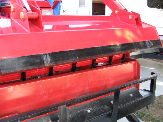

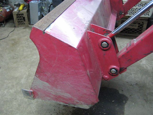

Welder my hooks at the loader arm locations as suggested by many. Welded a 1/4" 3"x2" - 59 1/2" angle iron on the top lip before the hooks.
Scrapped the idea of welding a receiver tube on the top of my bucket and bought a scew down lower lip receiver tube found on e-bay. It was 56.00. A couple of my trailer tounges are fairly low and you would have to tilt the buckey top way down to try and get to them. I never tired it tho.

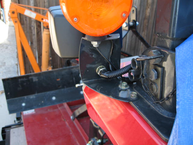

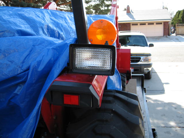

Attached is a picture of my bucket hooks welded at the loader arm locations. Also added a work light for snowblowing. On my Mahindra they was a hot wire on the right side of the seat by the ROPS.

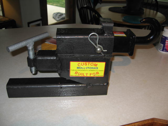

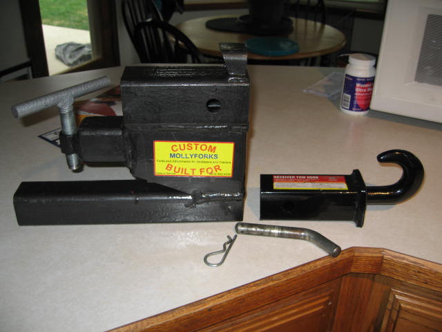

Pictures of lower bucket lip receiver hitch attachment. Mollyforks

Nice work. That clamp on reciver ought to do the job. Looks heavy duty. By the way, if I brought that in the house and plopped it down on the counter top the wife would crap a blue bean....:eek:

What happened to the bucket level indicator that came with the loader?

The receiver lower bucket clamp was bought on e-bay. It couldn't go take the time and now gas and find all the pieces parts for 56 dollars. I wish my welds were like that. ha

As you curl forward or backward, the indicator rod moves up and down in its cylinder. At the point it is flush with the top of the cylinder, your bucket should be resting flat on the ground.
