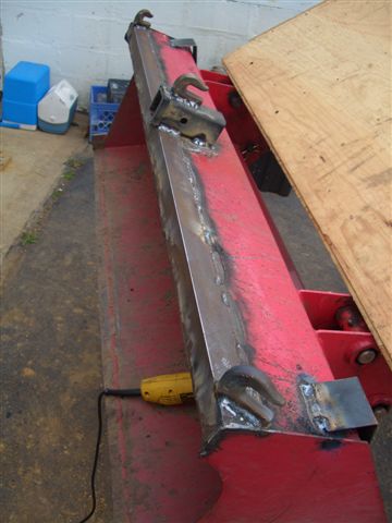

Got to try them out today. My welds are holding and I didn't even bend the angled hooks.

/ Bucket Hooks/Hitch/Level Indicators #46
Looks very very good. Thanks for starting the thread!!!

Here's my 2 cents. I appearently went about my hook welding and upgrade all wrong because I didn't ask anyone how to do it. First I cut 2 pieces of 5/16 steel 2 x 3 inches, then welded hooks angled toward center of bucket. Then took and welded plates with hooks attached 3" in from edge of bucket and 3" out from outside edge of loader arms, due to that's where I felt the strongest point was. I then proceeded to weld a 3/8 clevis hook to same size plate and then center of bucket. At that point I spray painted black to match bucket. Project done. In my testing phase I hooked 3/8" chain to hooks and centered on my Leinbach 7 rear blade around 400 lbs picked it square on LEVEL GROUND IN CONTROLLED ENVIRONMENT no problem. Last week I loaded railroad ties on my small trailer, they were longer than trailer so I rested them on the top rail on the tongue end of the trailer about 20 degrees. When I arrived at home I got the tractor out hooked a chain to uneven ties and began to raise off of trailer. Tie swung due to load not being level and jolted the tractor pretty good, but no harm done. I would not have attempted this type of lift with more than three hundred pounds due to this is a small machine. Moral of the story my hooks held and did not bend or fail, loader arms and bucket are not bent and nothing on tractor broke. I'm pretty sure regardless of where hooks are placed that damage can occur if one is not carefull and tries to ask more of a machine than it's capable. In a dynamic load condition of hard swing or unanticipated load shift damage will occur at some point during use regardless of hook location or application.
