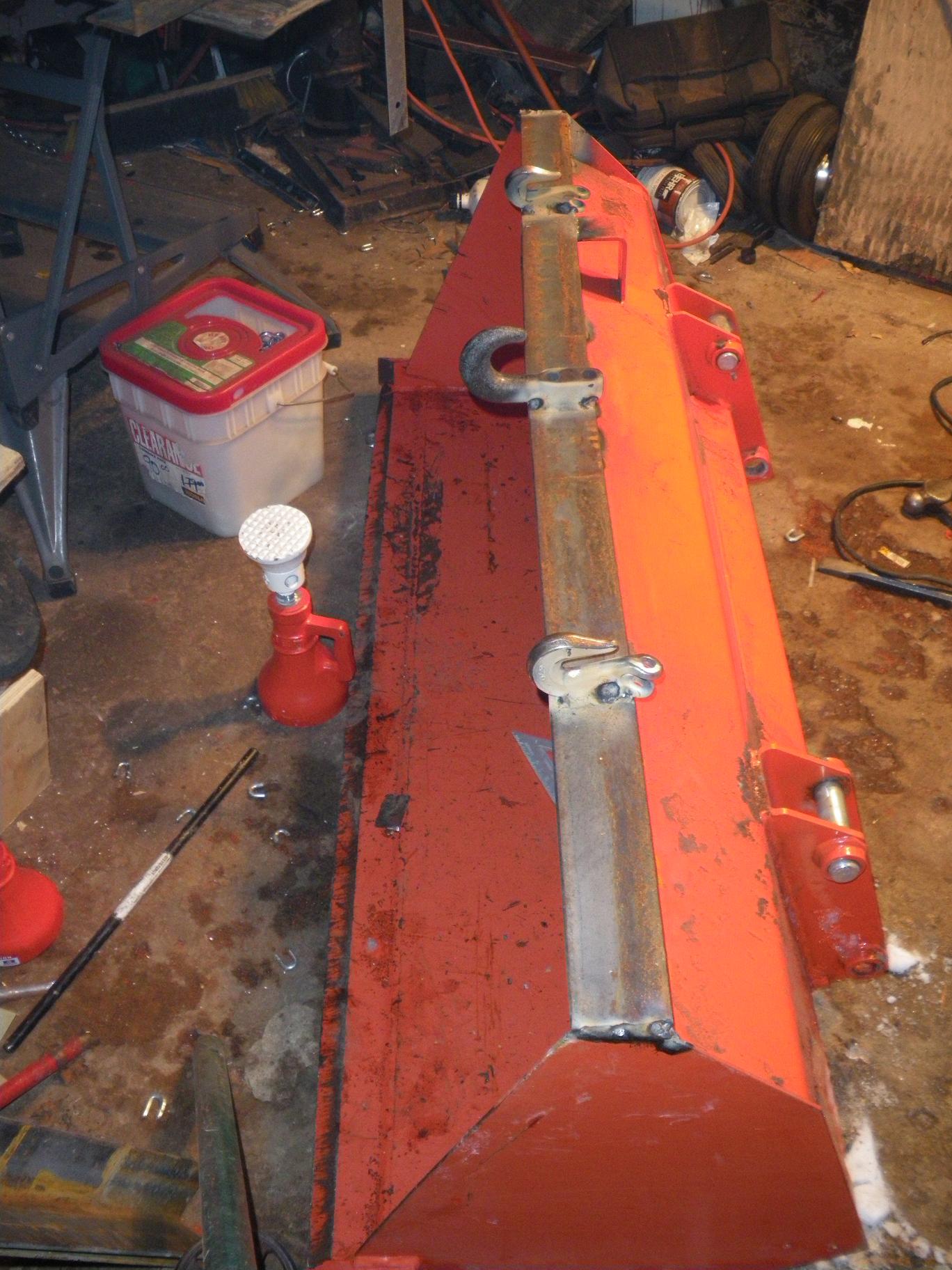

I thought I had a picture of how I had our loader buckets setup but evidently not, I do have a picture of how I set my skid steer bale movers up and it's almost the same as our loader buckets. Like the others are suggesting I weld a 3/8" grab hook in front of each loader arm but then in the middle of the bucket I weld in a big D ring under the top lip. The D ring makes a very nice place to run a chain when when hauling on a trailer.
I used to think the slip hook in the middle of the bucket was a good idea but I found that tree branches got stuck in them way too often when pushing brush, it can still happen with the grab hooks but not nearly as often.

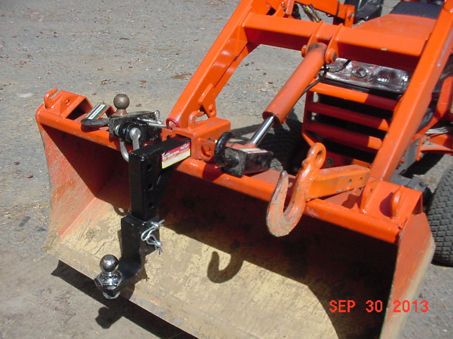

Here is where my four hooks are welding on my stock 72" general purpose bucket.

Can anyone point me to a prior discussion on mounting a 2" receiver on the bucket of a FEL?
/ Bucket hook weld on points #31

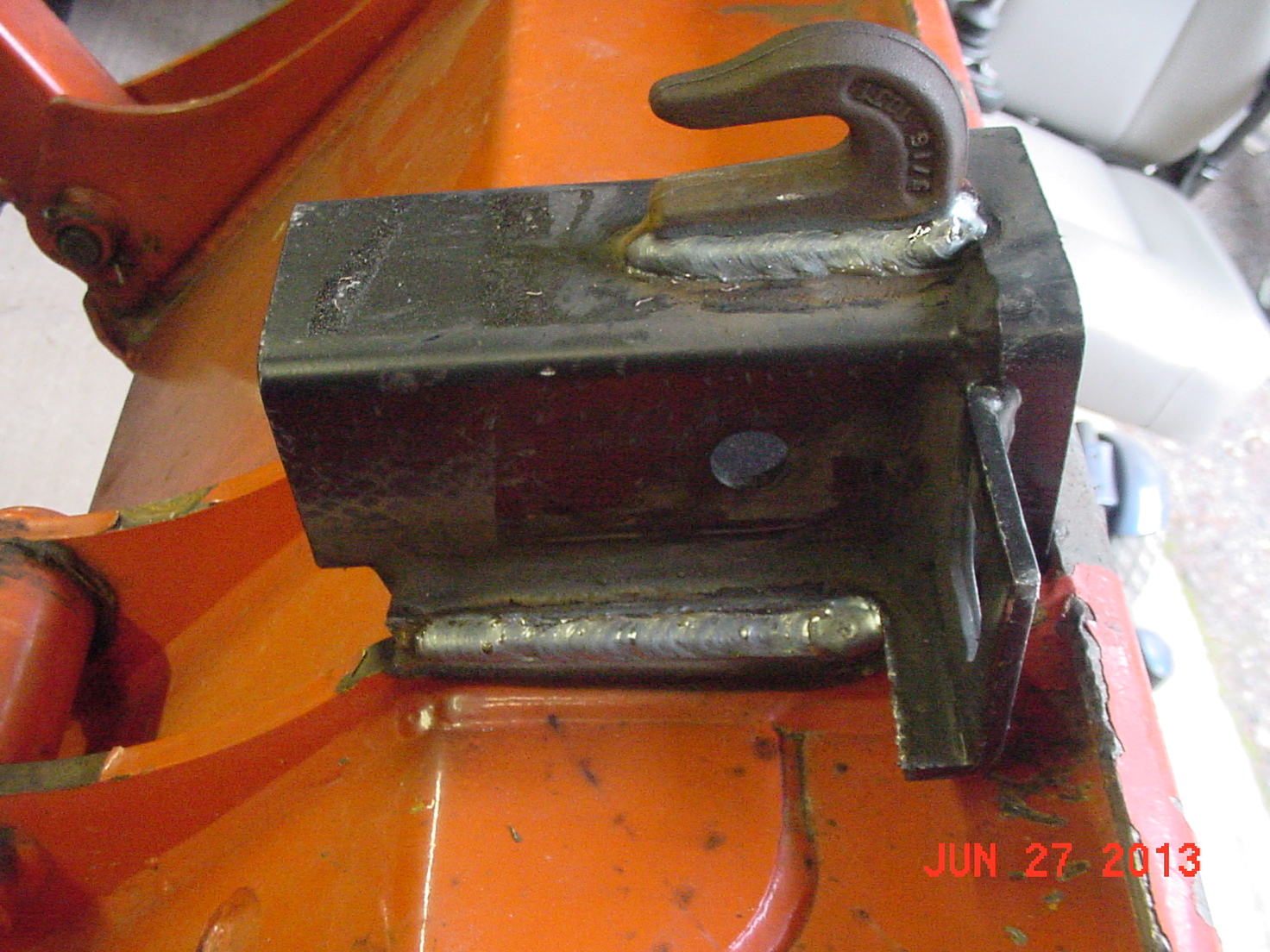

There are many posts about adding a receiver to the bucket. Use the Google search tool at the top right of the forums page. Here's a pic of one I added a few years ago. I did weld on extra 3/16" angle and 3/16" flat plate to weld the receiver to. Bucket metal by itself was too thin by itself. I haven't put a hitch on my current tractors bucket. I use the QA on my 3 pt. hitch for moving trailers around.

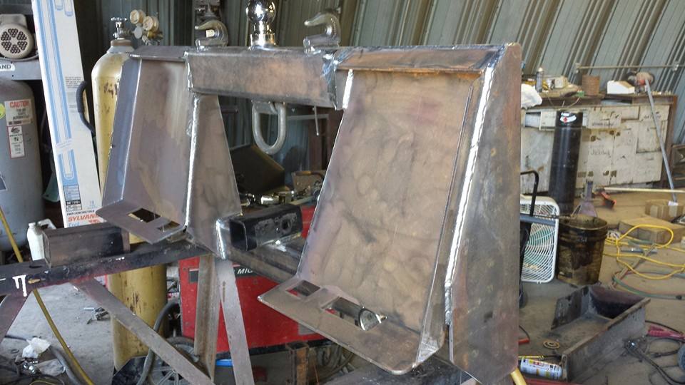

I ended up buying a Titan screw-on 2" receiver mount that attaches just like my pallet forks. Mounting them on top of the bucket I decided was to high for a few of my trailers. Thanks for the help though.
/ Bucket hook weld on points #34
Welding a receiver to the top of the bucket seems not great to me, after I did it (based on many positive reviews here). It is just too high up for a normal drop drawbar (~4"). And if you get a deeper(?) drop drawbar, then you can't see it very well. Those who have made something that sticks out a bit and keys off the bottom or cutting edge of the bucket seem to be onto a better idea. My $0.02
