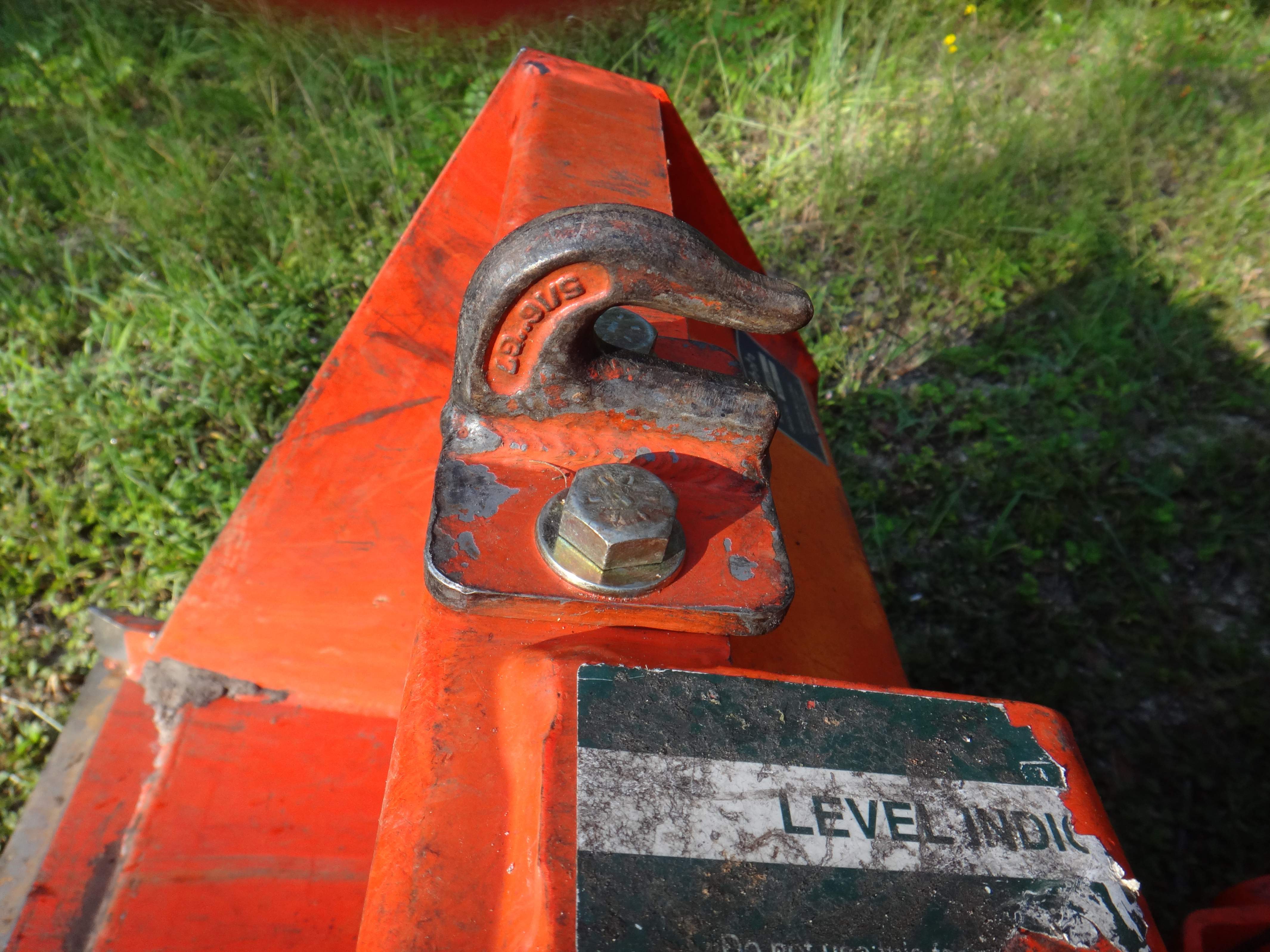

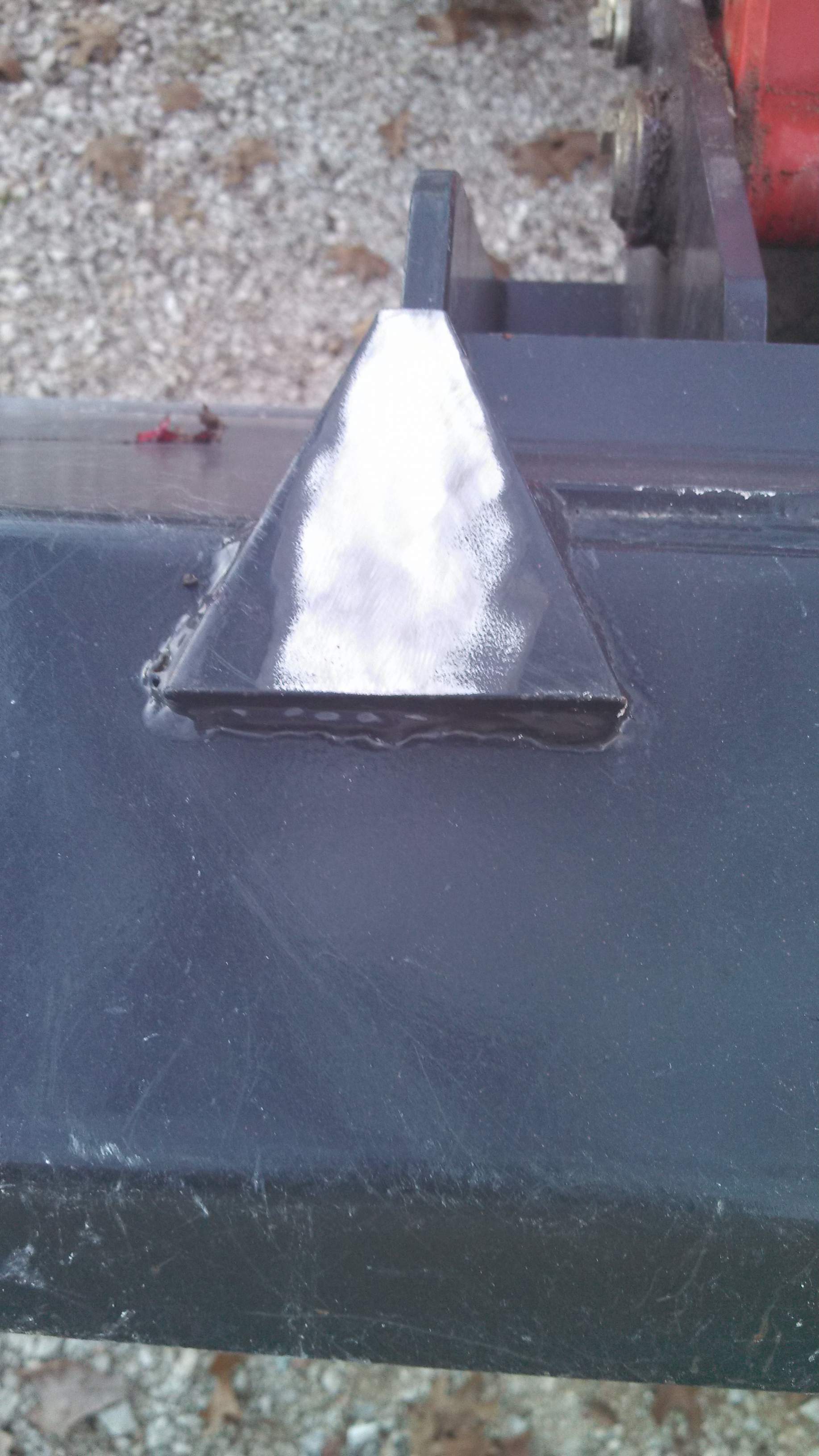

Looking for some comments or suggestions on my weld on points for bucket hooks and shackle mount. This is a 2014 Kioti DK45 KL401 6ft loader bucket. see pic. upper would be for shackle to secure logs or brush to bucket (from shackles attached to tooth bar bolt holes). Lower is for grab hook-will use backing plate on this one.

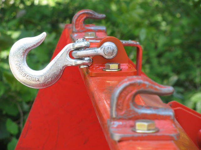

You do not want shackles, you want 5/16" chain grab hooks.
Mount approximately in line with lift arms. Lift arms help keep bucket from torquing, potentially "springing" FEL arms. The position also maximizes bucket support of FEL lift arms.
A chain grab hook is a more rapidly accessed fitting.
I seldom used the center slip hook, so after several months I removed it.
It doesn't hurt to have shackles, but in my experience they would be superfluous if you have grab hooks.

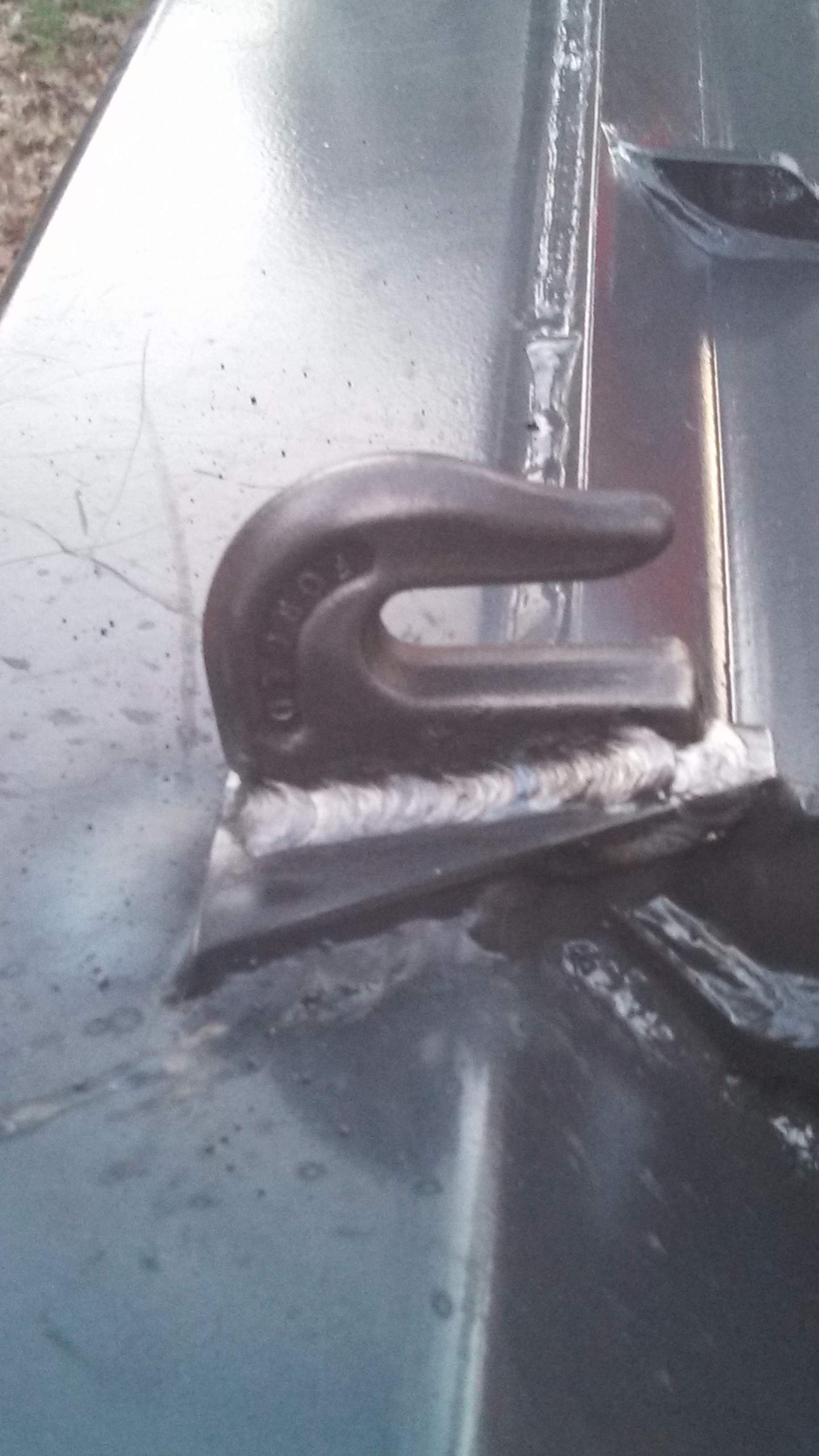

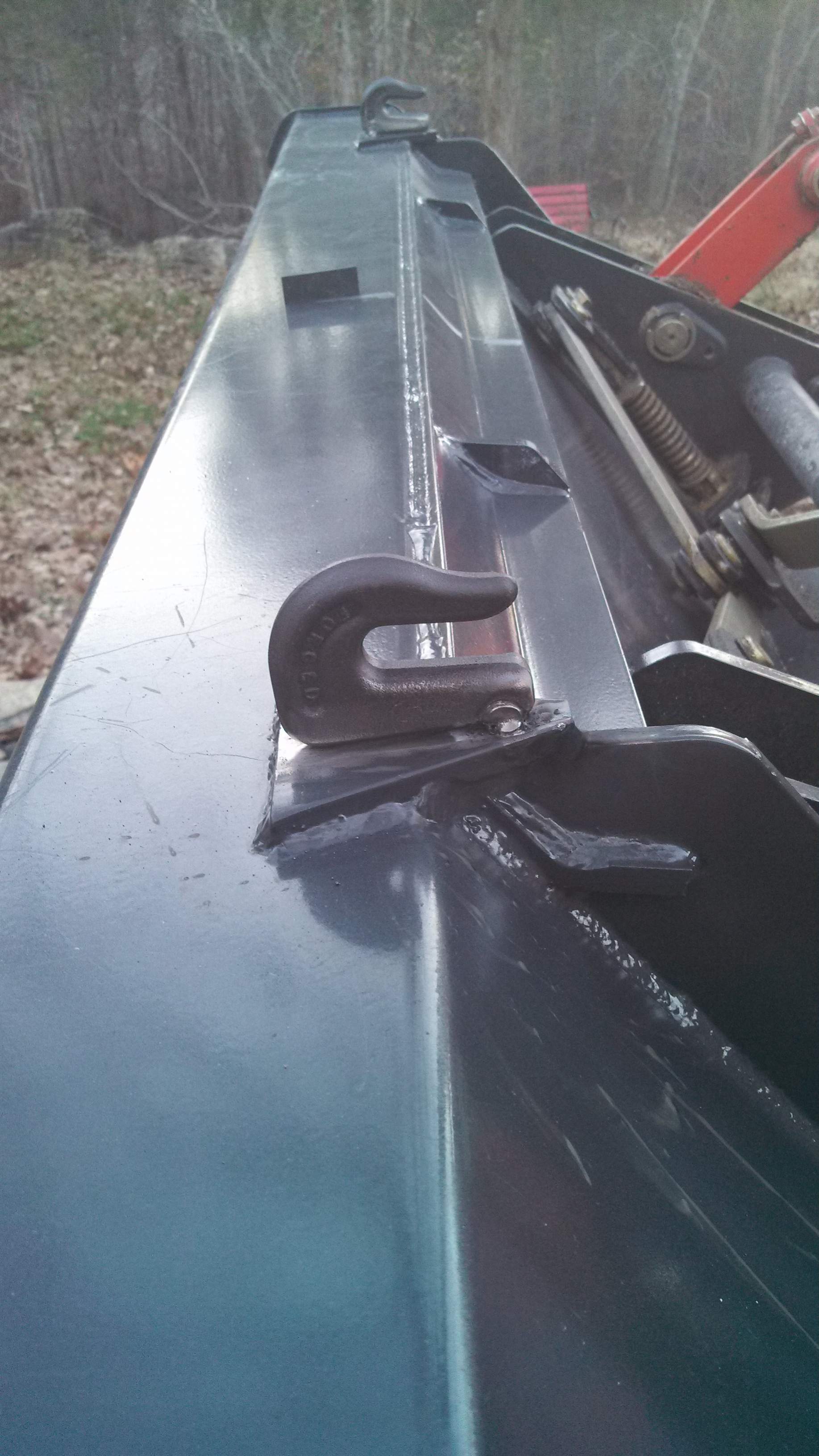

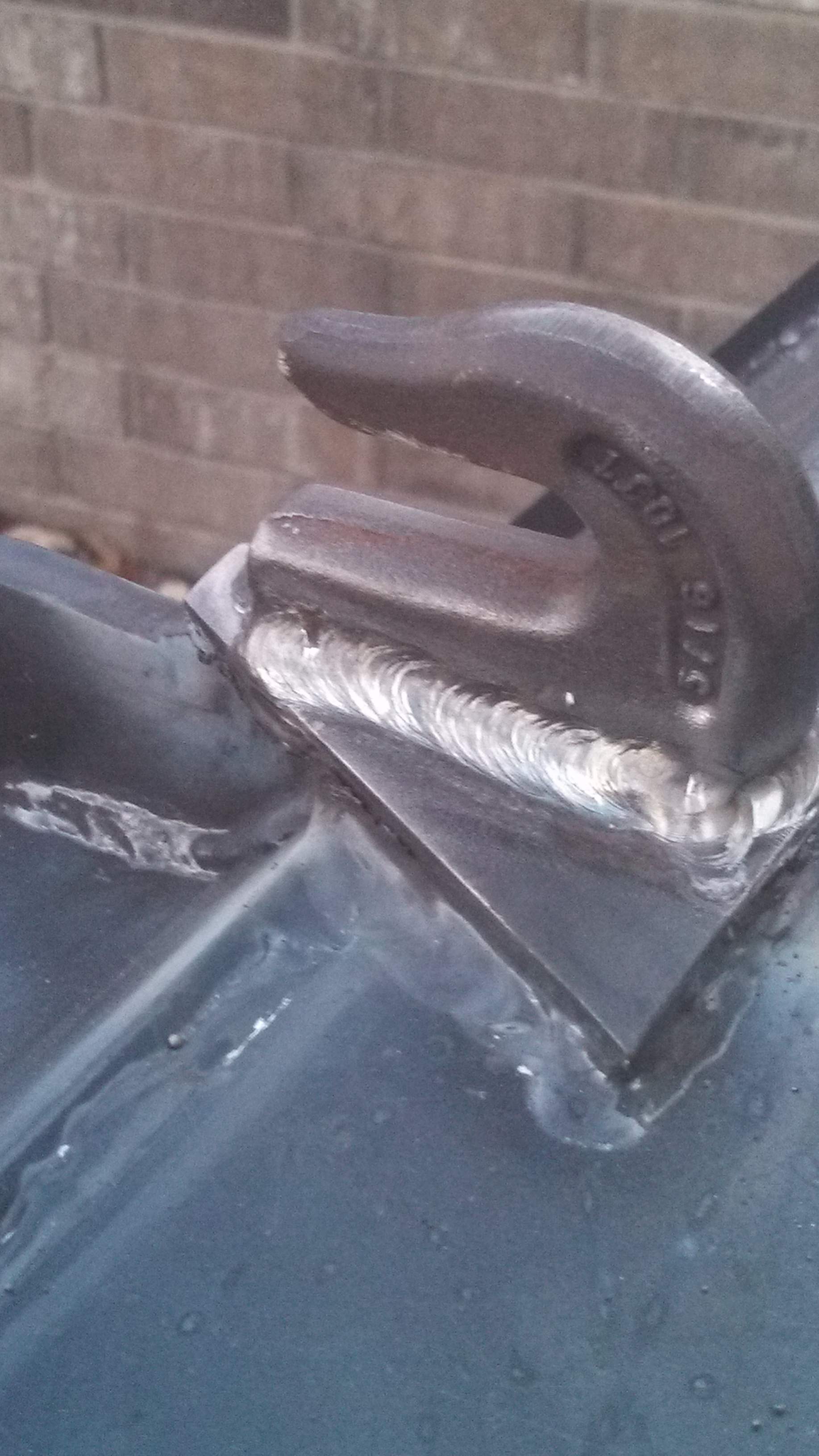

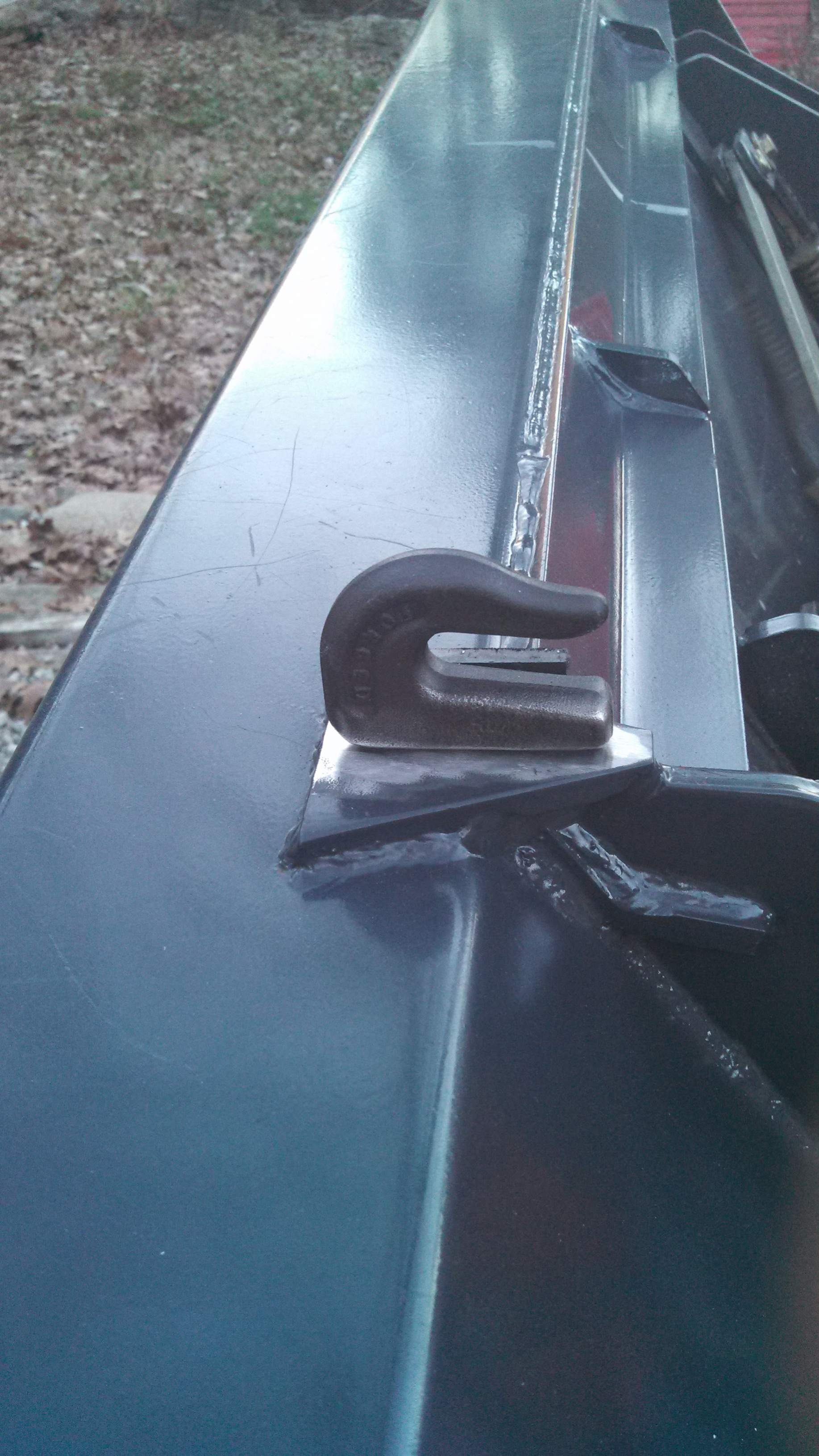

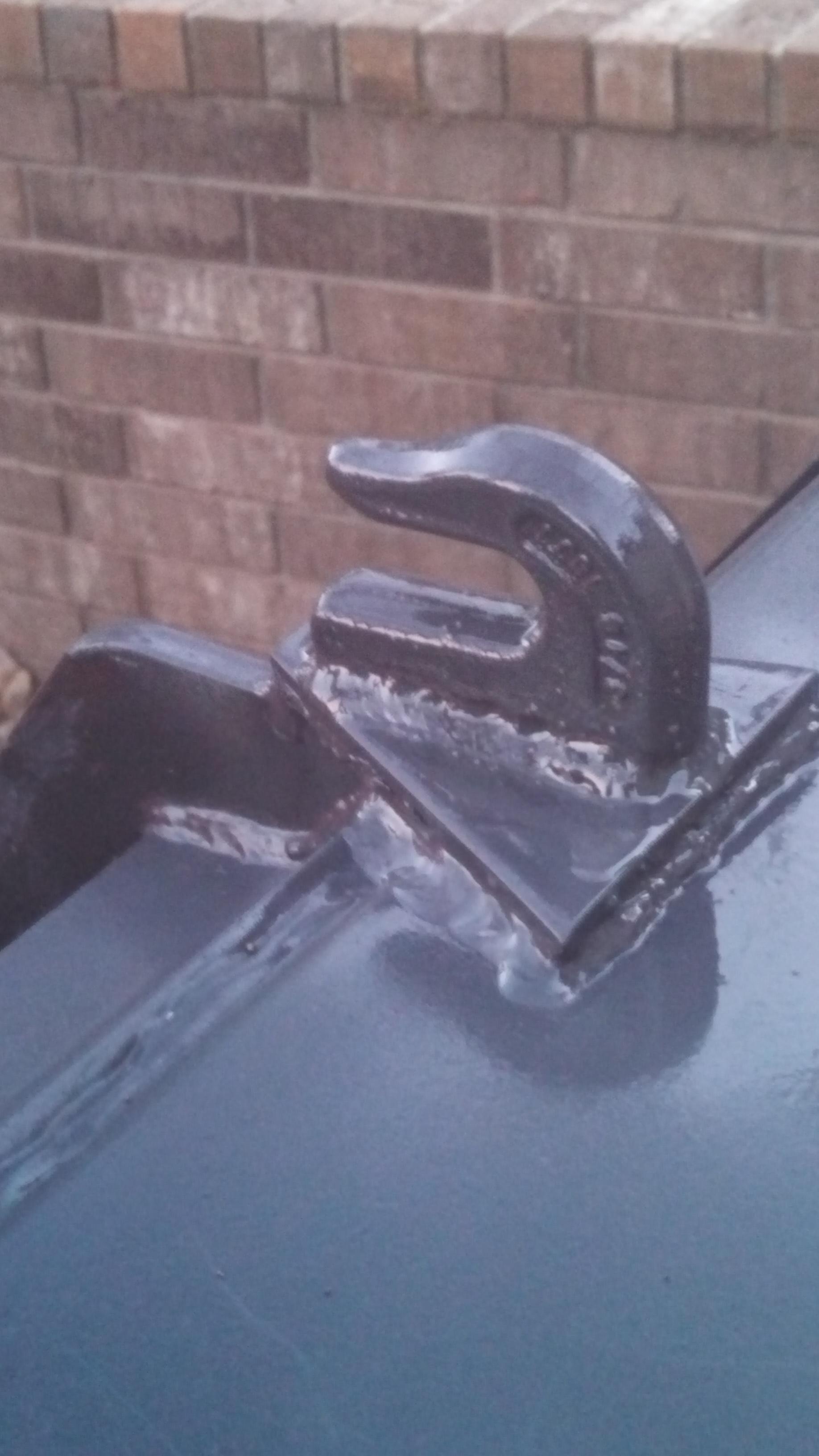

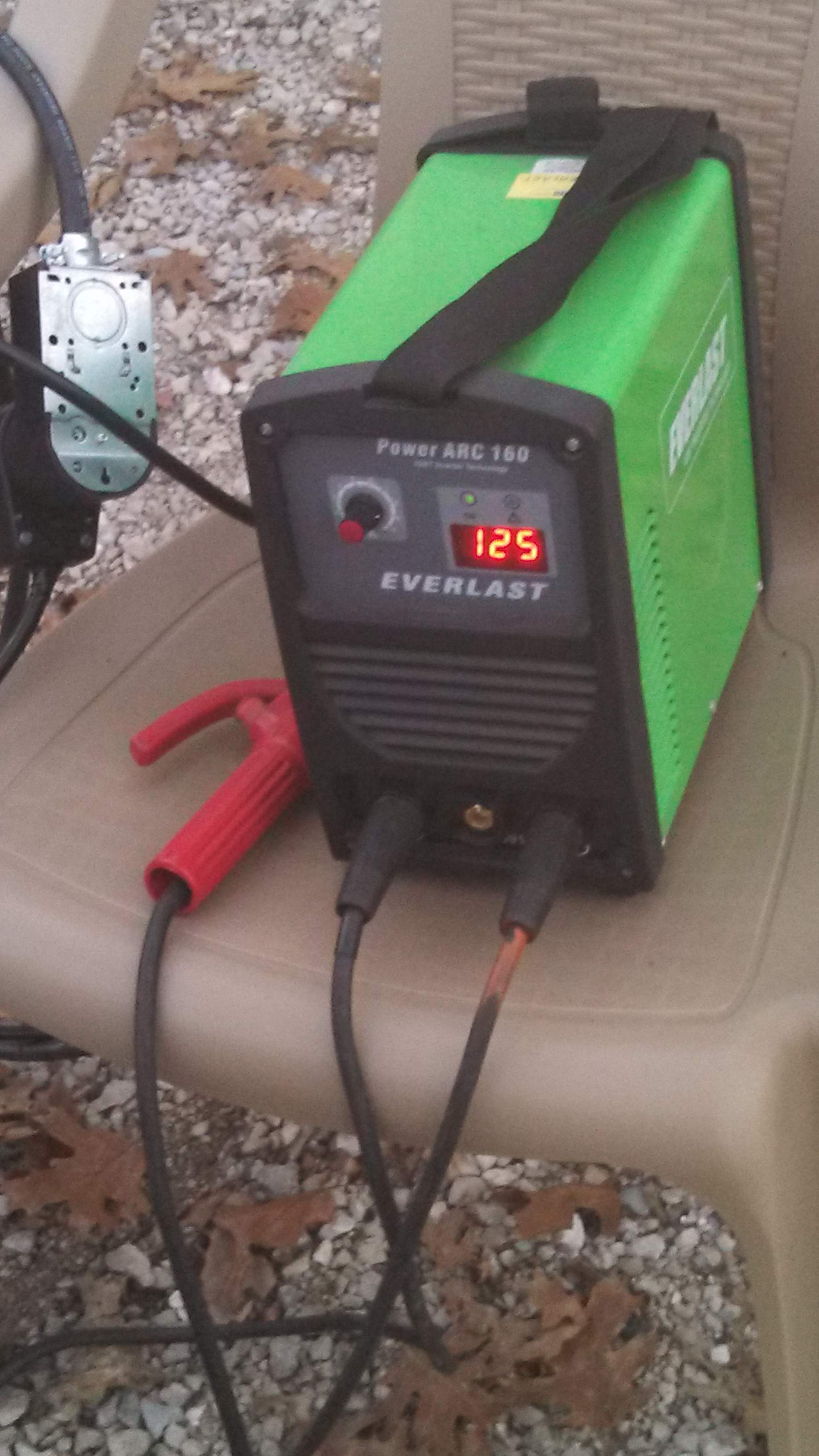

Mount what you please, but this is what I did, and have not wanted for anything different. I used 5/16 grab hooks, on the factory pads. Used some 7018 1/8 inch at about 125 amps. Cleaned all down to bright metal first of course. Repainted with Kubota's new charcoal paint. (yes I know that is a sin, putting Kubota paint on a Kioti, but I had some left over from the last Kubota, and it seems to match as good as anything. Here are the photo's in no particular order. Just tack them on straight, and weld em up!:)
IMG_20121117_165336_859.jpgIMG_20121117_170314_242.jpgIMG_20121117_165314_192.jpgIMG_20121117_165303_772.jpgIMG_20121117_164305_653.jpgIMG_20121117_162438_547.jpgIMG_20121117_162424_854.jpg

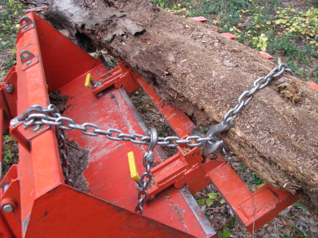

I think in that post the brush forks are doing the heavy work while the chain just stabilizes the log.
True.
With my old, light, B3300SU I always kept max loads secured tight on the bucket, to prevent oscillation. Had soggy log dropped off, I am not sure I could have picked it off the road without unnecessary fol-de-rol.

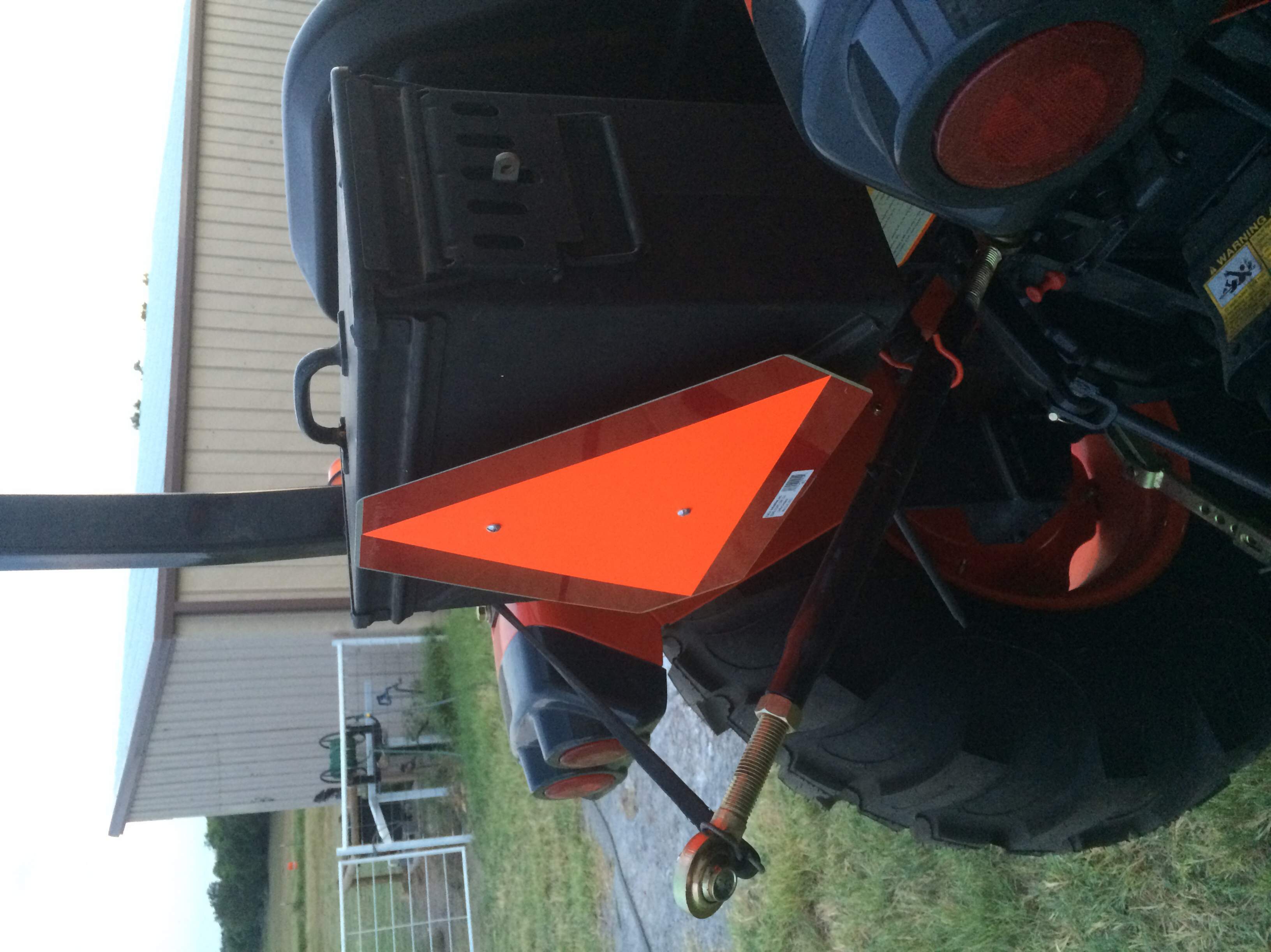

There was an 800 pound Cultipacker on the B3300SU 3-Pt. as counter-balance when photo was taken. Front axle on the 'B' series is pretty light; I was careful to counter-balance, never had a problem.

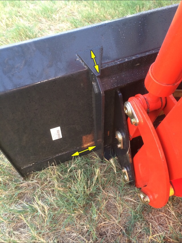

With the much heavier, much more stable L3560, counter-balance remains important but I do not chain-secure loads as often. (Photos #3, #4)
Picture #4 shows Rollover Box Blade as counter-balance.
L3560 has optional Kubota (L2296) Heavy Duty Round-Back bucket with Ken's 5/16" weld-on Grab Hooks. No center mount.
Ken's hooks are industrial art. If you buy Ken's once you will be dissatisfied with lesser quality.

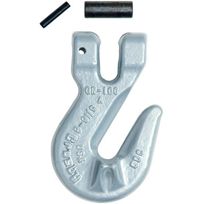

image.jpgimage.jpgI said it wrong, they are cradle grab. Less to no strength loss on the chain. Ive only seen them in grade 80 and 100 so not ideal unless you know what you're doing welding wise. The bucket is 3/16 but on the bottom rear the bend that makes up the bucket has 3/16 angle welded to it, so 3/8 at that point. might be a good spot next to the quick pins. 3/8 there too. check out my ammo can toolbox! it came with a lock clasp and lid hinge on one side too!
View attachment 389174View attachment 389175View attachment 389176View attachment 389177View attachment 389178View attachment 389179View attachment 389180
