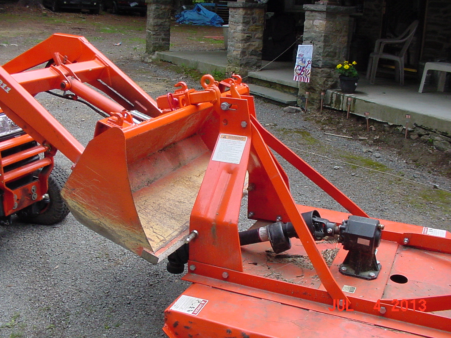

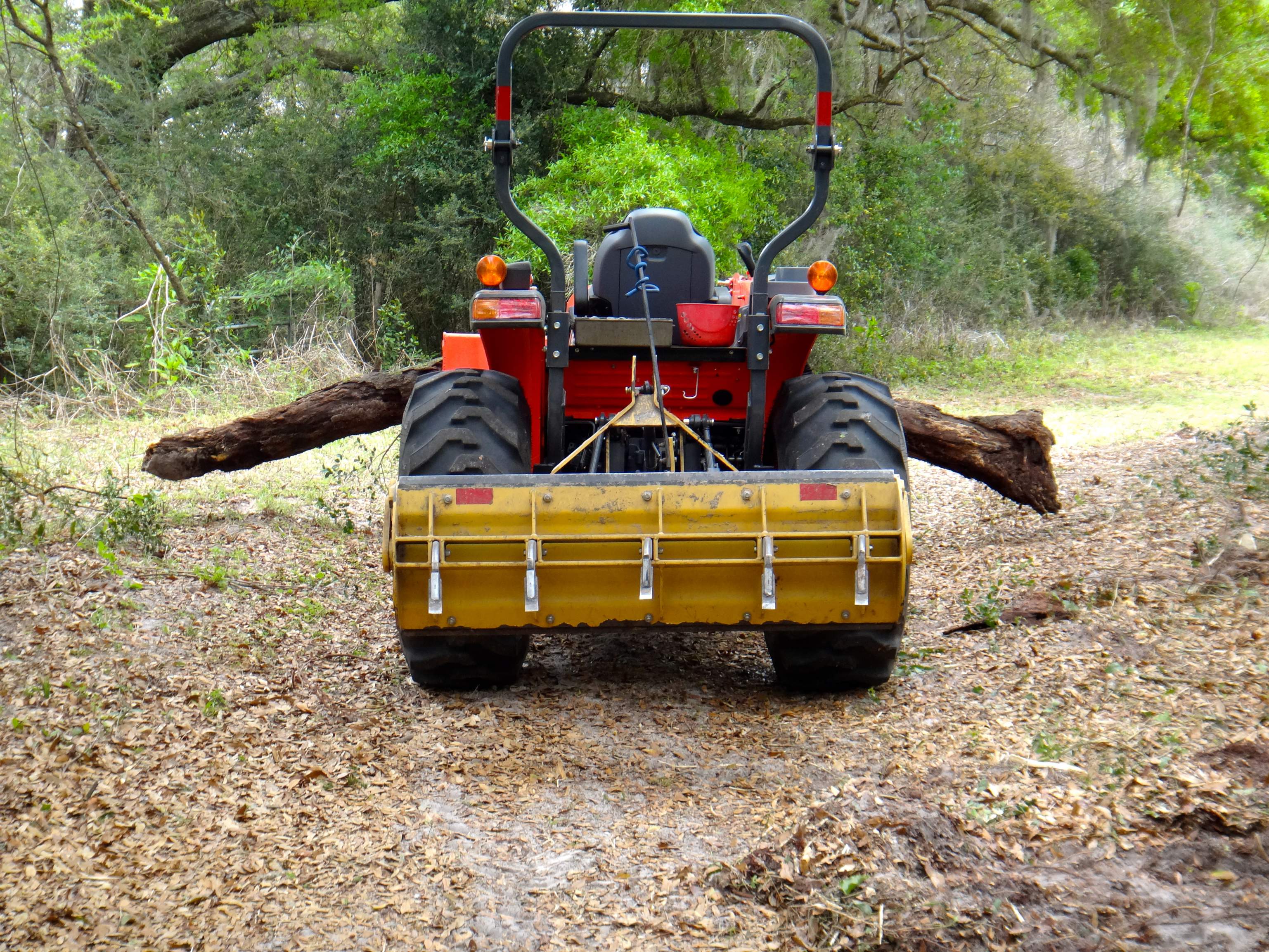

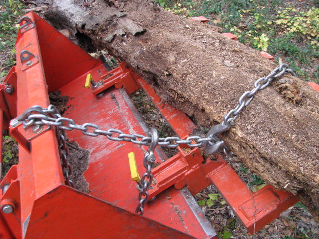

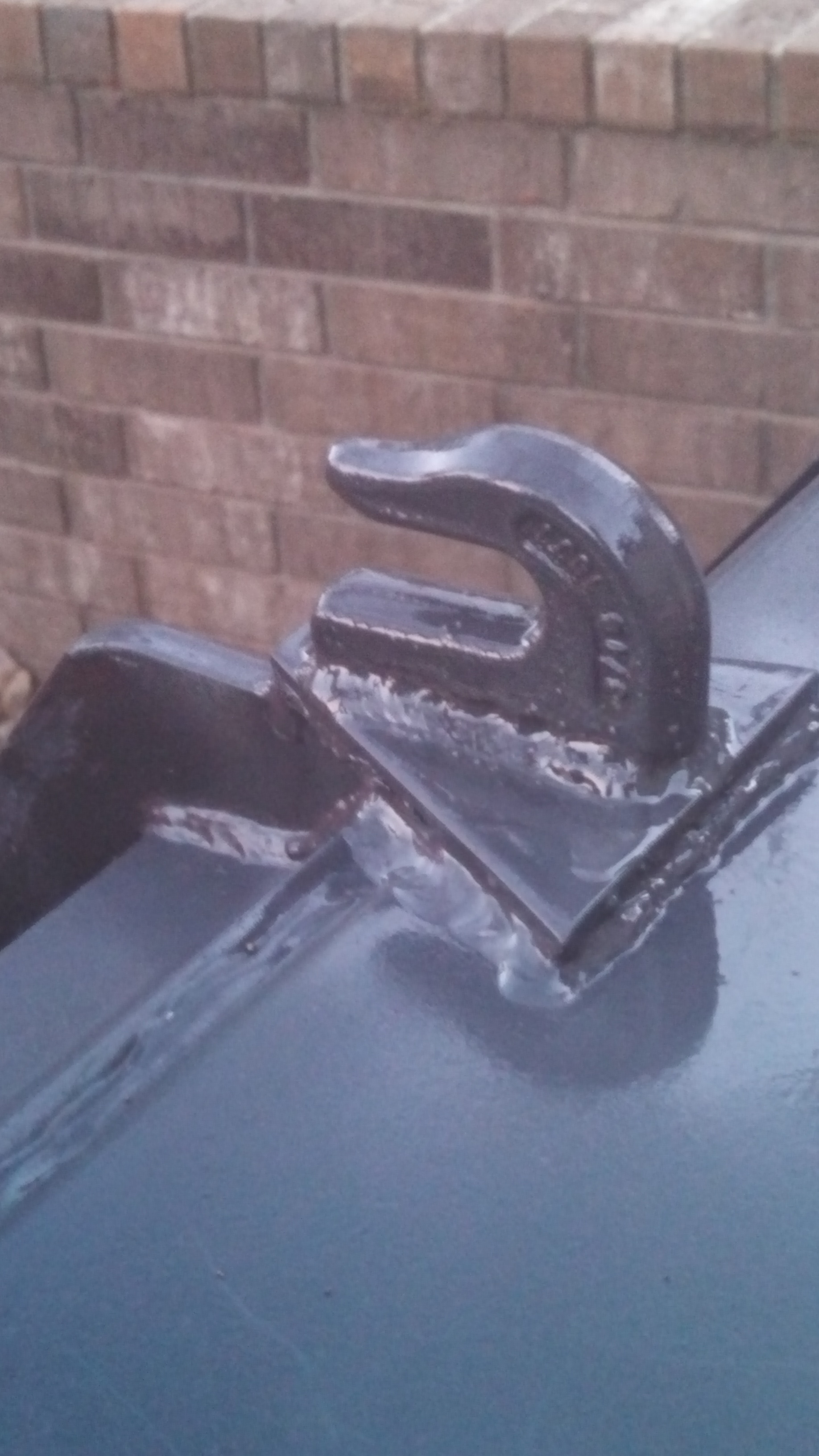

I welded grab hooks and shackle mounts in addition to a receiver mount to the bucket. With the receiver mount I have many choices with the center of the bucket. It makes moving things around much easier. With the large hook moving three point equipment is easy. I like the shackles for attaching ropes and straps plus the mounts give you a place to bolt something on if needed.

Very nice job Like how you made the triangle mounts.As to another poster I have found that with my mid size tractor 3/8 chain is overkill. I have it but never use it. 5/16 and also the ability to grab the 1/4 chain is great when your holding something in bucket.For me with a 5 foot bucket 3/8 chain is just to much.

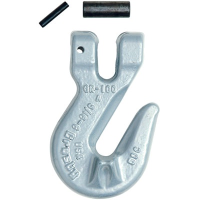

Also likke to add. that I like to use the clevis grabs and grind to suit.with the pin out of the clevis.(leaves me with a usable pin for elsewhere) when I load ,say a washer machine or fiurniture. the grove where the clevis pin would go adds a good spot to slip rope onto.

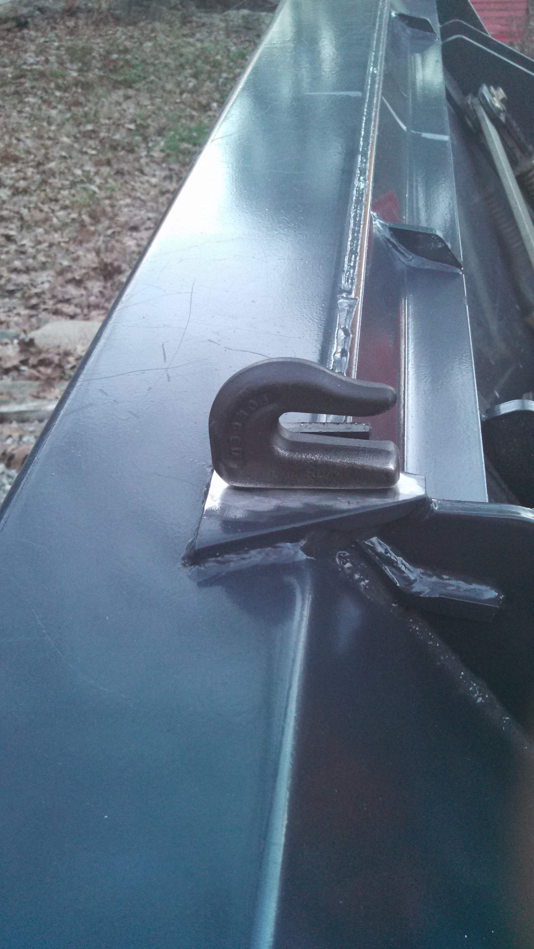

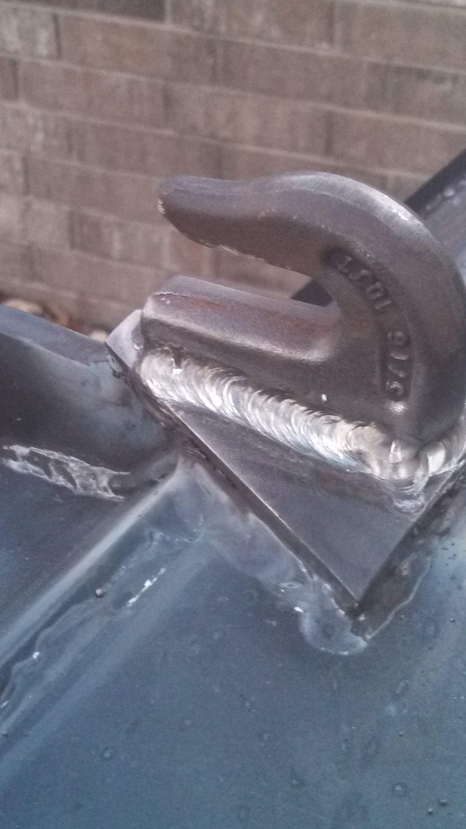

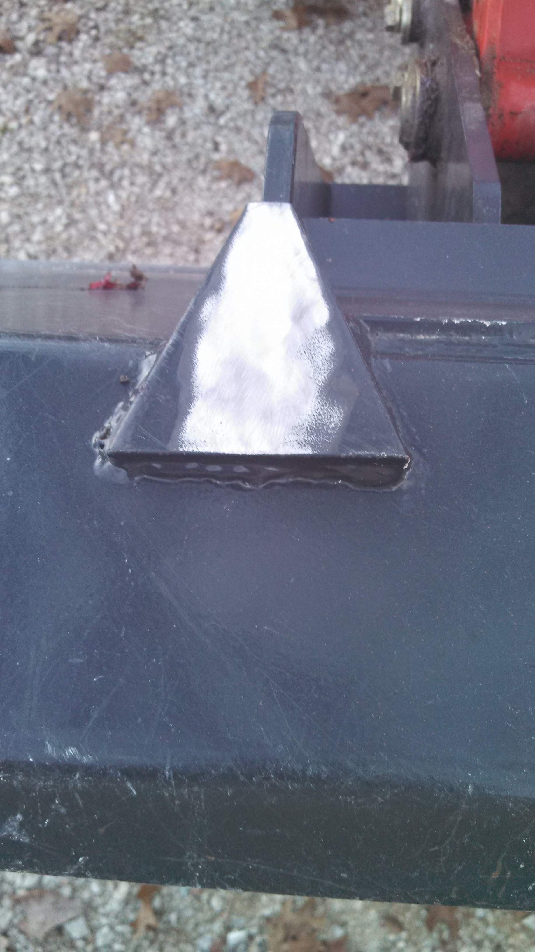

I did not make the little triangle mounts. The bucket comes that way from the factory. I assume they are there to weld hooks onto.:thumbsup:

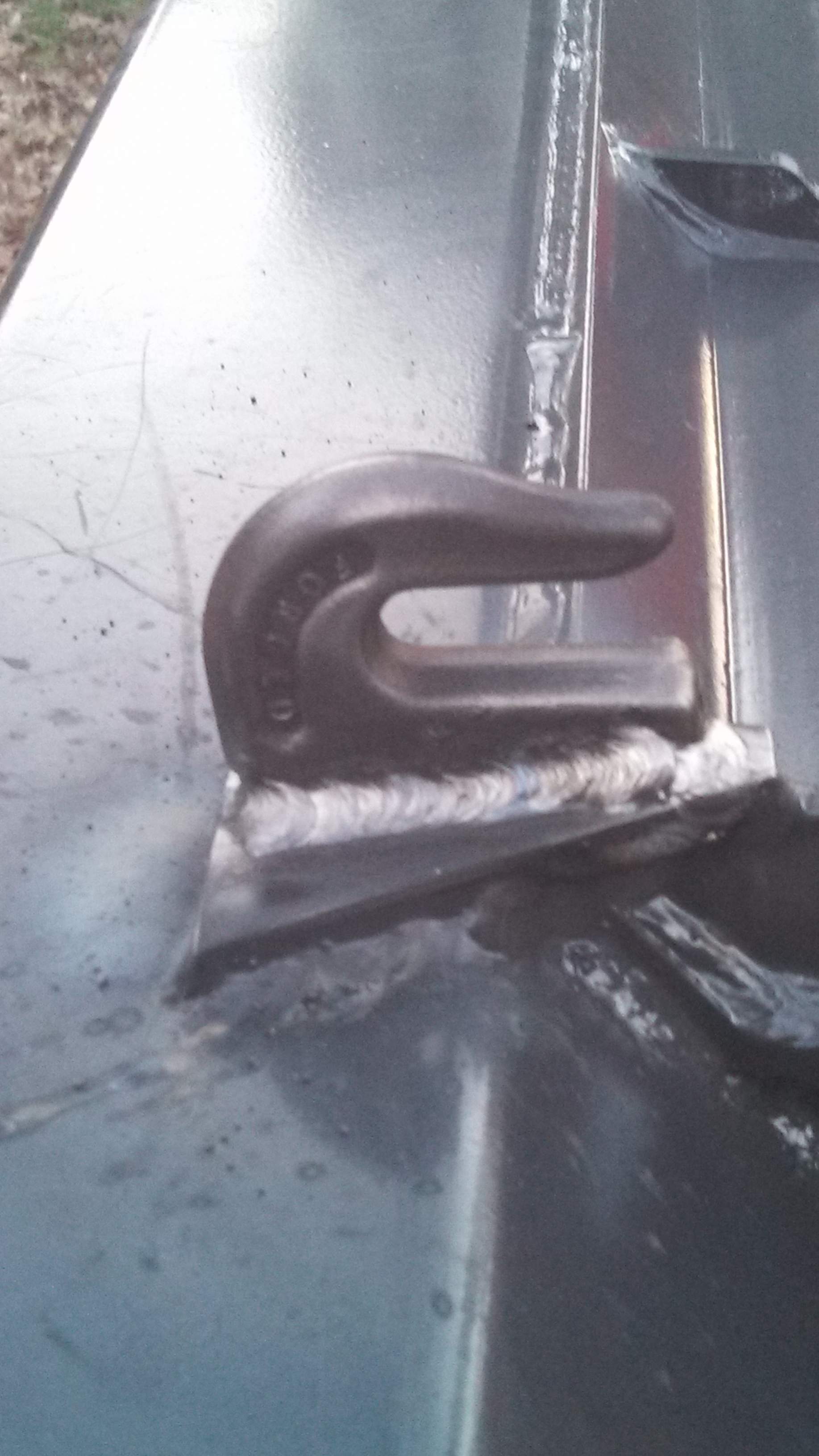

Can never have too many options. I have some recovery straps so the tow hook comes in handy.
That is the configuration I welded up. The only change I would potentially would make is welding on a receiver tube, but I am not sure where I would weld it. The top of the bucket seems too high. For now, the receiver hitch goes on the 3pt.

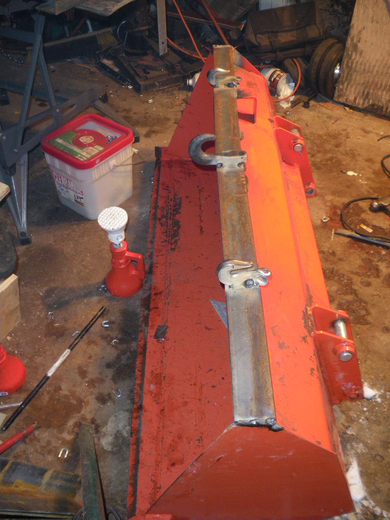

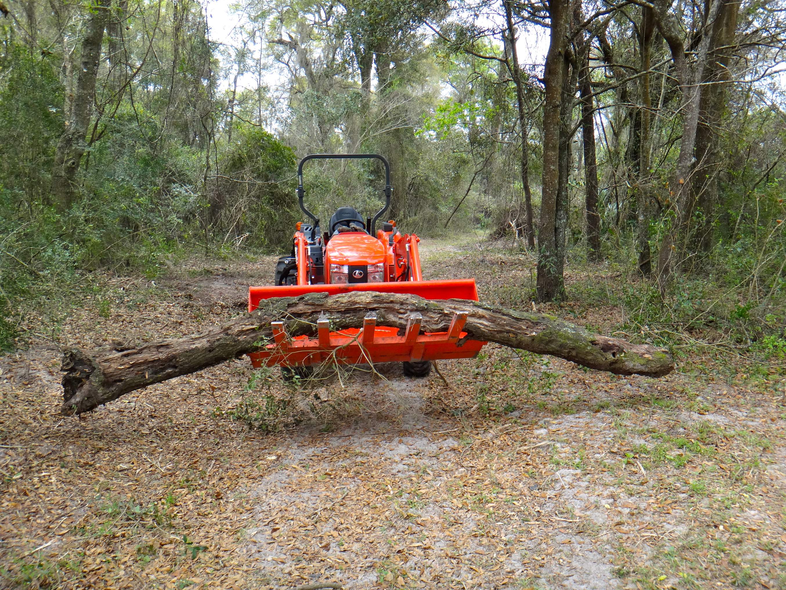

Here is where my four hooks are welding on my stock 72" general purpose bucket.

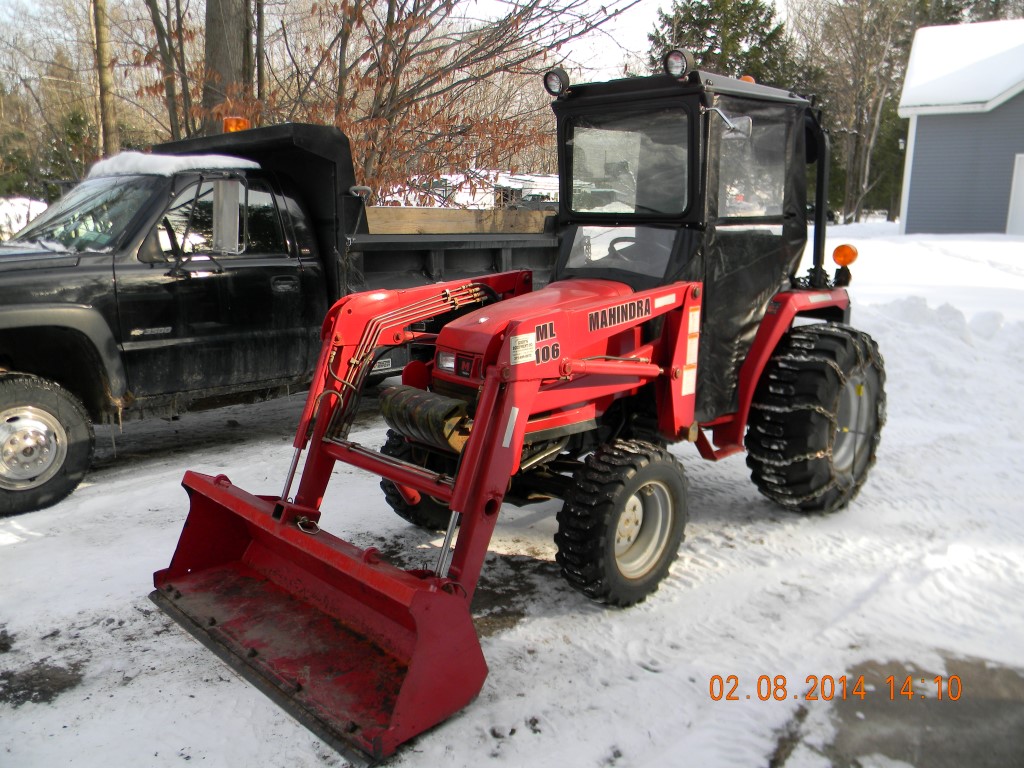

I put these on 6 years ago, they really come in handy. WP_20140426_003.jpgtractor%202.jpg
/ Bucket hook weld on points #29
Kubota BX25D
I placed them just inside the welded channel for balance and stability...

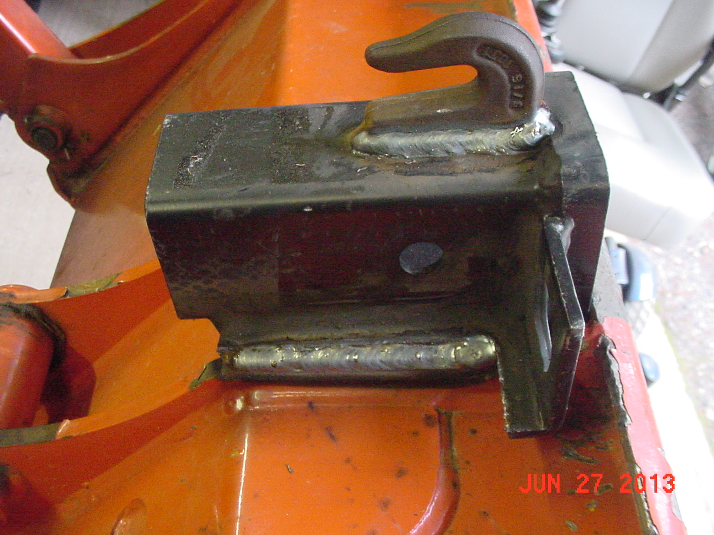

Can anyone point me to a prior discussion on mounting a 2" receiver on the bucket of a FEL?
/ Bucket hook weld on points #31

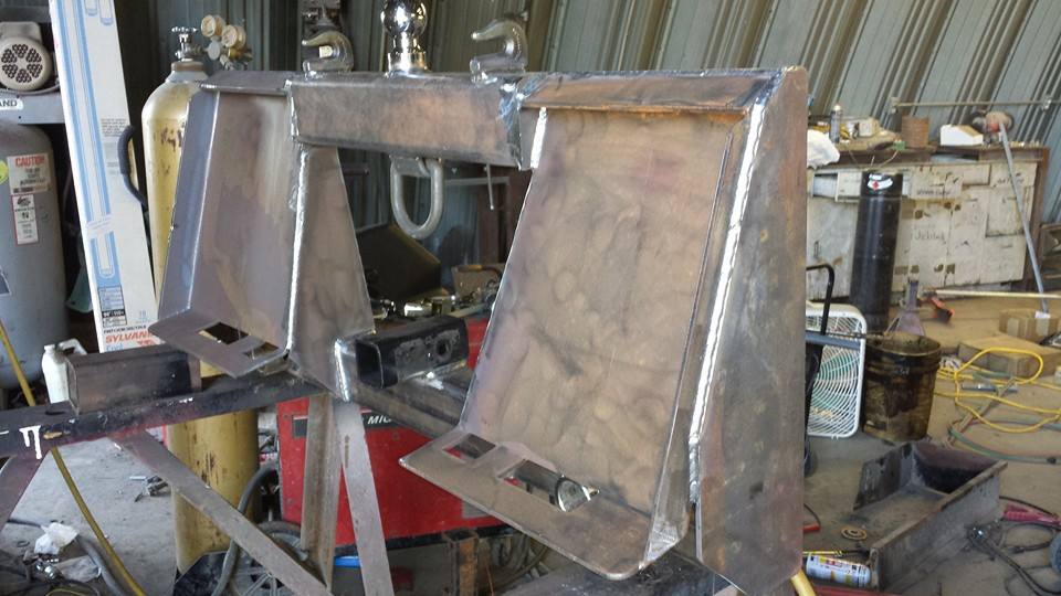

There are many posts about adding a receiver to the bucket. Use the Google search tool at the top right of the forums page. Here's a pic of one I added a few years ago. I did weld on extra 3/16" angle and 3/16" flat plate to weld the receiver to. Bucket metal by itself was too thin by itself. I haven't put a hitch on my current tractors bucket. I use the QA on my 3 pt. hitch for moving trailers around.

I ended up buying a Titan screw-on 2" receiver mount that attaches just like my pallet forks. Mounting them on top of the bucket I decided was to high for a few of my trailers. Thanks for the help though.
/ Bucket hook weld on points #34
Welding a receiver to the top of the bucket seems not great to me, after I did it (based on many positive reviews here). It is just too high up for a normal drop drawbar (~4"). And if you get a deeper(?) drop drawbar, then you can't see it very well. Those who have made something that sticks out a bit and keys off the bottom or cutting edge of the bucket seem to be onto a better idea. My $0.02
