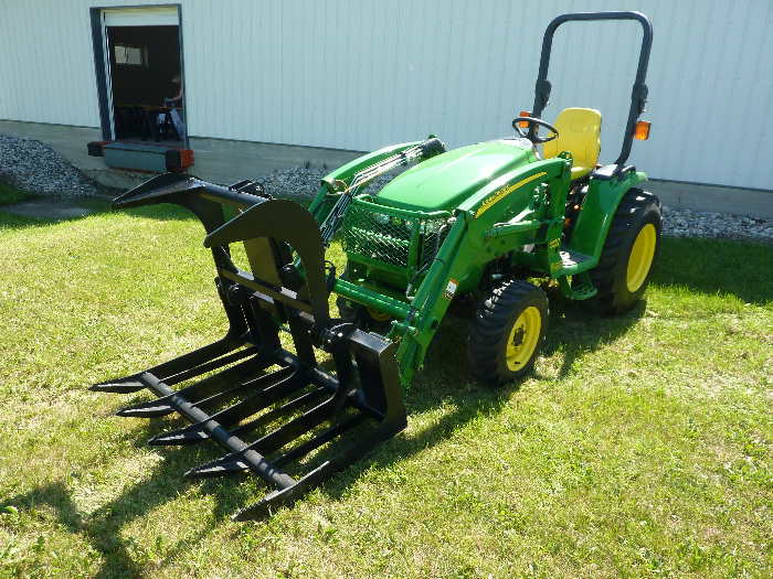

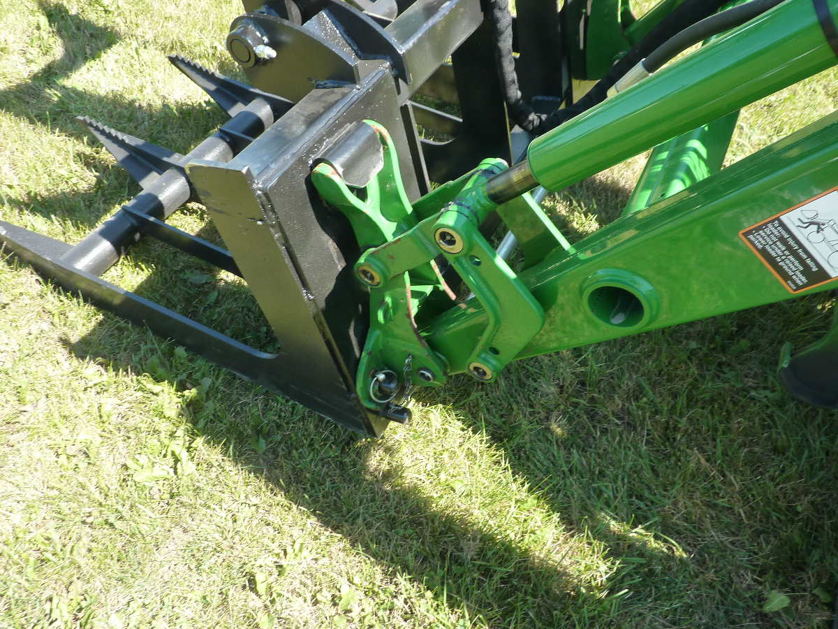

I wanted a grapple on my old 790 too....but lacked the hydraulics and a few other things to keep me happy. So....I traded tractors first then added a root grapple from Markham/gator.
Here are things to consider:
1. QC Bucket? IF so, then a dedicated root grapple could be an affordable option.
2. Tractor QC connectors? Front Hoses? If not, then diverter valve may be best option. (but adding remotes may be a good alternative too?)
3. Hydraulic and welding skills? As you noted.
4. Dirt bucket or snow bucket needs alternately? (removing may be a hastle)
5. Cost. Hydraulic costs are the same with either a bucket grapple or a dedicated root grapple.
6. Long-term added value. To me a dedicated root grapple always has value seperate from the tractor.
7. And....probably the most important feature to compare: Operation. I think the dedicated grapple is a better performer for my needs.
I considered adding a diverter valve on my tractor, but had the 3rd SVC valve and lines to the front already, so was not required. I did look at these valves at the Surplus Center (TBN Advertiser) and would have purchased my valve from them had I gone that route. (Do a search on diverter valves for hours of reading.)
FWIW....I like having a dedicated root grapple and keeping my bucket ready for dirt work....at a moments notice via the QC feature. Costs about $1100 shipped to MN.....your shipping may be more.

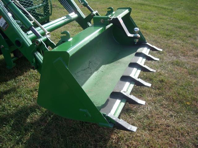

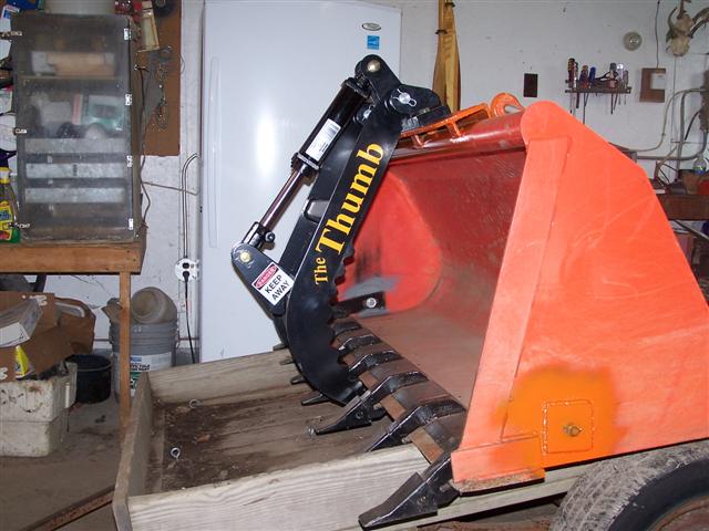

I added a Green's Machine Thumb&Markham tooth-bar.Happy with it,doesn't add a lot of weight to the bucket,easily removed(both bolted on).What ever you do the hydraulics will be the same cost.I had to weld an angle on the top of my bucket to get the proper close.About $900.00 two years ago,I already had the third function installed for my snow plow.

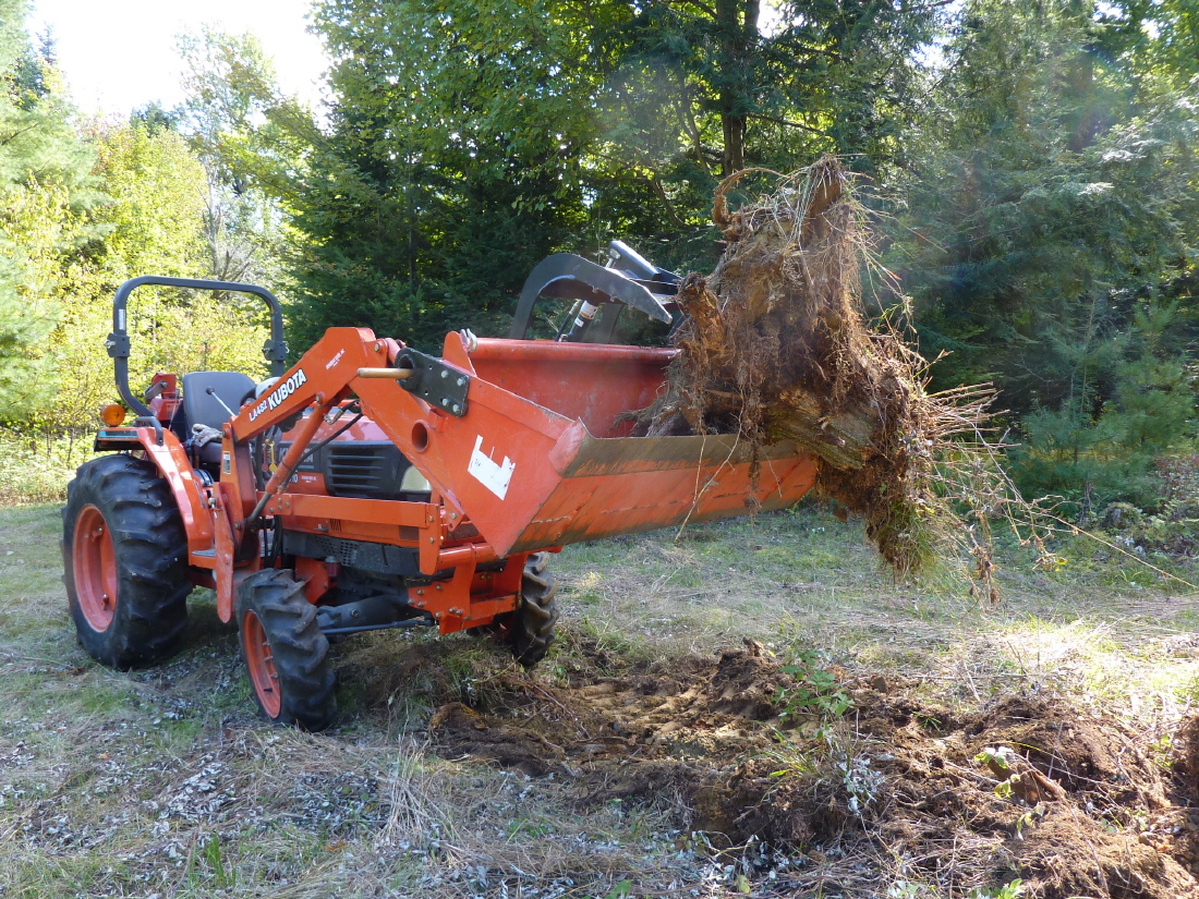

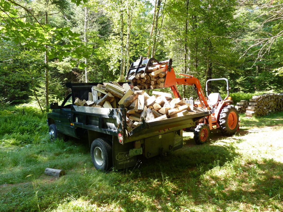

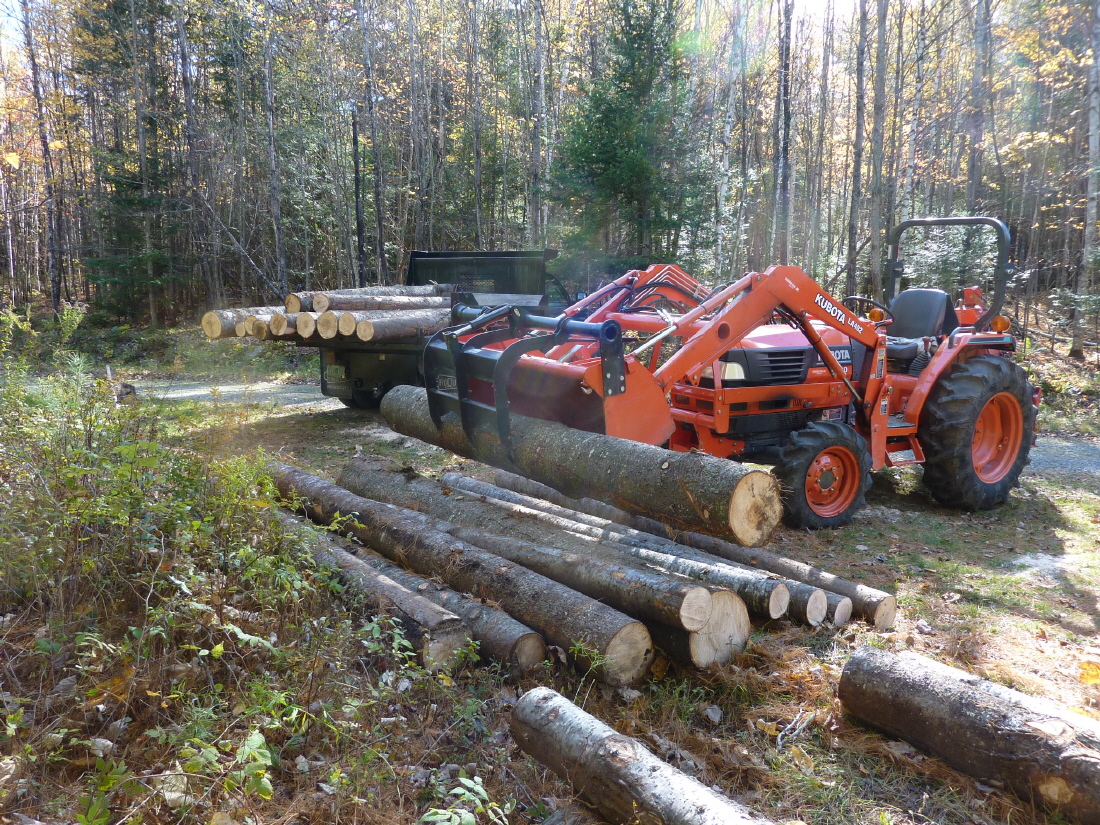

I have an ATI grapple that I am quite happy with. No one seems to mention these and I don't know why. I have had it for quite a few years.
