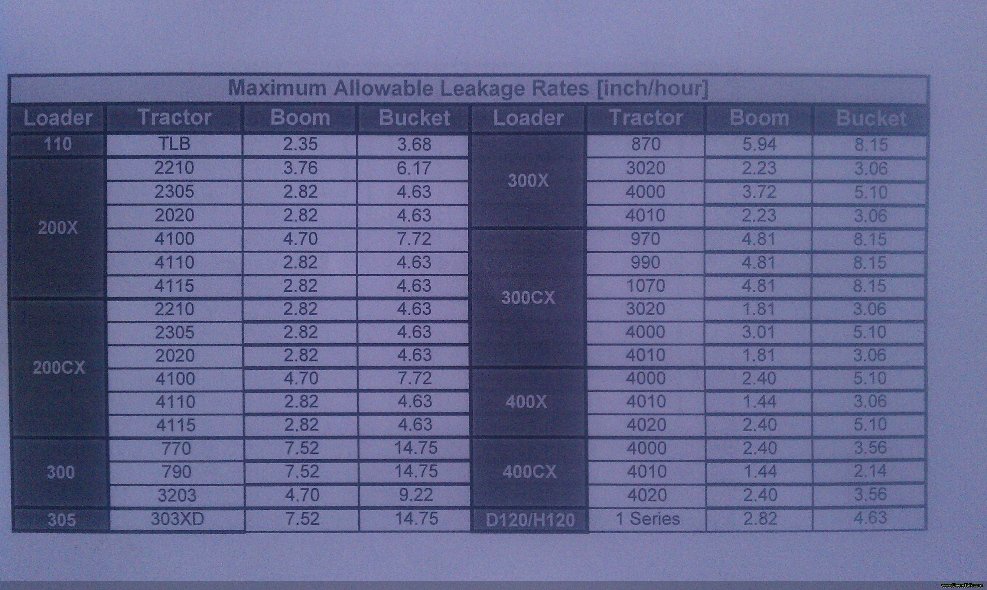

That is the most it will resist. Once it moves (if at all), unless it sucks more air in from somewhere, the resistance increases as vacuum increases on the cap end of the cylinder.
What is your position on retracting
Same as yours. Pressure has no limit. ... Vacuum does.

If there is a seal leak,with a pulling load, the fluid will transfer until the pressure equalizes.
As you stated, the load could pull a vacuum.
/ bucket drops #25
Yes it can, but would reach equilibrium, and not continue to drift at the same rate.
But you are avoiding my questioning of the loader itself drifting down. Compressing a cylinder??
/ bucket drops #26
Well, answer this, do you think all loader arms descending over night is caused by valves?
Are you saying that it could not be caused by the cyl seals?
/ bucket drops #27
I am saying yes, it ain't the loader seals.
It can be the valve, gland seal leak, hose leak, but not the piston seals.
/ bucket drops #28
As soon as the port blocked cyl extends its volume increases. Since it is full a hard vacuum immediately develops on both sides of the leaky piston. Neglecting seal friction, the force then remains constant at 14.7psi X rod area as the cyl continues to its stop. This leaves an empty void in the cyl. The oil and any included water -- EVERYTHING VOLATILE -- boils into the void at ambient temperature raising the pressure slightly above 0 Absolute.

Sometimes the glands aren't very good at holding a vacuum though, and air is sucked in around the rod, and the whole process repeats. A situation that I've observed countless times on industrial press brakes.
/ bucket drops #30
Yeah, but then it just extends easier since the cyl holds a less complete vacuum.

Someone replacing piston seals for a loader drifting down overnight....yea, must just be for the he** of it, or someone gave them bad advise.
When piston seals are shot, the loader still holds, but you would notice a lack of power. Cause when trying to lift, Pressure is applied to the base end of the cylinder, and the rod end is opened back to tank. So the pressure bypasses the seals, out the rod port, and back to tank. Thus it is hard to develop full pressure, and the loader lacks power.
But when the valve is in the neutral position, The cylinder "should" be isolated if the valve is good. And its NOT GONNA DRIFT DOWN even if the seals are totally gone. It says something just like that in the article YOU linked.

With bad piston seals you will see very hi pressure develop in a cyl holding against compression forces after a lift. In a valve centered position the seal leak allows the pressure to equalize on both sides of the piston. The net piston area is now the rod cross section. ... If youre experiencing repeated popped lines in transport of a load check the seals.

Update........ Dealer did testing and found deep gouge inside one of the bucket rams, replaced ram and says its holding now.
Time will tell if they are correct.
