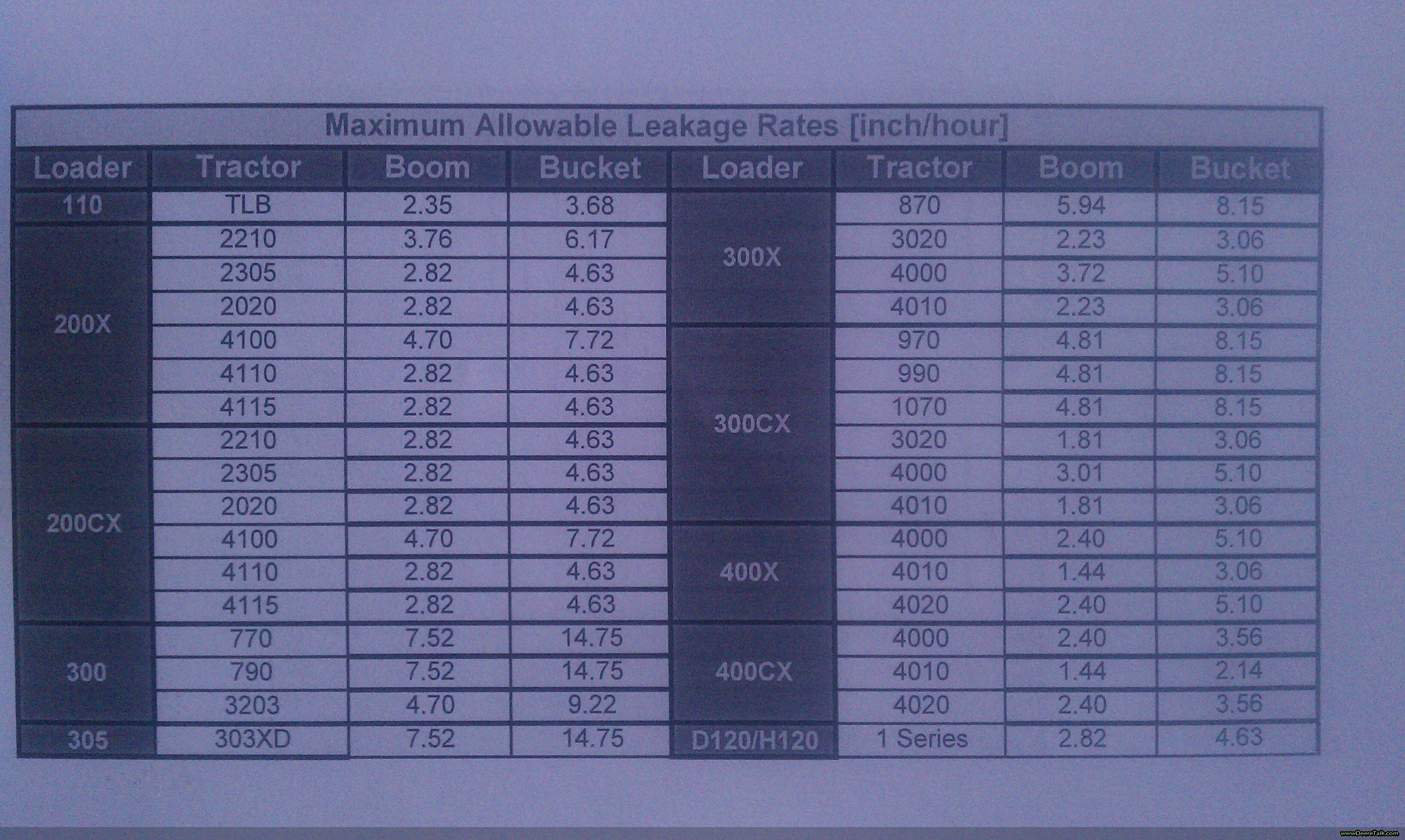

/ bucket drops #14
Here is a published spec from JD for some older loaders, this is probably what they are using to say it's "withing spec". Mine has done it since new, and most sCUT's and CUT's will to some degree.

Spoke with service mgr and after long debate on its within specs crap I told him there is a problem with the control valve of this model.
Having all four rams leak down from an internal seal at the same time is not probable.
process of elimination leads to valve problem as the longer I use it the faster it leaks down both tilt and loader.
Just to insure my tests of drop rate and curl are getting quicker with every added hour of use I have been testing it daily after use and logging it.
Talked him into trying it on one of the 3032E on the lot, AND it leaks down.
They are picking it up today for ram testing and most likely a control valve replacement under warranty.
