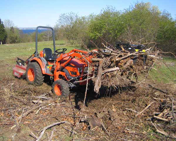

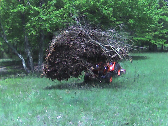

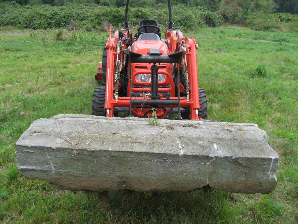

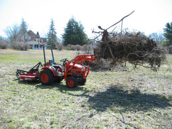

I agree that the clamshell grapple (Bradco, Anbo, WRLong etc) is optomized for brush and especially for picking up individual small bits and pieces. The problem is that they are also very much more expensive than the more traditional root grapple like the Millonzi, Markham/Gator etc. The other big distinguishing "feature" of the clamshell is that it can only hold it's load with hydraulic pressure while the traditional open root grapple can use gravity to hold a load.
The way to use a traditonal root grapple in brush is to cram the stuff into the gullet which allows probably a bigger load to be carried than with the clamshell even though the clamshell can pick up individual pieces more easily. My own technique is to collect small bits of brush into a pile and then take the whole pile at once. When you have a big pile I think the standard grapple can actually carry more.

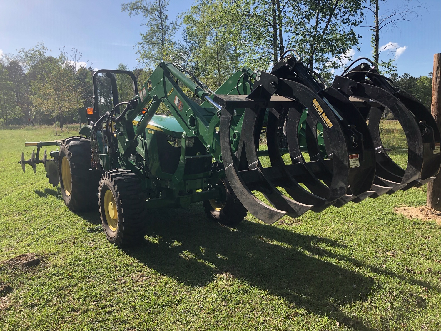

Talk about resurrecting an old thread....I just happened to stumble on this thread while looking up some info pertaining to my grapple. Seems the original question was never answered. I happen to be one of those guys who own and use an Oliver & Dahlman Brush Raker grapple exactly like the model the OP was contemplating. Interesting to read all the discussion. Since buying it, I've said every time I use it that it's waaay more than I needed yet I can assure you there's no way I'll ever break or bend it. I have the 7 tine, 54", dual cylinder version which comes in at 650 lbs. I use it with my Mahindra 5035. Of course there's always a lot of rear weight to balance things out and the grapple does exactly as I direct without hesitation or back talk. Yeah they're expensive and I could have gotten by with less. I've recently seen them listed for between $2700 and $3650.
/ Brush Raker Grapples #26
Funny timing for a thread resurrection, I just got one of the 54" TR series installed on my 5055E last week.
I'll agree with flatpik, it's a definitely heavy duty grapple. Over-engineered if anything.
I believe the grapple itself was $2400.
