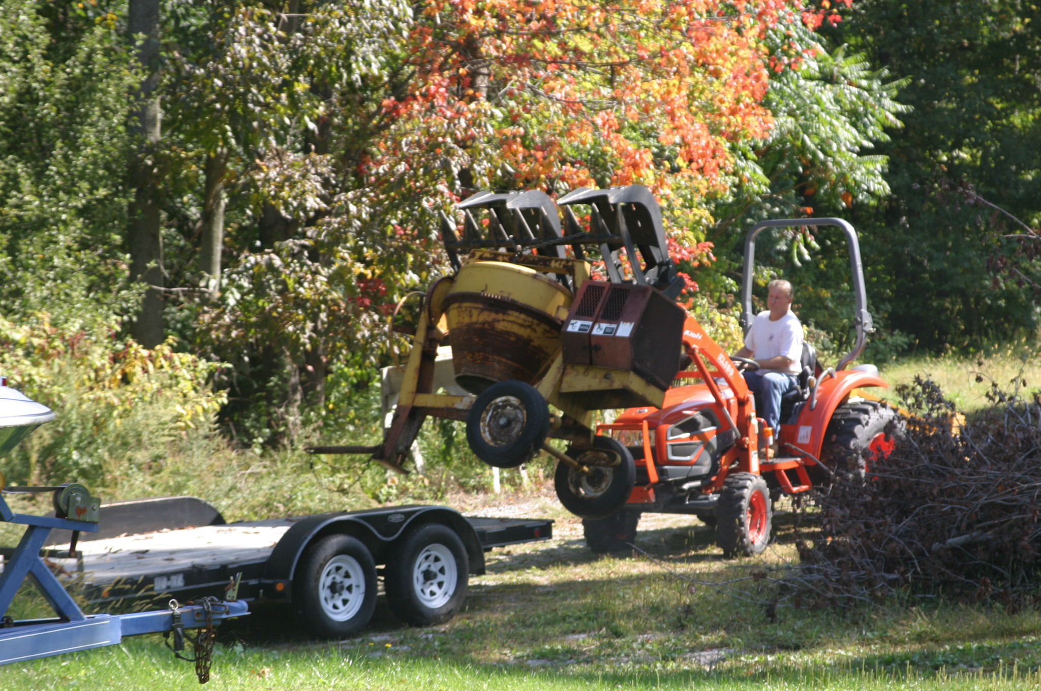

I agree that the clamshell grapple (Bradco, Anbo, WRLong etc) is optomized for brush and especially for picking up individual small bits and pieces. The problem is that they are also very much more expensive than the more traditional root grapple like the Millonzi, Markham/Gator etc. The other big distinguishing "feature" of the clamshell is that it can only hold it's load with hydraulic pressure while the traditional open root grapple can use gravity to hold a load.
The way to use a traditonal root grapple in brush is to cram the stuff into the gullet which allows probably a bigger load to be carried than with the clamshell even though the clamshell can pick up individual pieces more easily. My own technique is to collect small bits of brush into a pile and then take the whole pile at once. When you have a big pile I think the standard grapple can actually carry more.
