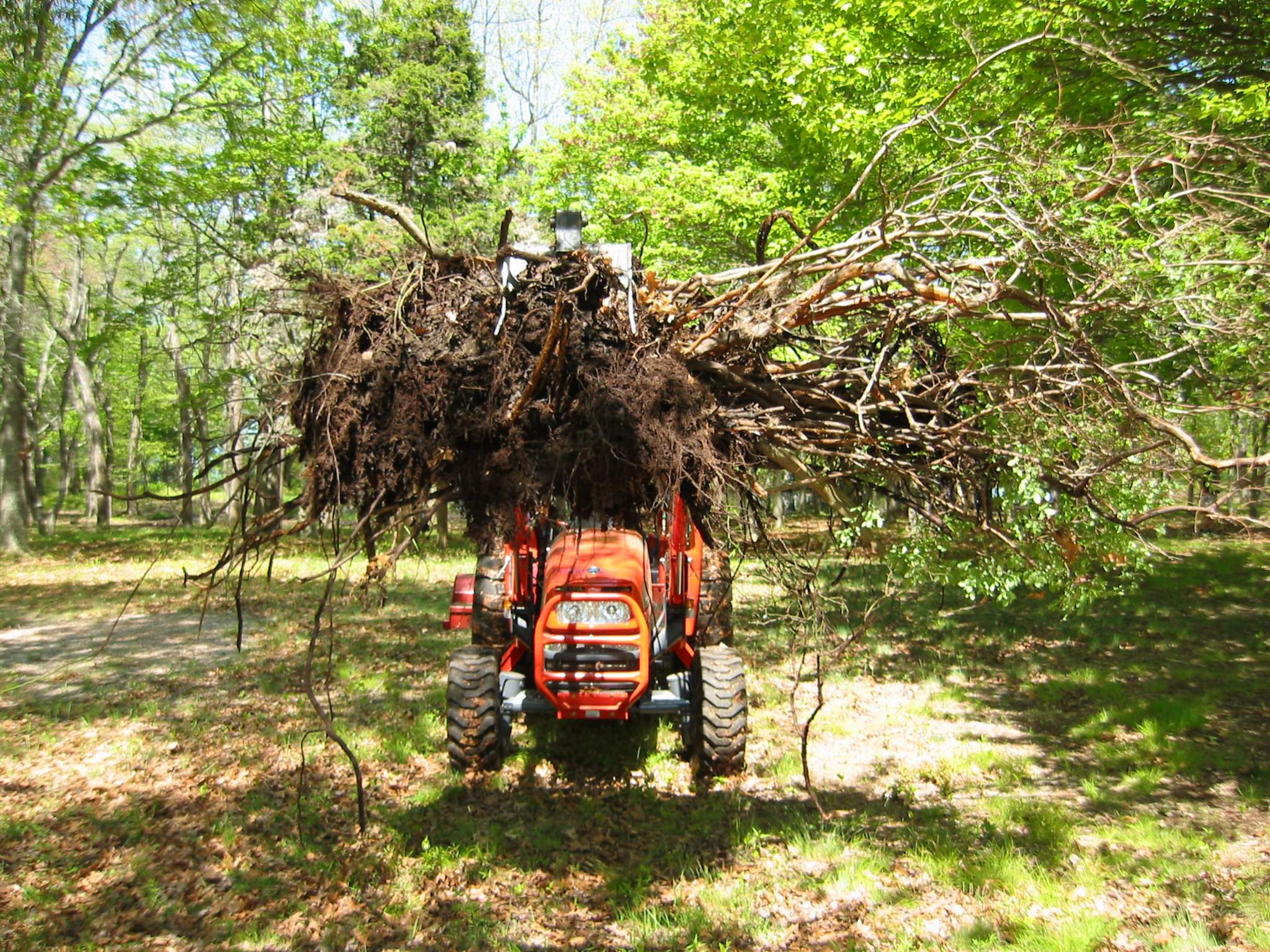

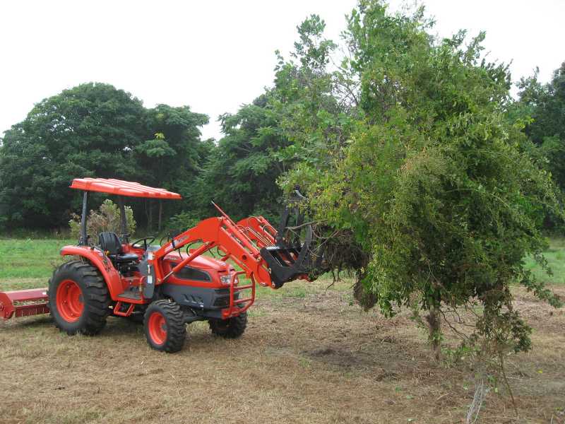

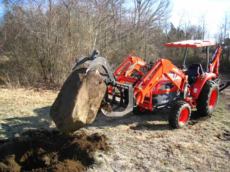

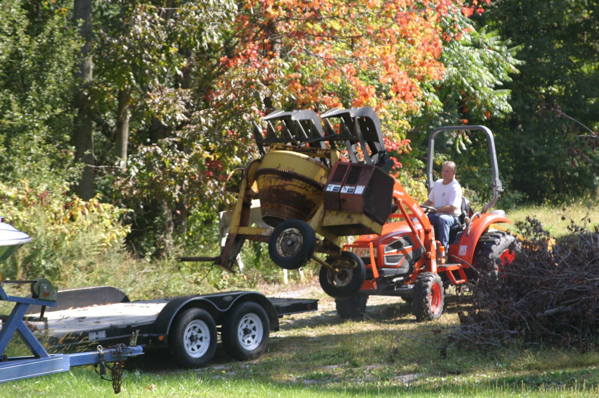

650lbs is way heavy for a CUT grapple. What do you intend to do with it?
A 48 or 60 inch Gator style grapple with single upper jaw even with 1/2 construction would probably weigh only 450lbs and would stand up to about anything your tractor could dish out in terms of lift/breakout etc.
Not sure what Gator would charge but probably in the range of $1300 or so. I'm guessing the 5 foot double jawed BR costs over $2K.
Here are examples of what you can do with a 300lb 3/8 inch steel 48 inch grapple (Millonzi, no longer made but basically similar to the light duty version of the Gator/Markham grapple). Tractor is Kioti DK40se with lift capacity of 2700lbs and breakout somewhere around 3500lbs.
