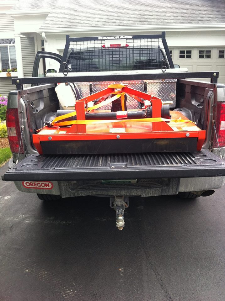

So ended up picking up the Countyline 48" model from Tractor Supply this afternoon... and quickly realized I should have asked more questions when I was there, as I need to run out in the morning to pick up gear oil, a couple 15/16 wrenches/sockets and a center pin for the mast. I did pick up the lynch pins but forgot or didn't realize I needed everything else. Ah well, a good lesson and I'll be out the door early tomorrow.

I have never seen a CountyLine PTO implement in a TSC lot without RUST on the PTO splines.
Get a spray can of Blaster penetrant and give the splines a good soak prior to connecting the PTO shaft to the 'hog.

Actually have a can of that already... go figure.
I will add that to the prep list; thanks for the heads up

I can't tell in the pics if you have a slip-clutch or shear bolt. If it is a shear bolt pick up a couple of extras, while you are there ,or you will probably going to end up returning to get them.
