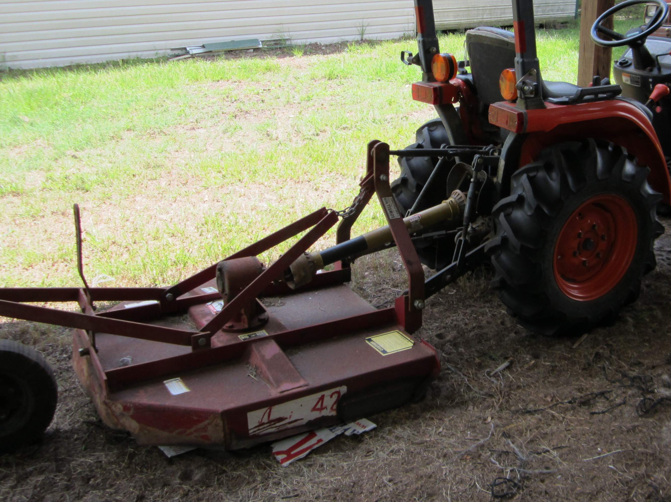

   / Brush hog top link redux! #15
This the small bush hog that came with my B7500. It has chains built into it, between the top link hookup and the frame. It might not work in a bigger mower, but it keeps the back from digging in going over rough ground.

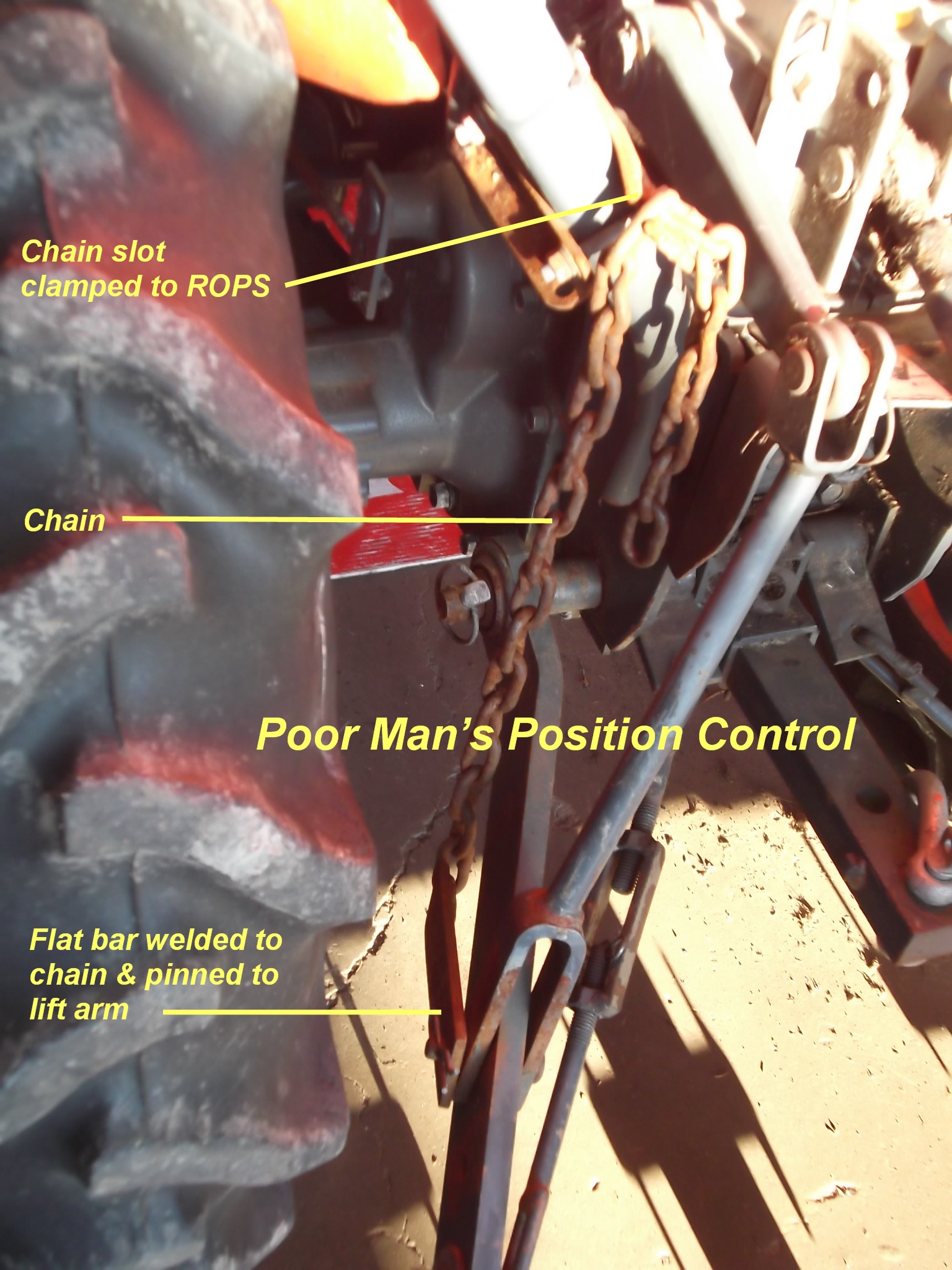

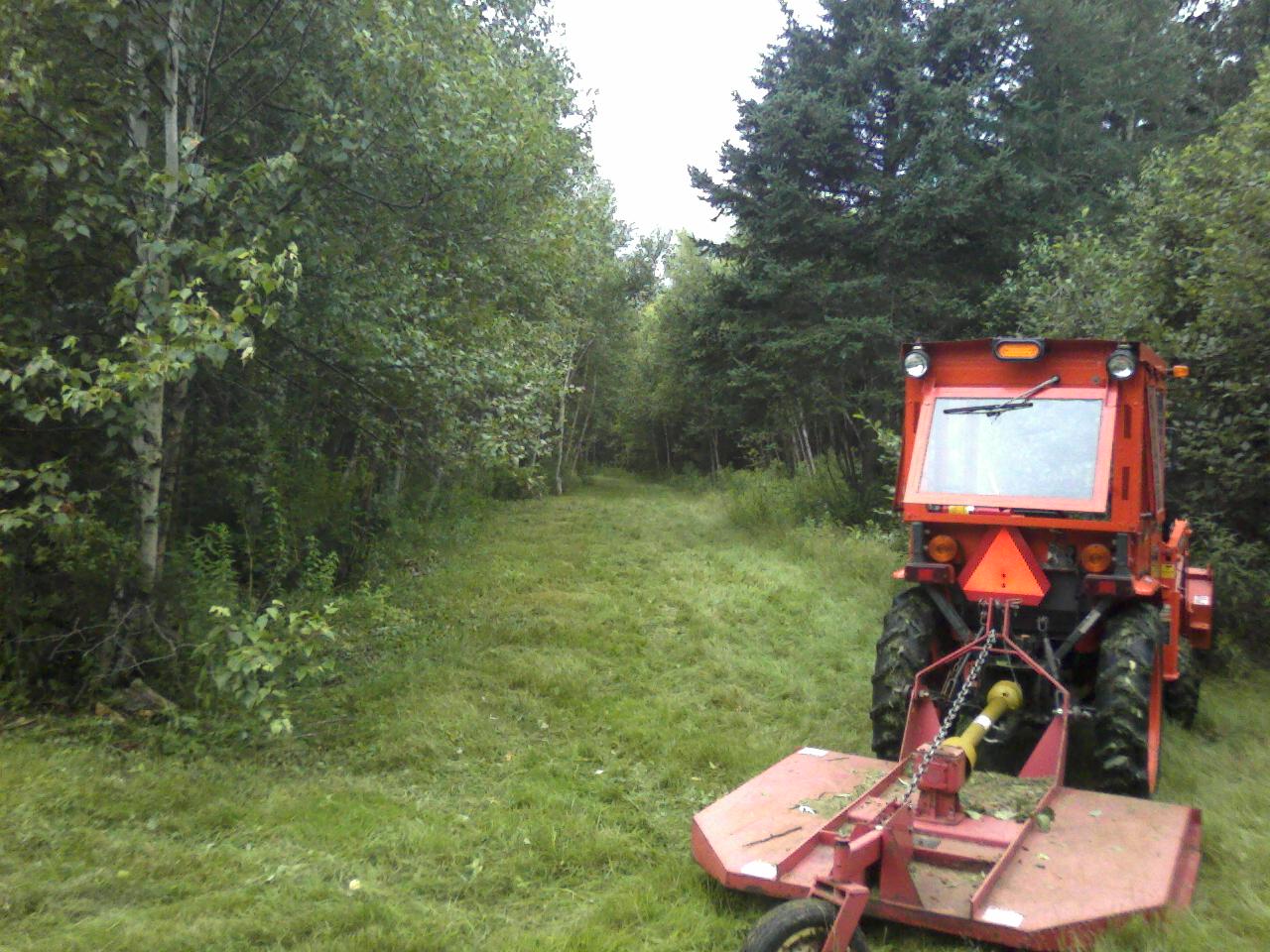

   / Brush hog top link redux! #17
My cutter came from the factory with a chain as the link between the TPH toplink and the rear of the deck. Since my tractor does not have position control, I installed the Poor Man's Position Control (PMPC) to set the front height to avoid gouging and maintain a consistent cut. Works like a charm. The PMPC came from my scrap pile...as TBNer Renze says "free scrap is a good investment".
