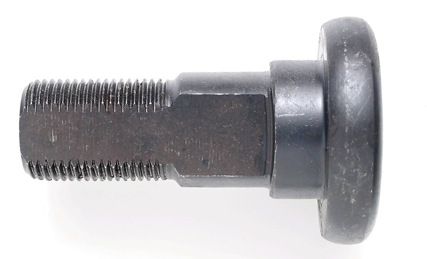

I seem to be having the opposite problem of most people. I have an old brush hog (FMC Sidewinder) that I've used for the past 4 years. I use it for pasture mowing and cutting down weedy parts of hay fields, but also for mowing brush that grows up in our woodlot.
So far this year I have had a blade come off 4 times. I've had good luck finding the blade but keep losing bolts... I just tried putting Nord-Lock washers on both blades but had a blade come off even with those! Every time I tighten the nuts I use a 3/4" drive T-bar with a 3ft pipe and torque it down as hard as I can. I'm nearly at wits end and am seriously considering welding the nut on the bolt. Any suggestions would be greatly appreciated.

Are you sure your using the correct bolts for your cutter, most of the side winders I’ve had use the bolts with a flat side.

I'm using the type with a raised portion that keeps the bolt from spinning. It looks like someone redid the bolt holders at some point before I owned it.
ATRC11 Blade Bolt Kit at Tractor Supply Co.
I would think this would work fine since it keeps the bolt from spinning.

Redid the holders as in how?

From what I can tell the holes in the original stump jumper got stretched out so there is a 3/8" plate welded on the bottom and a 3/8" plate welded on the top of the stump jumper that holds the bolt. These each have a 1 1/8" hole drilled in them and the bottom one has a small part machined out for the crimped "tab" on the bolt that keeps it from rotating. It's very heavy duty.

You probably need a cotter pin through the bolt after you put the nut on. Do you have a hole in the bolt at the end? If so, use a castle but and a cotter pin

atcNick, There is no hole for a cotter pin and it isn't a castle nut.

Here’s kinda what it should look like

Hmm... man. I would think that’s standard. I wonder how easy it would be to replace the shaft bolt. I had the same problem as you. It was constantly falling off... once I realized what the cotter pin hole was for I haven’t had an issue since

I would get another brush hog, before something, or SOMEONE, gets hurt. I would NOT take the risk of keep using it. You have been lucky four times. Two would have been my limit.
