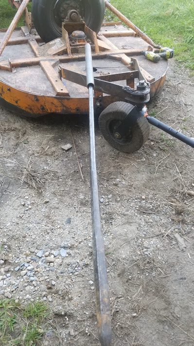

Well everybody, I got busy with 2nd cut hay and didn't have a chance to use the brush hog until the day before yesterday. What seemed to be the issue was that I was under-torquing the nuts. Apparently 4 feet of leverage wasn't enough. I put a rock bar in the open end of the pipe to increase leverage to ~9ft and tightened the **** out of both nuts, as well as reapplying loctite, still with the nord-lock washers installed. So far the nuts are staying tight as can be after taking out some bushes, small trees, and hitting quite a few rocks. Now to address some more specific comments:

As far as the whole grade 5/grade 8 debacle, I'm a mechanical engineer who grew up on a farm, so I have some experience there. Grade 5s are used in suspension and safety critical places because they STRETCH and give warning before a failure. They also commonly use grade 5 bolts for tightening heads to an engine block as they stretch predictably (torque to yield). Grade 8 will break swiftly and with little deformation, but are much harder to deform and break. All of the rotary mower bolt/nut sets from tractor supply that I have looked at specify grade 8 (e.g. ATRC11 Blade Bolt Kit at Tractor Supply Co.). Of course, even among grade 5/grade 8 there are different types of steel/hardnesses that can be used as all that the "grade" specifies is minimum yield strength.

Below should be a picture of my torque amplifier...

I would tighten the nuts as tight as possible and weld the bolt/nut together on the top. The idea of a blade flying off at PTO rpms isn't appealing.

I thought maybe that was not enough torque using that short a bar . Helping my brother replace bearings in his large disk , ( 12' , 14' , 16' ??? , just dang big anyway ) , We had a 3' breaker bar , ( 1" drive ) with a 12' piece of pipe slipped on it and both of Us bouncing on it , ( Total weight of the 2 of Us , maybe 340 ) . No idea what type of torque We were applying , but the nuts would " Pop " and almost drop Us both to the floor :laughing:
