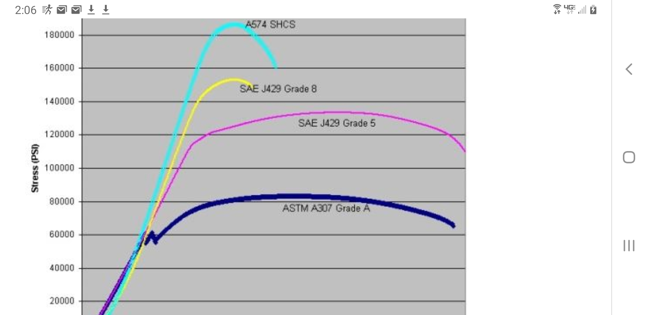

Hillbilly, they are grade 8 blade bolts. I've retrieved the bolts and they are not broken or stripped other than the last 2 or 3 threads. The nuts are definitely loosening.

ArlyA, I did spray with brake cleaner and let dry before applying loctite. I'm leaning toward the possibility that the bolts should be left hand threaded. The one unusual thing about the Sidewinder is that it is driven by a large tire that presses against the blade hub and acts as a slip clutch. This innately reverses direction of rotation whereas a 90 degree gearbox may or may not depending on construction.

As for the left handed bolts, it’s not going to make a difference, most twin spindle cutters the left and right pans spin in opposite directions yet both have standard right handed bolts, and I’ve not had a issue with them coming loose.
