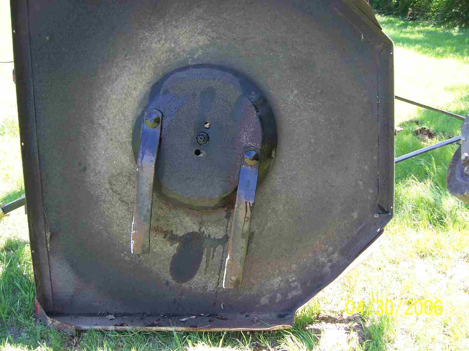

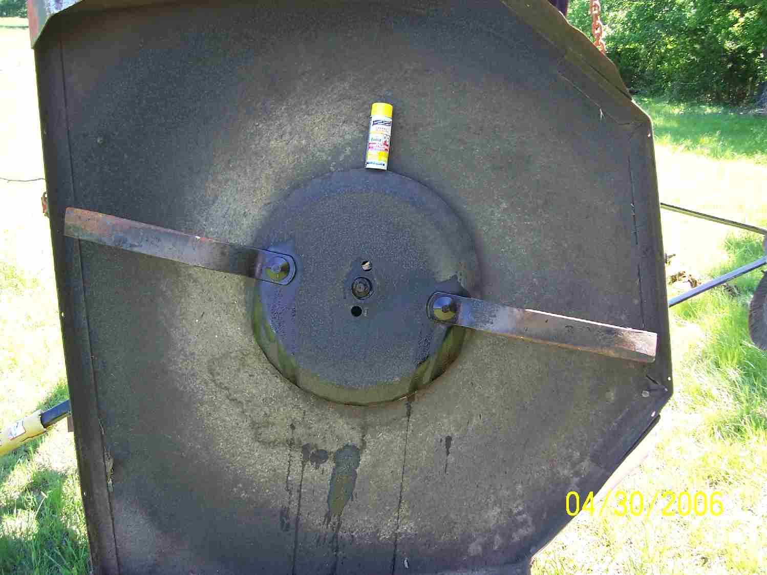

The main reason I raise mine up is my blades tend to stick over the winter. Raised up I can unstick the blades and sharpen them easily.

Got it done.
Since I had the tractor on the trailer, I just raised up the deck and had plenty of room. I gave it a quicky this morning since I had a pasture to finish up. I am going out now to really work on it. I have been mowing with it for 2years now and never have sharpened them. Those T-post, concrete blocks, piles of bricks, etc, that you never see until it's too late can really do a number on the blades. Thanks for the help.
