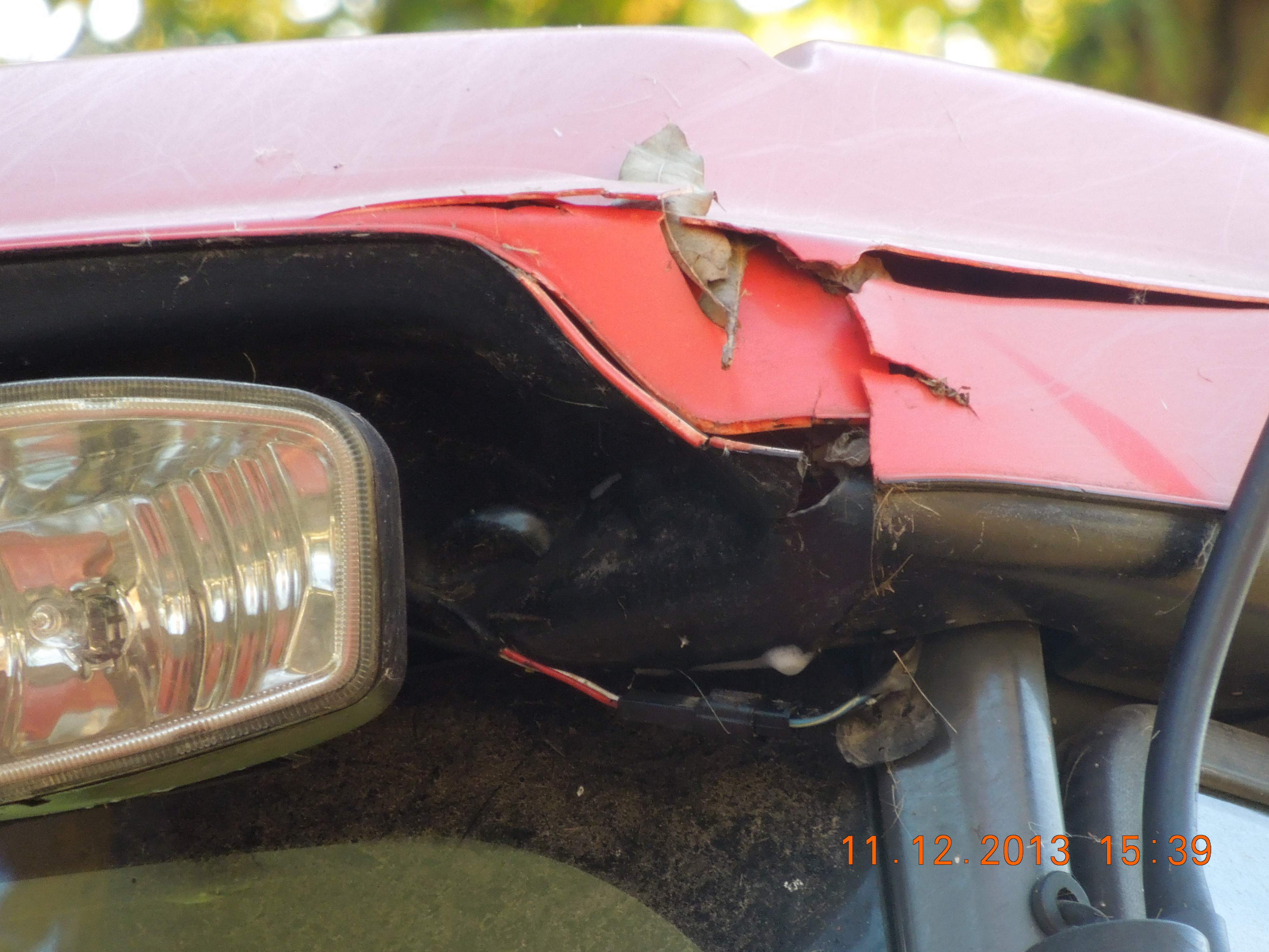

I wasn't sure where to post this or how to do the photos, so.... After knocking some holes in my cab, my brother repaired it and put brush guards on. It is designed for easy removal and uses steel tubing. I didn't do any of the work, so I don't have specifics. This should work to generate ideas regardless of the make/model of your tractor.

Just an FYI for those who have been told a Kubota cab top cannot be fixed, buy a new one, this is what the top looked like before my brother fixed it, damage on both front corners with most on the left front.
