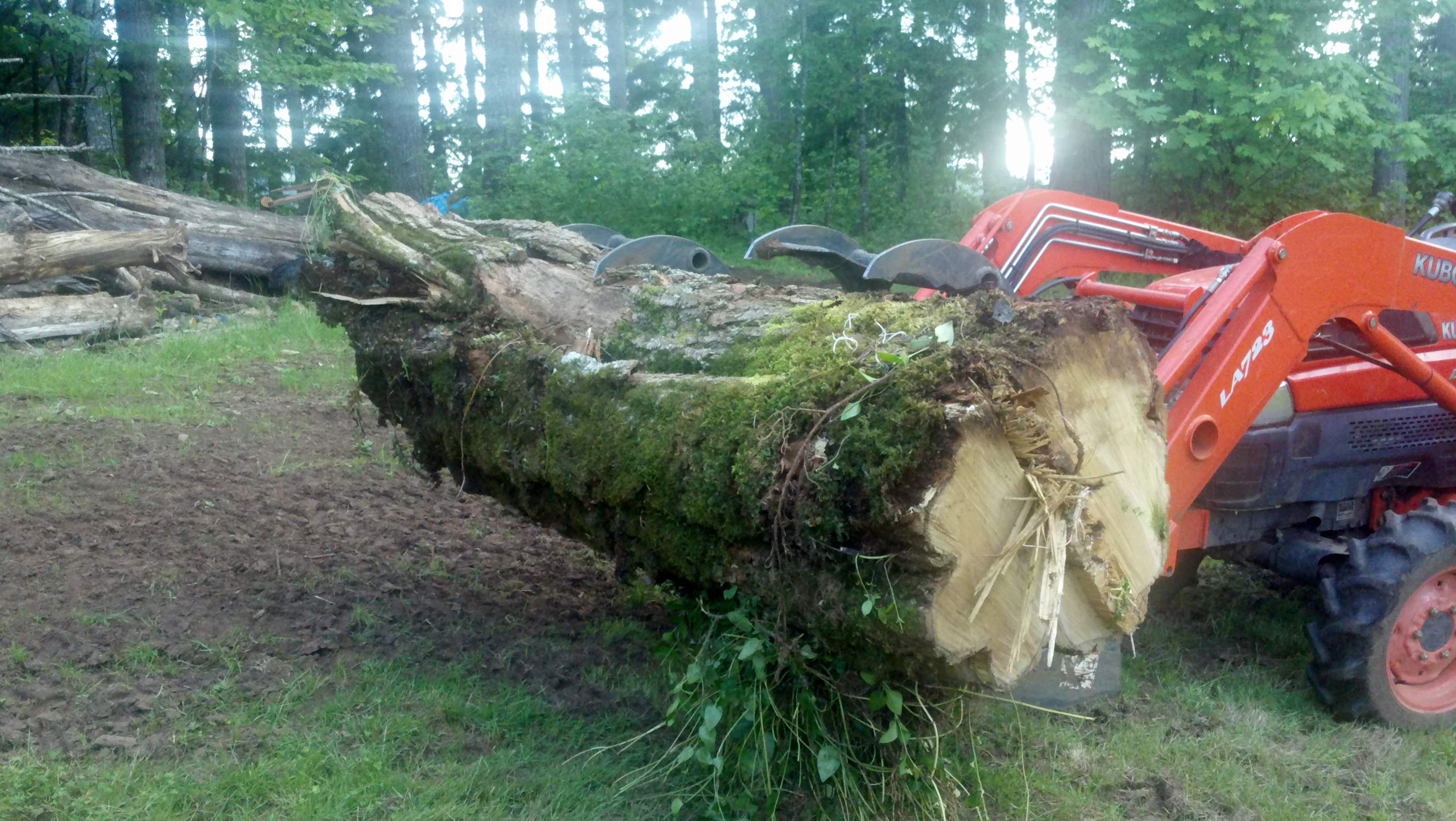

Two years in with a MIE 48" single lid grapple (vs 60" bucket) on the very light & limited (lift) NH. (two yrs late to review same, but wanted to back up my points with pics, etc)
I never feel like the 'narrow' tool is lacking in any way, more often wishing I had more tractor to work it with. Sure was handy for adding ballast to the Deere for the o/sized FEL.

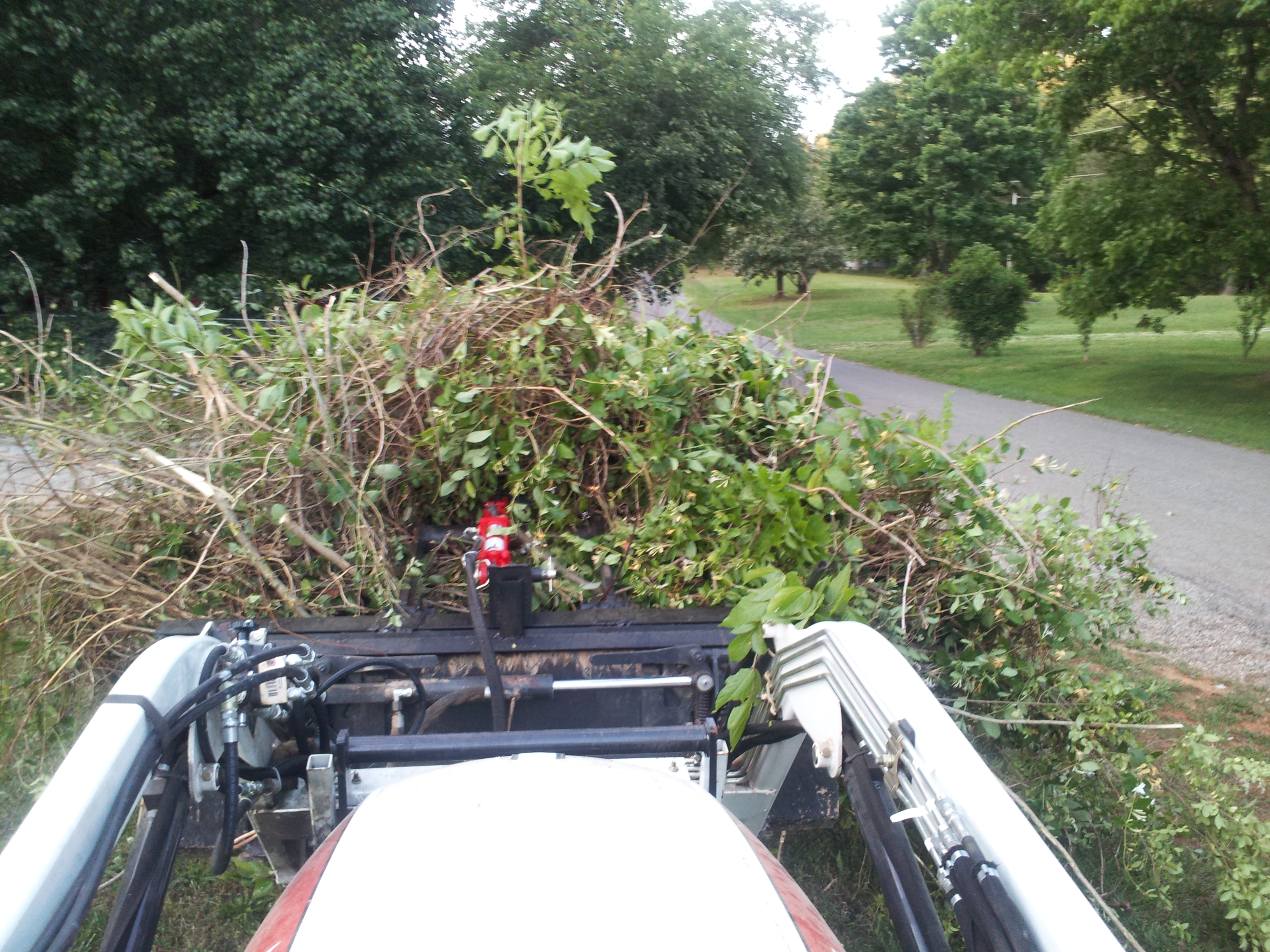

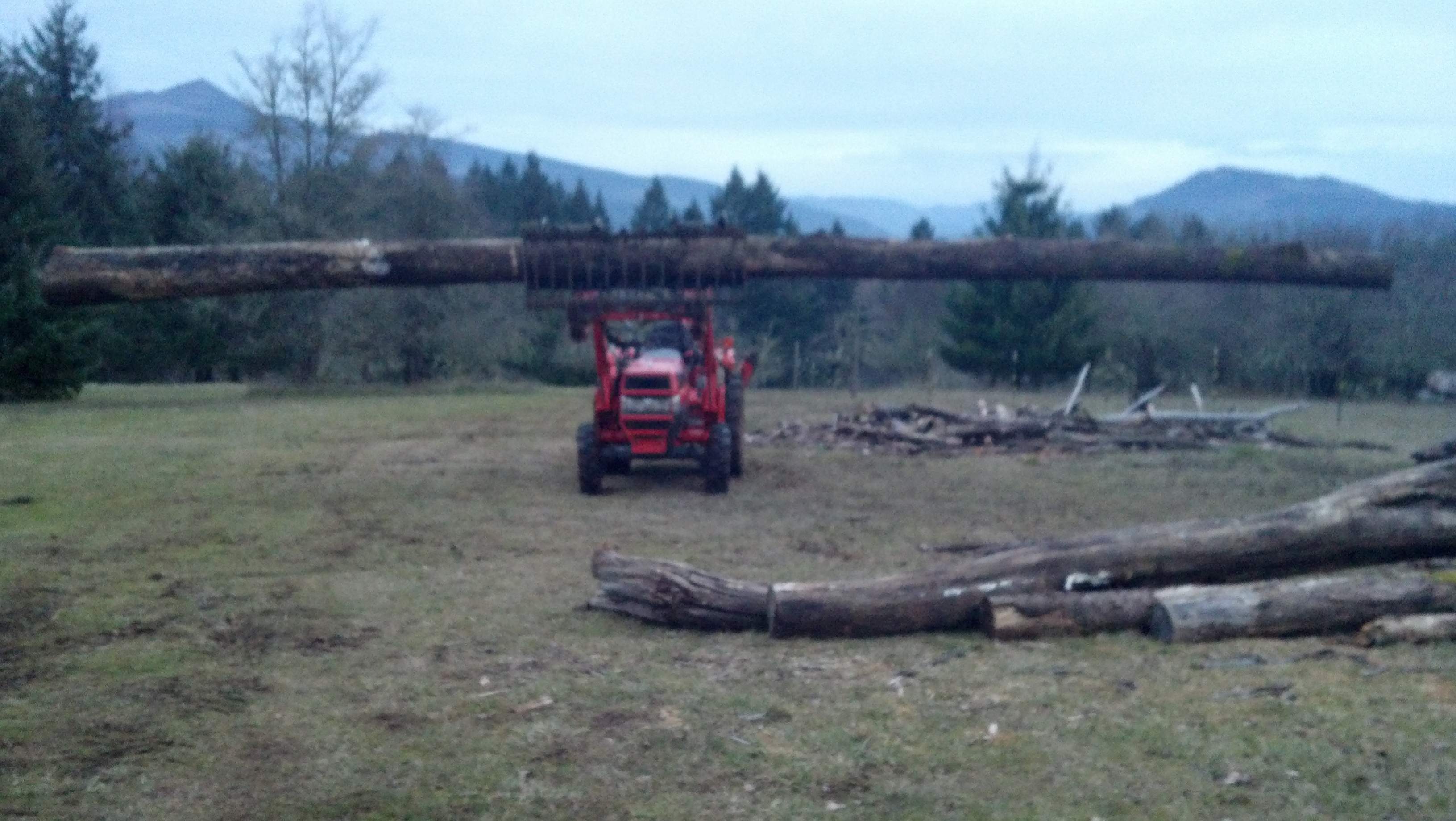

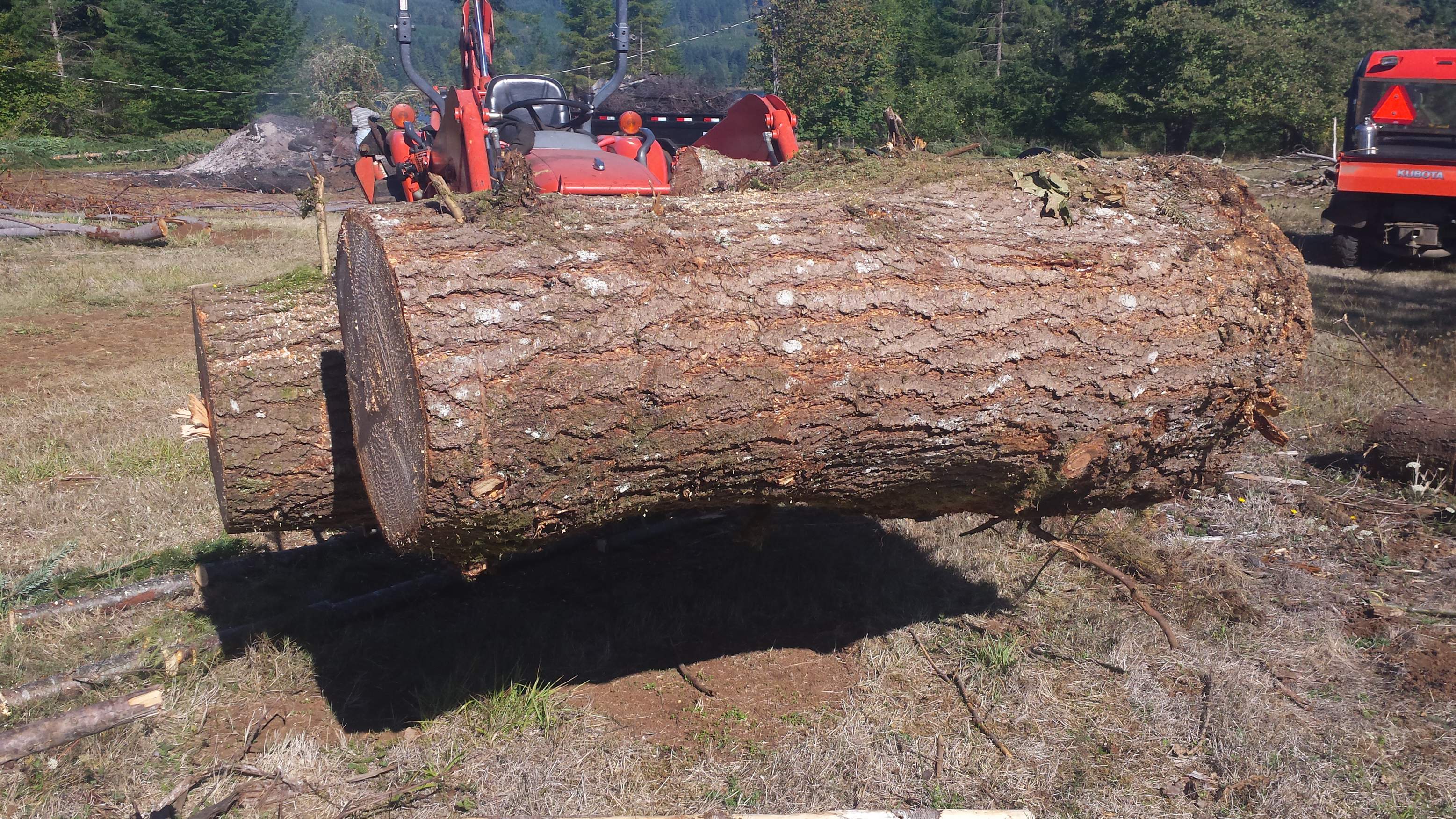

I have a 72" dual lid grapple and find it is just right for brush. Brush is very light for its volume, and the larger grapple is not going to limit the amount you can lift. Essentially a pile of brush too heavy to lift with the grapple is way to big to fit into the grapple to start with. Mine started life as a rock bucket and is built very heavy, but I have never run out of lift capacity, which I suspect is about the same in my machine as yours based on HP. Narrow tine spacing is a decided advantage in handling brush also, since smaller pieces don't fall through. Mine is 6" or 8" and I like that.
As far as logs go, the only log I could not lift was 20' long and about 20" in diameter. Everything smaller has worked out just fine. The wider grapple has the advantage that I do not have to be as careful to lift a long log exactly at its center of gravity. Yep, this torques the loader arms, but I have never bent them. And for firewood, I can lift a long log and have another guy cut 16" long pieces off one end while standing in a pickup bed or a trailer and they will fall into the truck. Saves a lot of loading. When the log gets too unbalanced, back up and hold the other end over the truck.
There is little advantage in being able to drive forks under a pile of brush. I lift the grapple open it fully and drop it onto the pile from above like a clamshell. When I close it, everything is picked up. This is also how I pick up most logs. If the log is not exactly perpendicular to the grapple I can roll it forward and close the grapple to get it perpendicular.
Depending on the day and the job, I use the bucket, the grapple and the forks about equally. Forks are cheap.

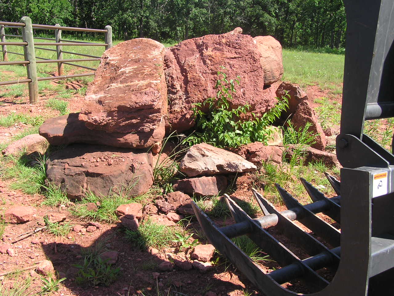

Well, I finally got my grapple! Thanks to all that posted previously in helping me make my decision. A local Mennonite welding/fabrication shop built it for me. Design and build quality is excellent. Cost was $1,100.00 including cylinders and hoses. I went with a 54" unit since most of you guys said to stay on the narrow side. It appears to be a good fit for my set-up even though my tractor and loader function could handle a wider and heavier unit. I'm currently running the hydraulics from the rear remote. It was another $125.00 for hoses and couplers. I also made an extension for my RR valve (similar to that made by k0ua) from materials laying around the shop. I guess a diverter valve or true third function kit might work a bit slicker, but this is working just fine for me right now. I wish I had one of these years ago!
Rick
