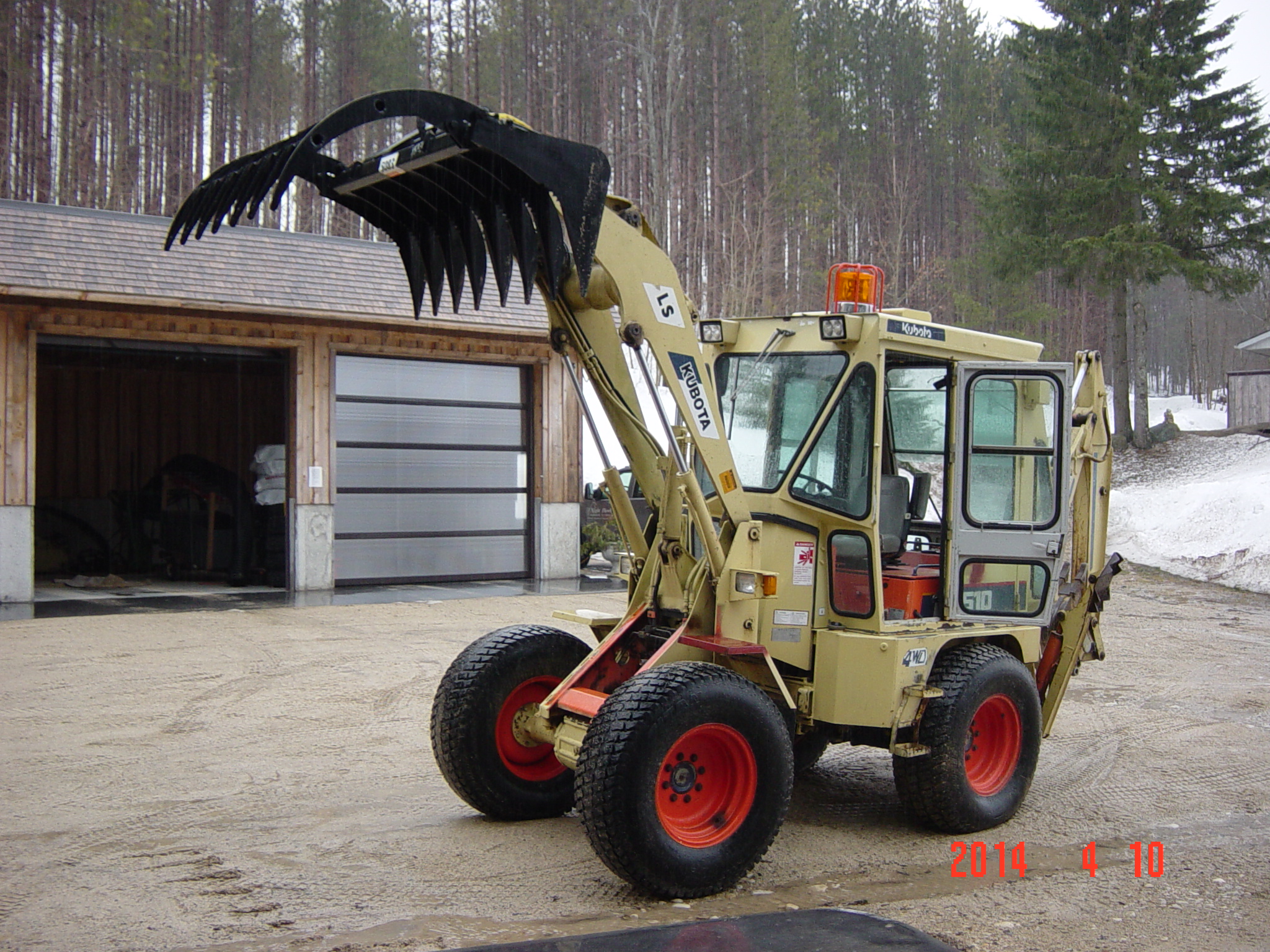

I don't have pictures of it in the grapple, but I am talking about small pieces of brush, like this.
Here are 4 rocks that I picked up in one trip. I wouldn't want to try it on the forks.
/ Brush Grapple Preferred Width? #32
So am I, you just have to put the folks closer and it will jam up and stay on them, but I'm sure you won't get as much per time of that small stuff that you would get with something else... Small price to pay for all the things that the pallet forks/grapple will do and do better than a dedicated grapple.
The rocks, that's less of a problem and I can get a pretty good load of those...
