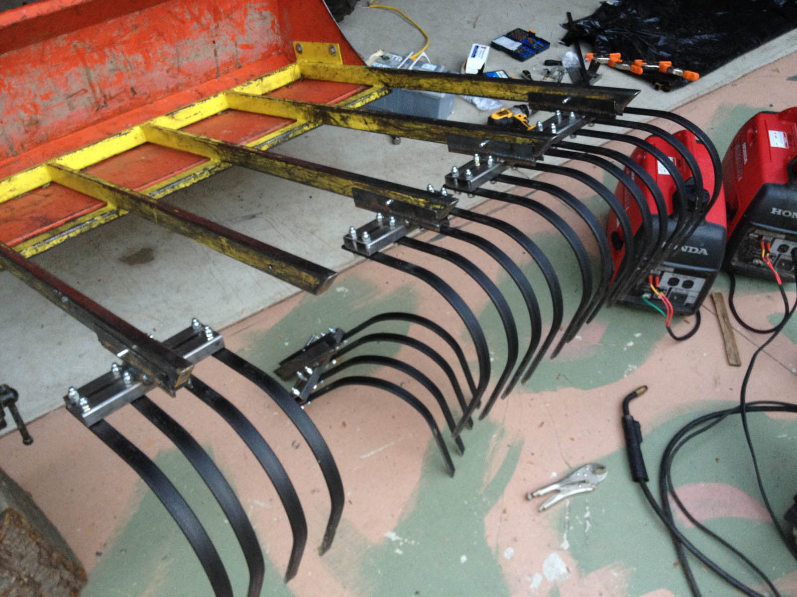

Hello,

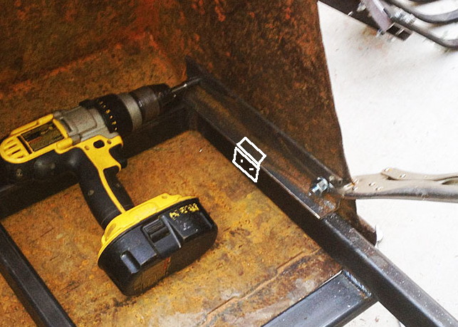

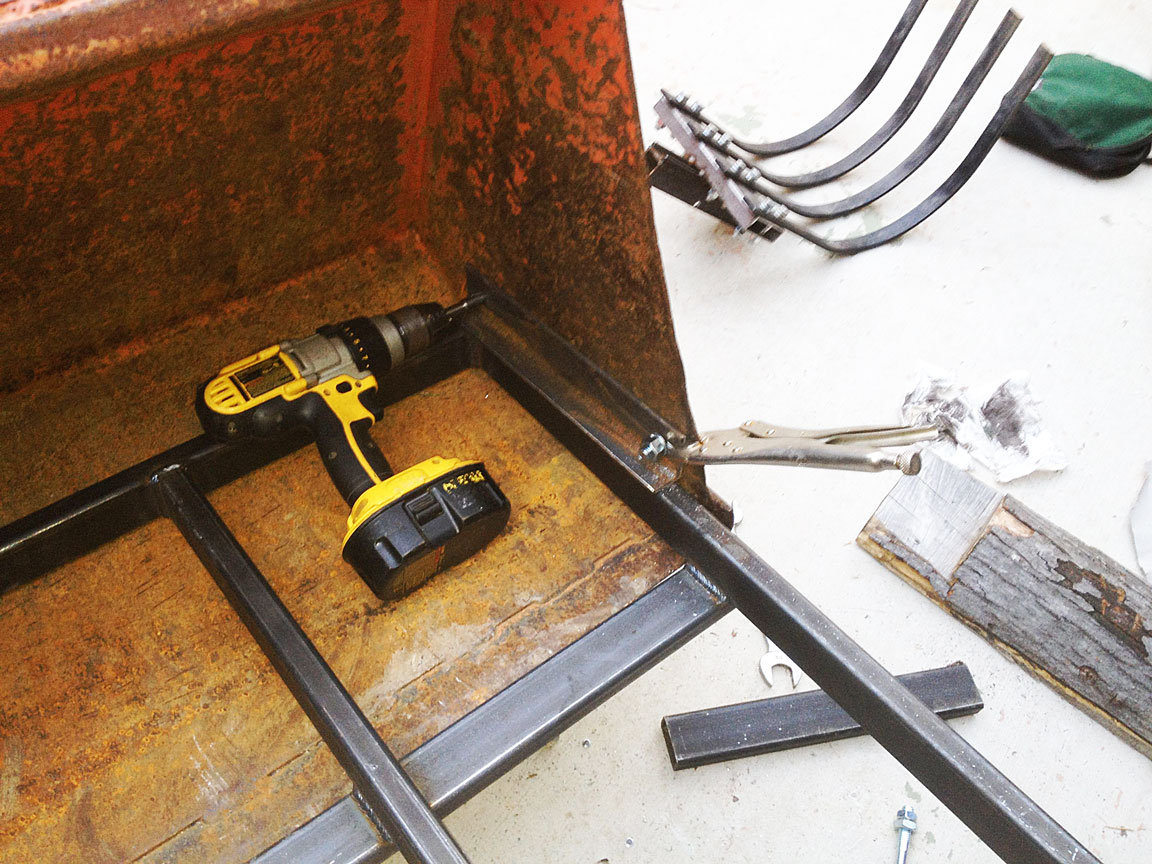

Yesterday I built this brush fork for my B2710. There are two 12" long angle irons bolted to the sides of the bucket, creating a 'slot' in each corner that the brushfork slides in or out. At the moment there is no retainer, if I tip the bucket down the fork slides out.
378206d1401939641-brush-fork-quick-attach-ideas-brushforkb2710_72-jpg
Looking for ideas how to retain it in those slots. I could put a pin and clip in each side, (thats 4 peices) and takes several operations to accomplish each time, and parts can get lost.
378205d1401939641-brush-fork-quick-attach-ideas-brushforkb2710drilling72-jpg
I prefer a single operation, and no parts to lose. I want to be able to jump off the tractor and install/un-install so I can choose either the fork or the bucket with ease.
Ideas? There are ways to do this. I'm sure many members have seen (or created) clever quick-release methods and I hope you're willing to share before I choose a substandard method.:cool:

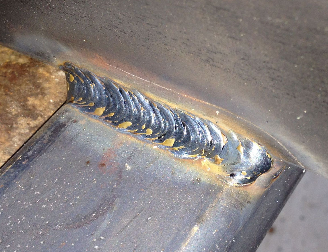

The material is 1x2 x .120 rectangular steel tubing. The welder is a Miller Multimatic 200 running on 120v.

My first idea:
Put a sliding or rotating piece of metal on the rear crossbar near each end so it moves behind the angle to stop the forks from sliding forward.
Second:
Fasten a spring hinge on each side fork about 6 inches from the rear. Notch the angle iron about 1/4 or 3/8 deep over it. The spring hinge latches into the notch in the angle iron so the forks stay in.

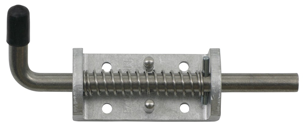

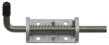

An electromagnet controlled from the dash would be really cool! But if you don't want to do that what about something like a push button quick release pin?
McMaster-Carr

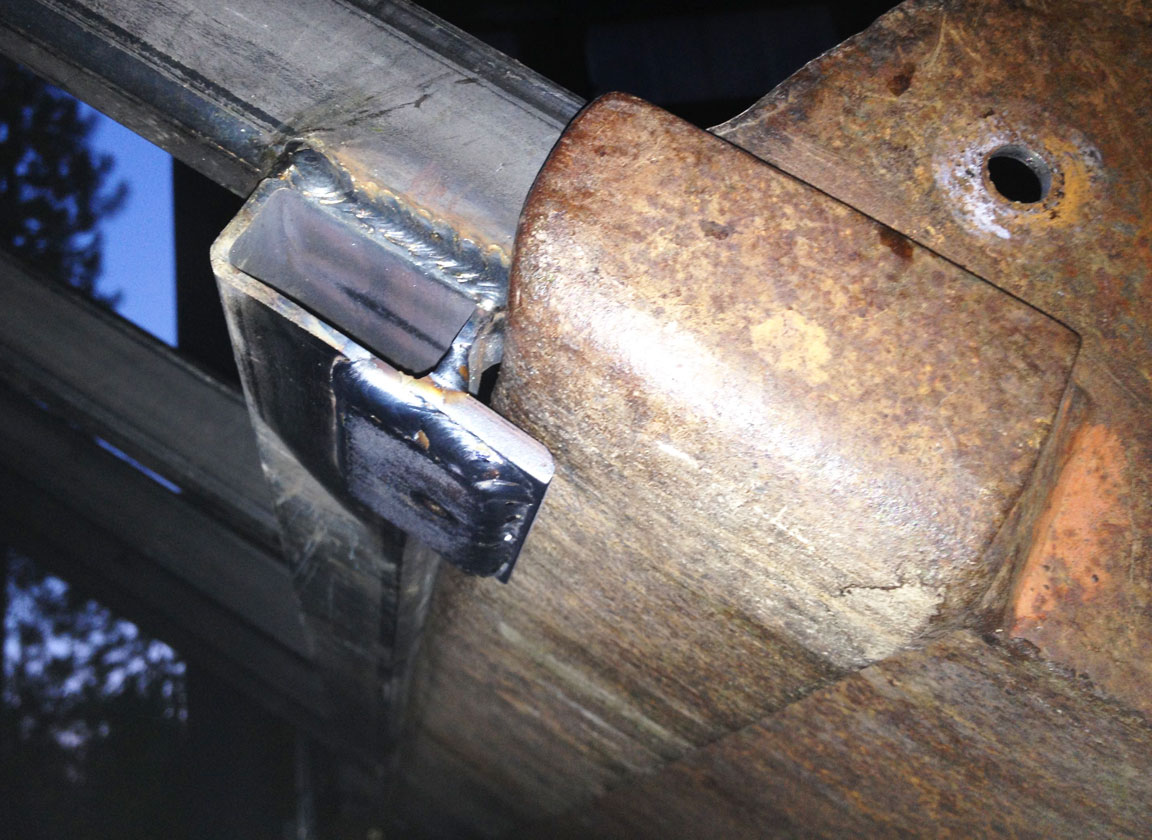

Funny you should ask today - I'm working on it today. I decided to change things a little. The 12" "slot" is too long and tends to bind up sliding in. No need for that much engagement, it just adds time at instl & removal.
I cut the 12" slot to 4" (just shortened the angle-iron), and added a tab that engages the cutting edge to spped up my "quick release" theme.
389558d1410150362-brush-fork-quick-attach-ideas-brush-fork-tab-jpg
Still don't have a 'retainer' worked out, will get that done tomorrow. Hoping for a solution with no loose, fragile or foul-able components.

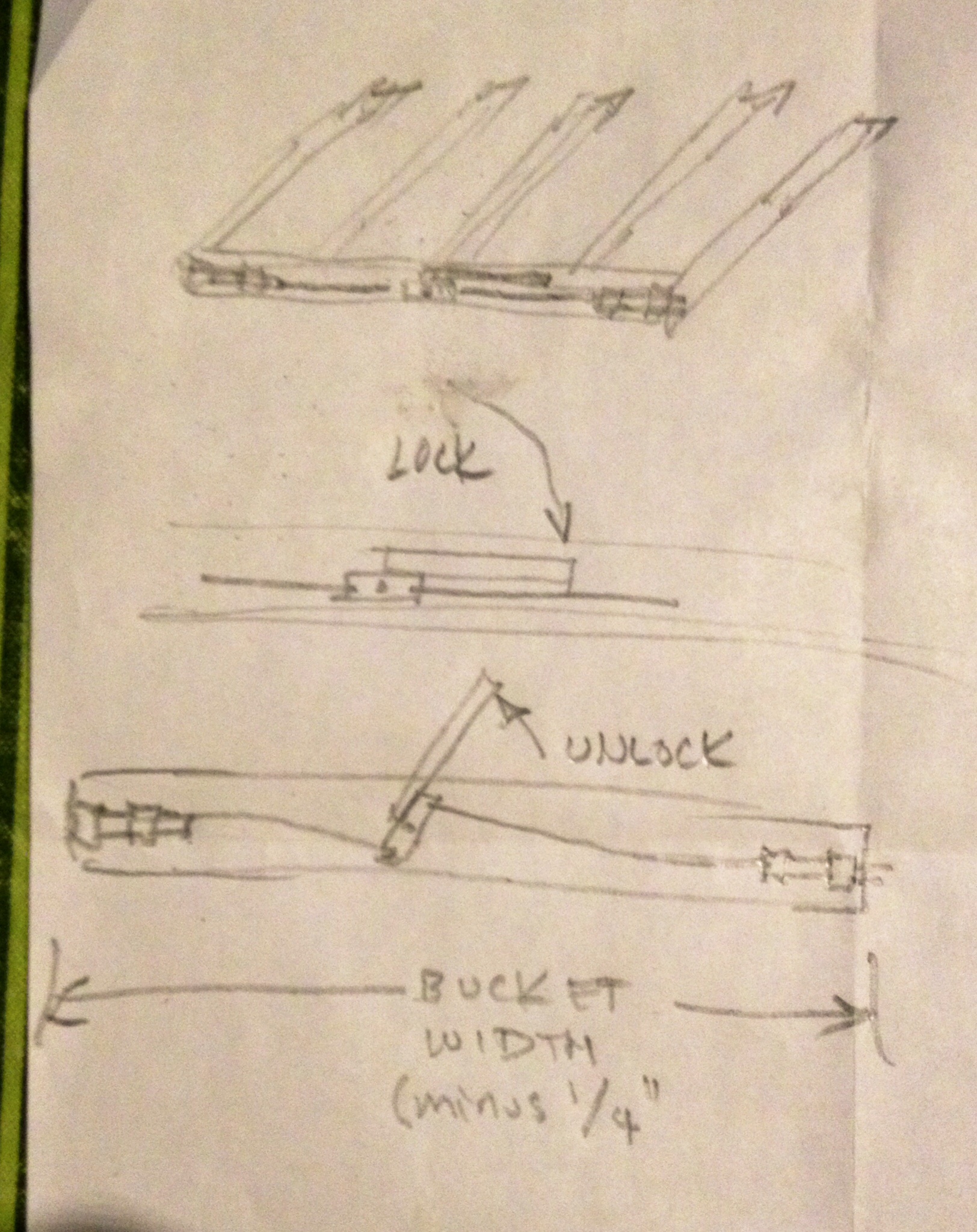

Ok here's my current plan. Got a big cleanup job this week so I'm gonna spend hours in the shop to save a few minutes on the job. :D
After using the fork for some time I've decided to delete the angle irons (no channels). Wiggling the brush fork into channels is unnecessary, it inevitably binds and adds time. I want quick release thats truly quick.
Plan is to use just one lever in the middle of the rear member to engage 2 larger pins/holes at bucket corners. This lever will reside in a well protected area at the rear of the bucket. So the fork will hook over the cutting edge at bucket front corners, & engage a pin/hole at rear corners. The bucket is strong at these locations, a good place to engage.
And no angle irons inside the bucket to hinder cleanout.
The latch is well protected inside the bucket, but vulnerable when not in the bucket. Must be beefy enough for the "rough handling damage" when its not in the bucket.

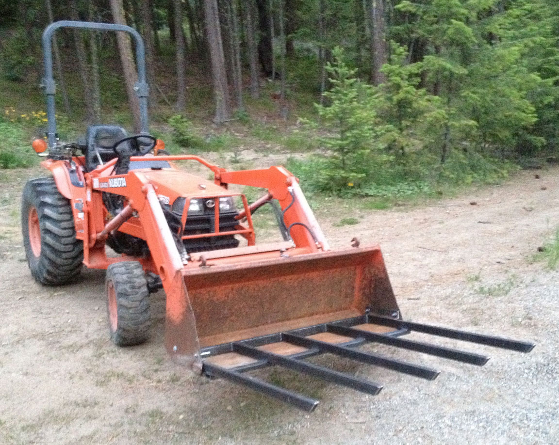

Looks good, what is the material size you chose? How long are the tines? If you can make the attach 'symmetrical' you can flip the fork over.
I've made 2 brushforks, both of them "too long" :cool: . I have to be a little careful due to the length (with logs) but they carry a lot more brush. First fork I made was for a BX24 which lifts 460lbs. Then I got a B2710 (double the lifting power) but couldn't bring myself to use shorter tines. It's been a few months now (and they are surviving) but I'm certain they are afeared!

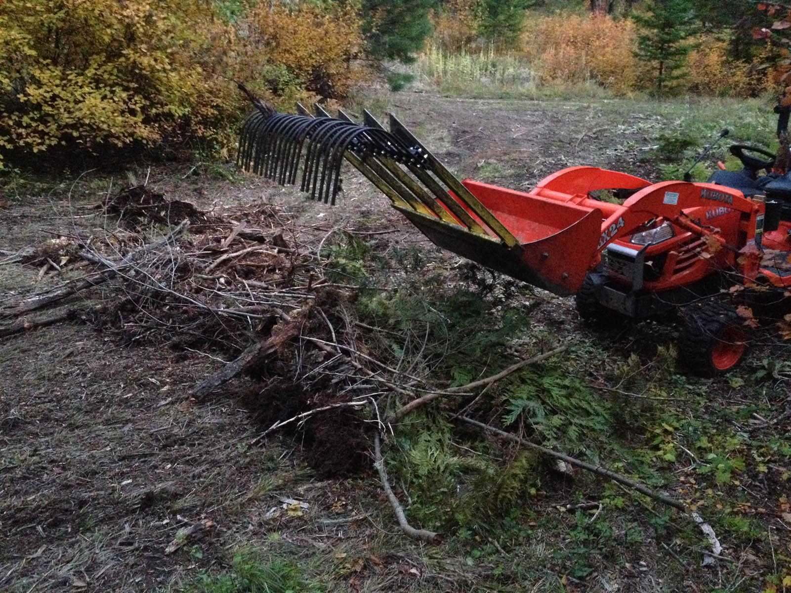

I've used mine with stick rakes, and then after raking up a pile I have to scoop up small stuff so I need to remove the fork quickly, then put it back quickly.
Heres a pic with the forks on my (sold) BX24
