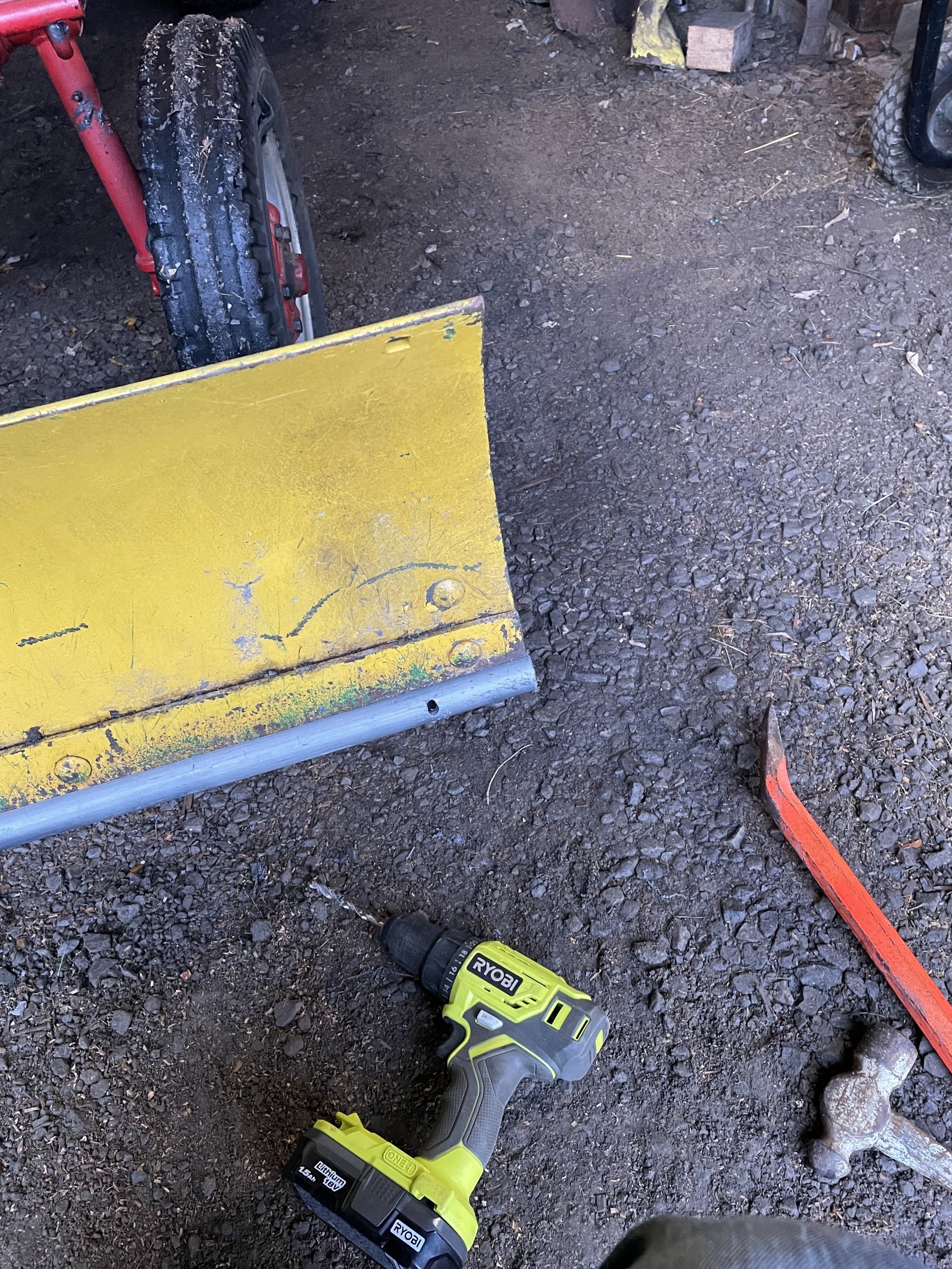

Once again, I did both of our driveways and the neighbors on each side. The 1” pvc pipe fell off at my aunt’s next door. It probably saved me 6 hours of raking stones out of the grass in the spring so it was worth the 15 minutes that it took to make and install.
It got a little damaged, so I’ll probably cut another new one if we get a thaw this winter. I’ll drill a few holes thru it and put in 3-4 1/4” bolts to hold it on. It would probably last a full winter with those.

We are getting a good thaw now, so I am going to cut a new piece of 1” schedule 80 pvc for the bottom of the blade and screw it on. Since the ground will thaw, I’ll need that again, to keep stones out of the grass. I will probably weld repair the damaged tire chain hook too.

I cut and slit a couple more pvc pipes for the bottom of the blade, but no luck trying to drill holes thru the cutting edge to hold it on with bolts. It was way too hard to drill.
Oh well, even if I have to replace the pipes (3) times each winter, they will still save me lots of time raking stones in the spring. It only takes me 10 minutes to cut, slit and install the pipes and I have enough on the pile out back to make about 40 more if I need them.

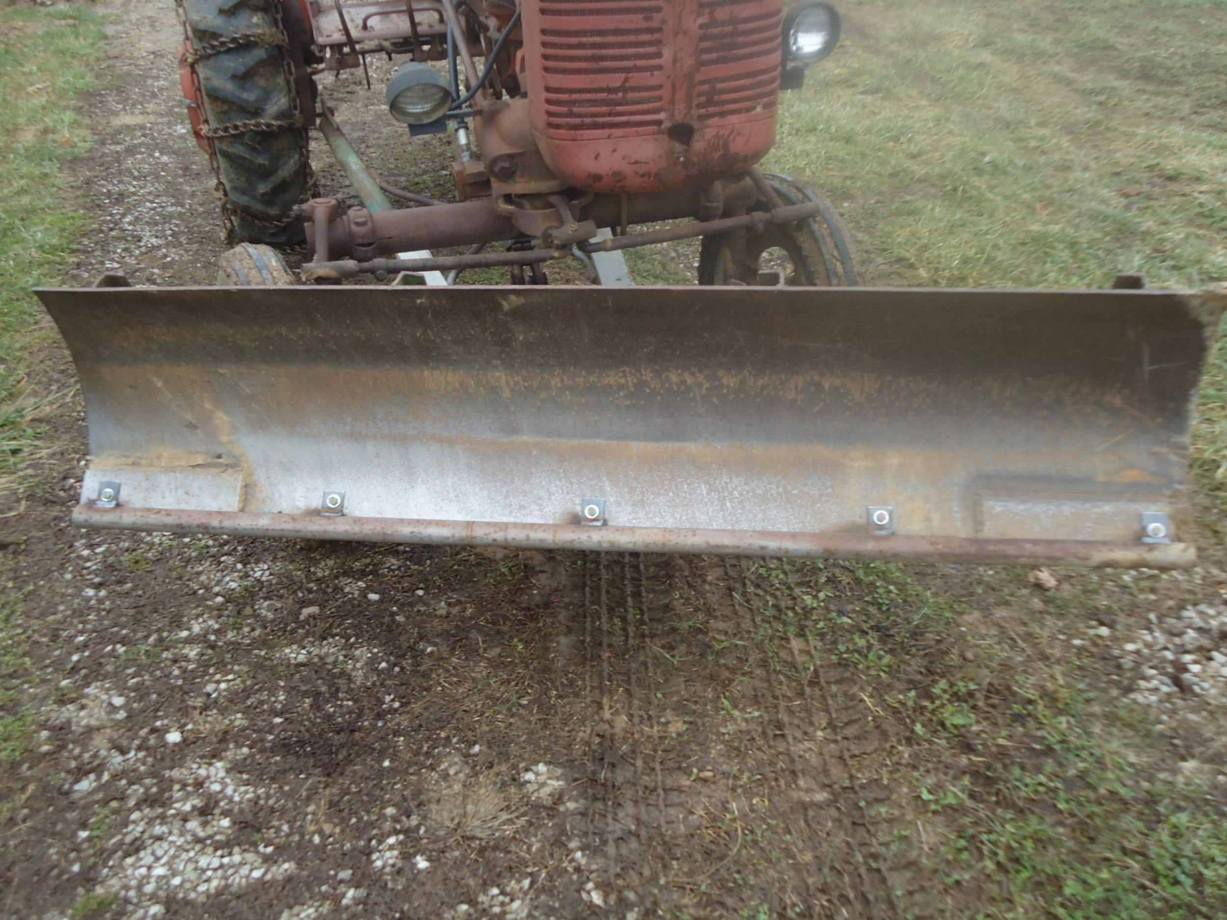

   / Brought 57 cub home today #66
If you notice on mine, I used the existing holes in the moldboard to bolt the tabs I welded on.
Any of your buddies have a plasma cutter & welder..?? Pretty easy to make if you can get a piece of pipe. This was used and something I had I picked up somewhere for free. Tabs I already had too, just leftover flat strap leftover from a previous build. I used an inverted piece of angle iron as a straight edge to cut the slot.
Drilled and cut the front tabs to fit, then welded on. Tabs on the back side were welded on, then drilled through from the front so they would align. Bolted on with Grade 5 bolts.
Material usually isn't that hard to find if you have a metal sales or fab shop close. Both usually have cut-offs/drops they sell pretty reasonable. I seriously doubt I have $5 in this including material and consumables to cut and weld it up.
Considering what I've pushed with mine, it should last me the rest of my life. Now that you see how well it works you can get by this year with the PVC and have a whole year to come up with materials, and someone to cut & weld up something permanent.

I’ve got a welder, plenty of steel pipe in various sizes and scrap steel. Maybe I’ll just slit a steel pipe with a 4-1/2” cutoff wheel. It’s only 53” long so it won’t take that long.
#68
When I slit the pvc pipes on my table saw, I marked them with a chalk line on top, to help keep the cuts on the bottom straight, and I set up a rip fence. It was super fast and easy.
I’d probably use the chalk line to mark the steel pipe before cutting the slit with the angle grinder. I need to take off the blade in the spring anyhow, to weld some side supports on the plow frame, which I’m going to use on my front trailer hitch in the summer. That will be great, with the offset engine and hydraulic lift, for getting my boat back into the barn after a day of fishing.
I’ll slit and weld tabs on the steel pipe (probably 1-1/2” size) while I have the blade off of the plow frame. I’ll have all summer to do that. Maybe I’ll make up two of pipe and tab assemblies. I was surprised how much the schedule 80 pvc wore down on the bottom after plowing with it just two times. I’m thinking I might get 2-3 years out of a schedule 40 steel pipe.

I would think steel schedule 40 pipe will last virtually forever unless you wear it a lot more than I expect
I’m not so sure of that after seeing how fast the schedule 80 pvc wore down after just two uses. Limestone is pretty tough on plastic and soft steel. The plow edge piece is hard, high carbon steel about 3/8” thick and that is showing some wear. I’m thinking I’ll be lucky to get (3) years out of a schedule 40 steel pipe, before I wear thru the bottom. The wall thickness on that pipe is only about 1/8”.
