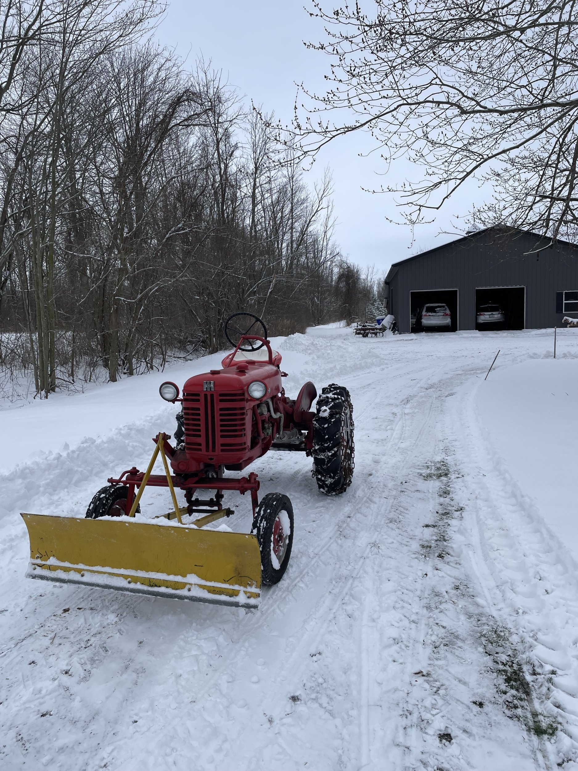

I’m not so sure of that after seeing how fast the schedule 80 pvc wore down after just two uses. Limestone is pretty tough on plastic and soft steel. The plow edge piece is hard, high carbon steel about 3/8” thick and that is showing some wear. I’m thinking I’ll be lucky to get (3) years out of a schedule 40 steel pipe, before I wear thru the bottom. The wall thickness on that pipe is only about 1/8”.
There really is no comparison between the PVC and the steel

Maybe so but what about the high carbon steel cutting edge that is also showing wear ? That makes me think I’ll be lucky to get (3) years out of a 1/8” wall thickness low carbon steel pipe.

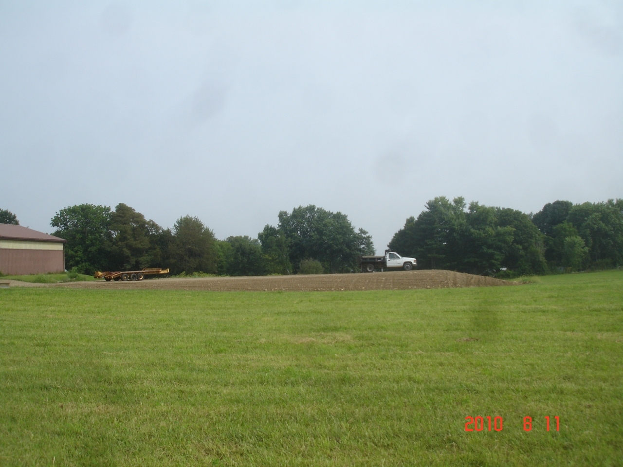

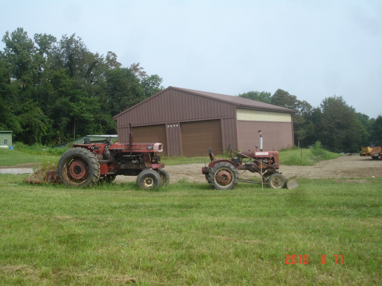

I'd be surprised if you'd wear it out in 10 years. When I had my new horse barn and shop built, I hauled 3500 tons of bank run gravel in for the pads. Hauled it all on the 1 ton Chevy dump truck, leveled it with the Farmall A, and compacted it with the Massey 180 shown with a 3 pt. platform carrier with approx. 1,000 lbs. of bank run I dumped on it for weight.
6 years after that another 1,000 tons of the same material for the new machinery shed I had built hauled with the same truck, leveled with the A and compacted with the Massey in the same manner.
Previous to this I hauled 1600 tons of shaley clay and filled in a pond that my mare went through the ice after walking out on the pond and broke through. My mare survived so decided to fill it in so there wouldn't be another nightmare like that. Neighbor next door was digging out a new very large pond and had thousands of tons of shaley clay to get rid of. He said I could have all I wanted and even let me use his backhoe to load it out. All that hauled on the little dump truck, and leveled with that A with the same piece of pipe that is still on the blade today. That plus all of the snow I've plowed since I put it on in '05 at both places. It does show some wear but far from being worn through.

^ That sounds good. I’ll just make one and I’ll only put the tabs on one side. The Cubs are quite a bit lighter duty than the A’s.
I got to beef up the plow frame, to handle the tongue weight of my boat, when I put the trailer hitch on it. That means I need to minimize the weight of the plow, because too much front end weight is bad for traction on a two wheel drive tractor.

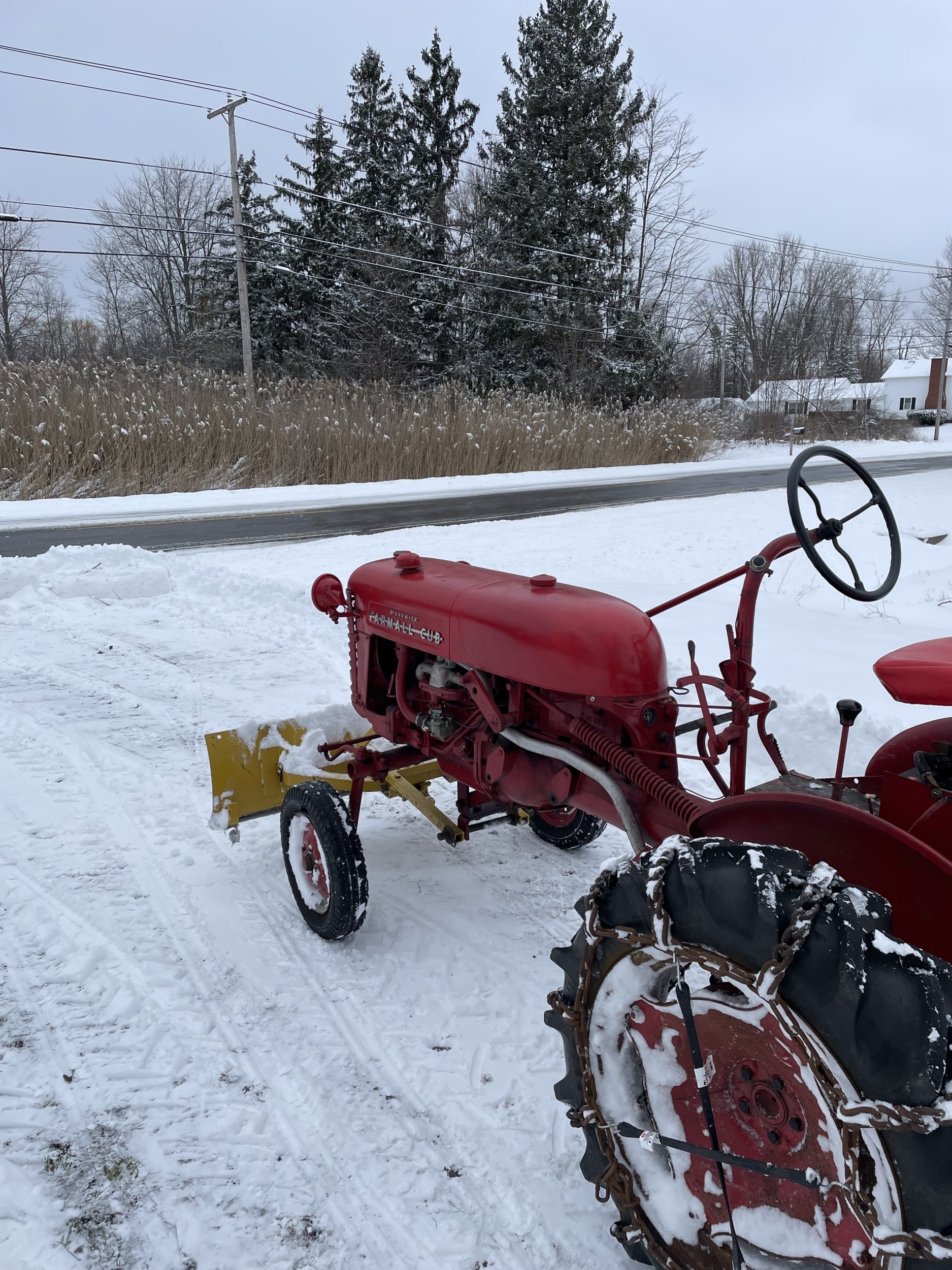

We got a 6” snowfall last night, so I got to use the Cub again. I did our two driveways and our neighbors on each side. The PVC pipe, on the bottom of the plow, stayed on the whole time. I’ve plowed snow with many different rigs, but none were as fun or did better quality work than this one.
I know lots of guys like heated cabs for snow work, but I really like getting out in the fresh, cool, crisp winter air. It was 25 degrees F this morning and I wore insulated bibs and jacket, face mask and wool hat, wool lined mittens, and Mickey Mouse boots. I was very comfortable for over two hours out in the elements, suited up like that.
One of the best things about an open station tractor, especially with the offset “cultivation” Cub, is excellent forward visibility. That makes it very easy to clean right to the edge of the driveways and avoid turf damage on the unfrozen lawns.
I’m guessing that’s going to be our last plowable snow this season, but I’m not taking it off until I see no more sub-freezing temperatures in the long range forecast.
I’m looking forward to reinforcing the plow frame so that it is strong enough to move my boat around with a front mount hitch. I hope to do some April salmon fishing, so I’d like to get it welded up in time for that. It’s easier getting the boat back into position in the barn with a front hitch on a tractor than with the rear one on my truck.
